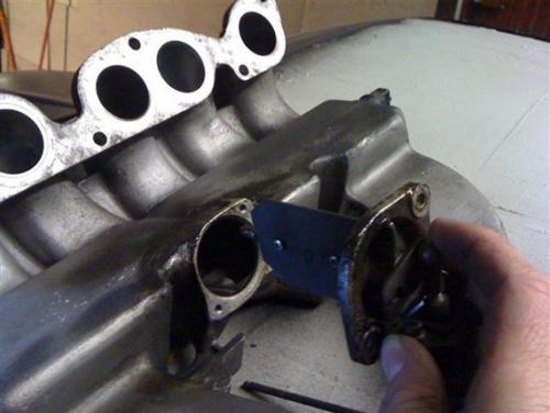

vr6turbo 27 Posted February 1, 2015 Author Report Share Posted February 1, 2015 lots of info great thanksanyone got a picture of the vsr/shrick plenum chamber flap setup Link to post Share on other sites
vr6turbo 27 Posted February 1, 2015 Author Report Share Posted February 1, 2015 considering splitting the manifold in two to create a separation between the 2 banks then having them linked externallywith a flap in between Link to post Share on other sites
vr6turbo 27 Posted February 1, 2015 Author Report Share Posted February 1, 2015 (edited) found a picture of the flapsounds a bit rude Edited February 1, 2015 by vr6turbo VR6Pete 1 Link to post Share on other sites
VR6Pete 1,455 Posted February 1, 2015 Report Share Posted February 1, 2015 Flaps daveyboy 1 Link to post Share on other sites
