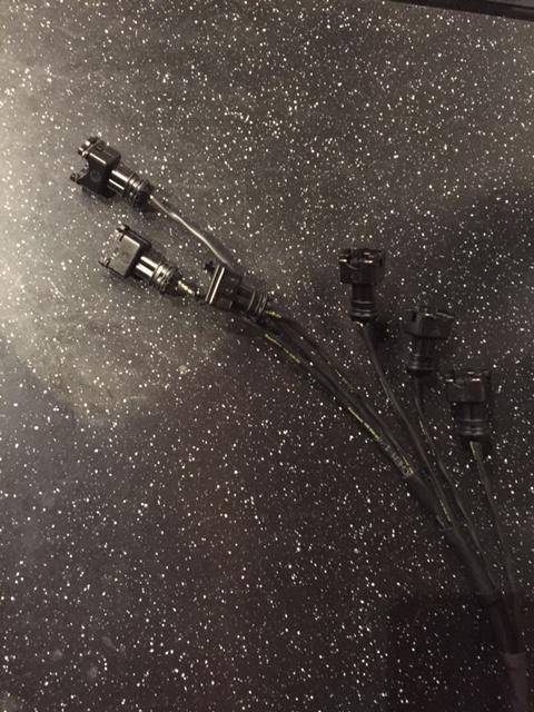

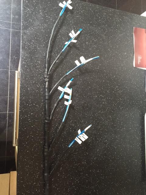

matty.vrt 120 Posted June 30, 2016 Author Report Share Posted June 30, 2016 Made mini looms for injectors and COP's Made using Raychem tefzel wire and DR25 heat shrink. Not the best job ever but it was a learning curve anyways. As long as it works for now I can always spend time later tidying bits up I'm not happy with. VR6Pete 1 Link to post Share on other sites

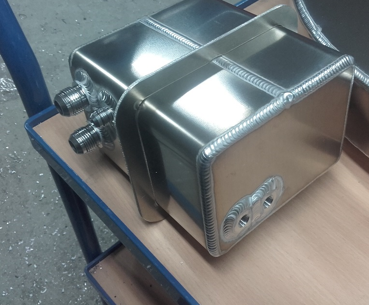

matty.vrt 120 Posted July 3, 2016 Author Report Share Posted July 3, 2016 (edited) Just got some pictures of my fuel swirl pot that will be used to feed my belt driven Aeromotive pump. It will be fitted in the hole that used to be occupied by the standard fan intake. P-motorsports alloy fabrication is second to none, just look at those welds Edited July 4, 2016 by matty.vrt VR6CABBS, RBPE and c00k 3 Link to post Share on other sites
VR6CABBS 1,311 Posted July 4, 2016 Report Share Posted July 4, 2016 Just got some pictures of my fuel swirl pot that will be used to feed my belt driven Aeromotive pump. It will be fitted in the hole that used to be occupied by the standard fan intake. P-motorsports alloy fabrication is second to none, just look at those welds Quality bit of kit pal. Link to post Share on other sites
matty.vrt 120 Posted July 4, 2016 Author Report Share Posted July 4, 2016 Thanks VR6CABBS I needed to mount it in a good location so gravity would push the fuel down to the belt pump to avoid cavitation. VR6CABBS 1 Link to post Share on other sites
