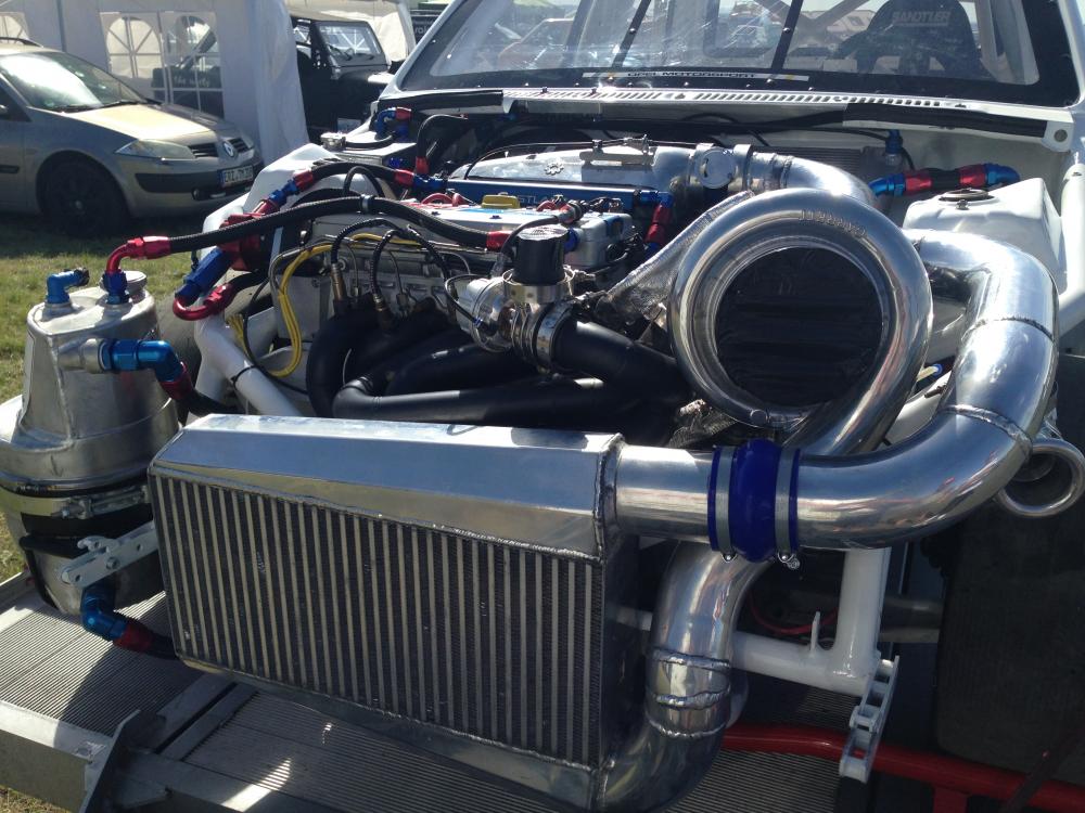

What hp are you aiming for ?
Double check your super tech valves are up to the job !
Hi Kieron,
Aiming for 1000 whp so around 1200 engine. From speaking to people with similar power I should be ok as long as I don't go wild on the cams and start chasing high revs.
Would love to know your experience as you sound concerned.
3 hours ago, matty.vrt said:
Hi Kieron,
Echo "spelling" from FRT put super tech in his and soon removed them after dropping a few Lord Lee Ross had trouble with them stretching I think but from what I understand all the German boys stay on stock valves !
Have you de stroked yours to an r30 ?
And if your goal is 1200hp you need a bigger turbo , and yes I know they are good for 1200hp but not on a r32  .
I have just come back from the king of Germany and when you see the turbos them boys run for 1200hp you would feel embarrassed to show your 42 ??
I'm running R32 crank so will not be revving as high as Ecko and Lee.
If the supertech valves cause any problems then I will just switch to Ferrera. Had them on my old 12v but where just a bit too pricey for me right now with having the whole car to build.
I know the turbo is rated at a touch over 1100bhp but plan to run Nitrous at the same time.
I'm under no impression that my build will be a fit and forget project and will evolve constantly. Already looking at what will go into the next motor that will be on standby.
The only reason I went 42 is I was planning on building a street car that would be a heap of fun at the track but now getting full 8.5 cage and accepting it's going to be be more of a road legal race car.
Would love to take the car to King of Germany next year! That would be a dream come true.
They produce to much torque as a 3.2 I have seen Lee's do 890ftlb at about 900hp !
Its nice to see your not a dreamer and I wish you all the luck with your build, hope to see you at pod doing 8's soon
Thanks,
Spoke to lee and he thinks I will be ok as I'm 4motion. I know what your saying that amount of torque and FWD is not a good combo.
It will be interesting to see how far I can take the R32T.
