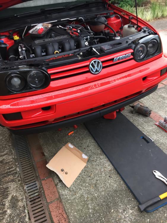

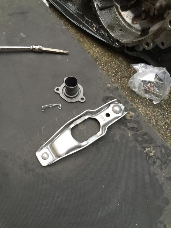

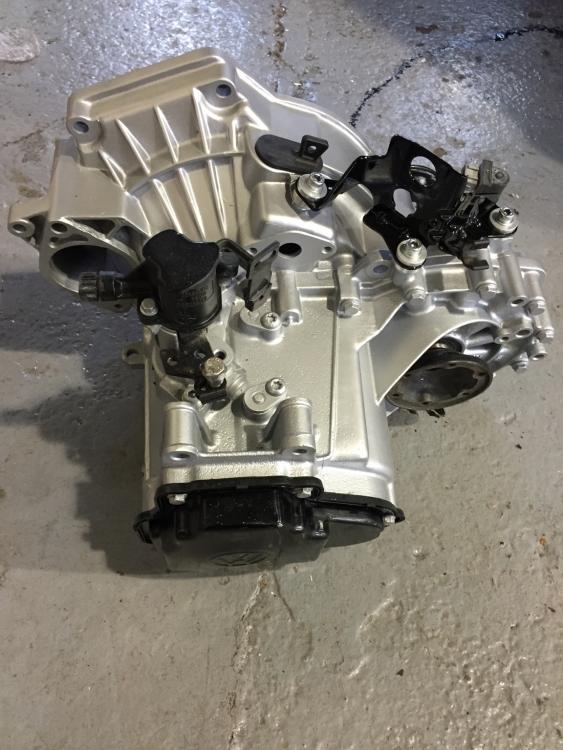

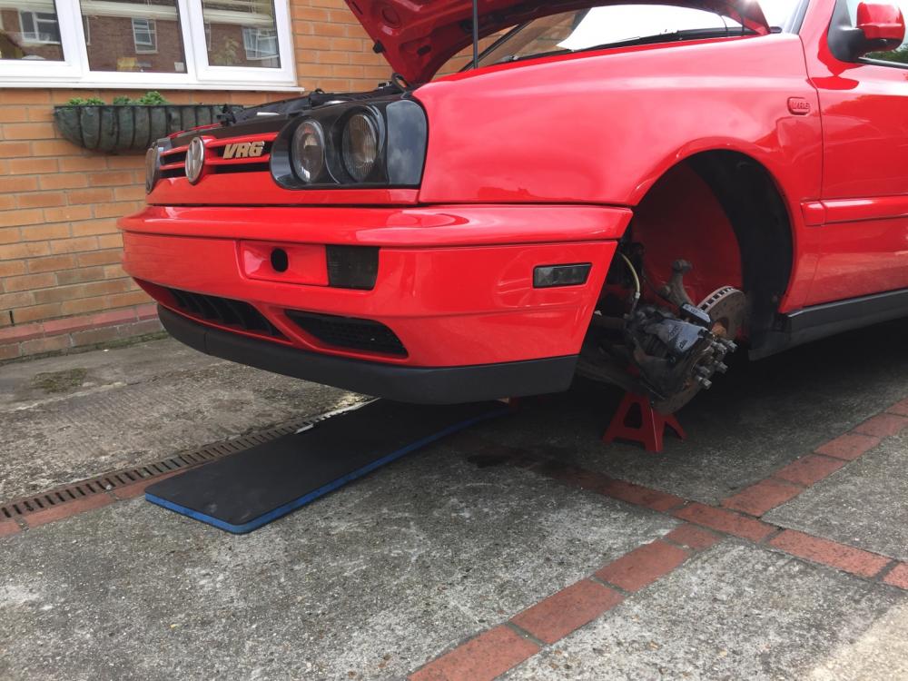

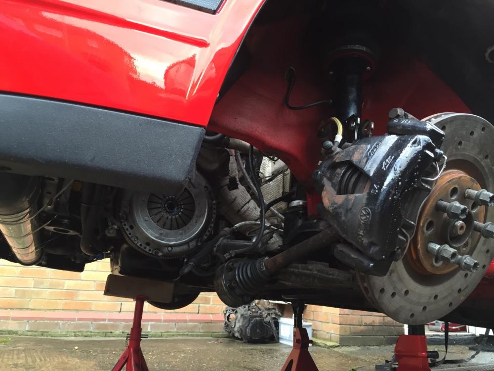

bennyk 1,238 Posted May 29, 2016 Author Report Share Posted May 29, 2016 A little update to this after nearly 3 years of taking it easy on the slightly iffy clutch, one of the reasons I got it so cheap but changing the bushes on the pedal made it a lot better and 2 years of having a gearbox fitted with a Quaife diff lying around in my shed I finally gave in and got a new clutch and the other box into the car. I cleaned painted and changed all of the seals on it a while ago, Then decided to just get it done on the drive as I'd be waiting forever to get a spare ramp at work and I hate being there when I don't have to beSome shiny new parts, Got this one to try to help me but he was as much use as an ashtray on a motorbike when it came to lifting the gearbox back in!! Then after finally getting the box back in for the 2nd time don't ask! On the Saturday afternoon before the VR6oc rolling road day on the Sunday it all worked!! She drove perfectly on the way to Stealth on the Sunday morning, a nice clear A14 on a nice bright morning ; She ran a slightly disappointing 279bhp due to some belt slip, but good to know there's a bit more in her! Was really stoked to pick up Mod's car of the day! So nice to get some recognition for the car after all the hours I've put into it. Especially after originally buying it as a spares or repairs slightly rough old thing from eBay! Thanks guys!! Then today over 2 years of driving the VR and with missus only ever being in the car once since being back on the road after the repaint and me getting it stuck on a slight raised row of cobbles backing out of the inlaws driveway when she did finally come in it! I persuaded her to come with me to the Autofinesse Show & Shine which was conveniently only 10 mins from where we live and in a lovely old pub in a pretty village, I turned up a bit late and because we'd brought the little one with us had to leave early, but as I went to make a move I was asked to wait for 10 minutes and to my and the other halfs surprise (she just doesn't get it!) I'd won something! Which happened to be 1st place!! Won't need to buy any cleaning gear for a while now!! Dave_ciw, VR6CABBS, Bealieboy and 3 others 6 Link to post Share on other sites
