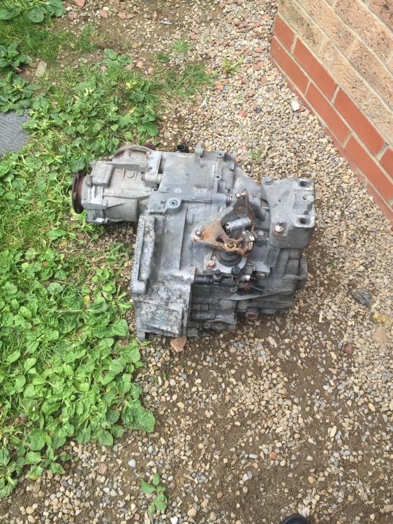

matty.vrt 120 Posted May 28, 2016 Author Report Share Posted May 28, 2016 Speaking of gearboxes, picked this up the other day. It just happened to be the dirtiest gearbox on eBay. This was the result of a quick clean with the jet wash and some de-gunk. The plan is to split it and have it media blasted and powder coated. Link to post Share on other sites
ssaunders 199 Posted May 29, 2016 Report Share Posted May 29, 2016 13 hours ago, matty.vrt said: Speaking of gearboxes, picked this up the other day. It just happened to be the dirtiest gearbox on eBay. This was the result of a quick clean with the jet wash and some de-gunk. The plan is to split it and have it media blasted and powder coated. DRP? got one for my haldex conversion, going to get uprated OEM shift forks 1-2,3-4 have the shaft filled solid and welded and the 4th gear support. Mart (Hotgolf) from the GTi forums will be building it for me. Been looking at these for the diff, well known by ricer crew and Beamer boys http://www.grinspeed.co.uk/product/volkswagen-golf-r32-mk4mk5-02-08-02m-6mt-front-mfactory-helical-lsd/ Link to post Share on other sites
matty.vrt 120 Posted May 29, 2016 Author Report Share Posted May 29, 2016 Yeh it's a DRP. Sounds like your on the right track, what sort of power are you aiming for? I'm going to have a go at building it myself so wish me luck lol. Never herd of them LSD's what sort of power do people put through them? I think I'm going to be sticking with the tried and tested Pelequins or Quafe, I know people putting over 1200bhp through them for years without issue. Link to post Share on other sites

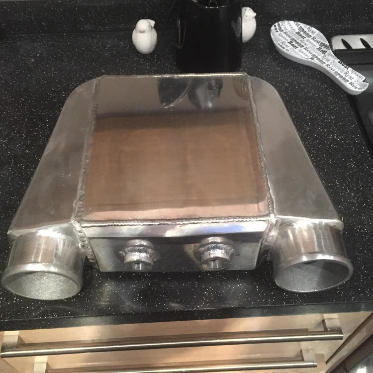

matty.vrt 120 Posted June 3, 2016 Author Report Share Posted June 3, 2016 This came in the post today. 3.5" inlet/outlet should flow enough. Originally planned to go with an air/air intercooler but changed my mind at the last minute, even bought a 1800cfm core. I know lots of people are sceptical over chargecoolers but after lots of research I thought F**k it I will give it a go, guess curiosity got the better of me. The core it's self is a cheap item off eBay with cast end tanks. If it proves it can keep the inlet temps and low I will consider upgrading it for a Precision PT2000 with sheet metal end tanks in the future. Link to post Share on other sites

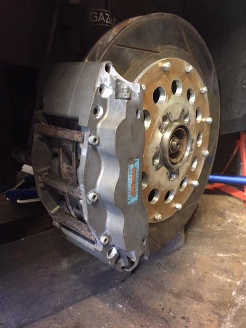

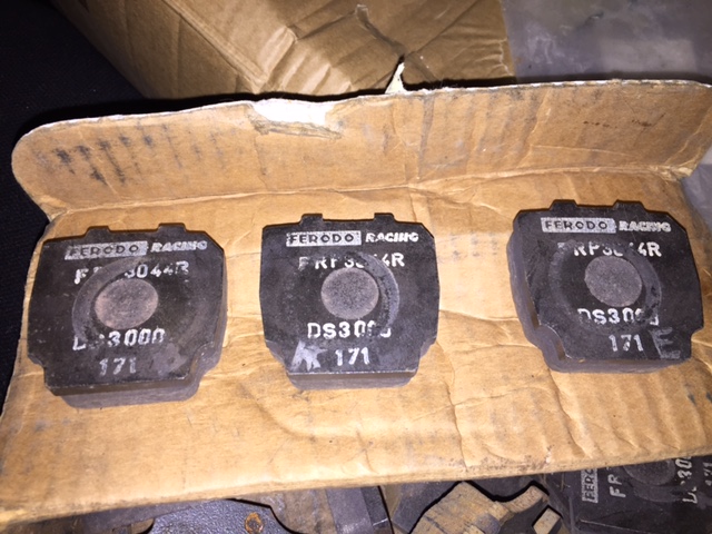

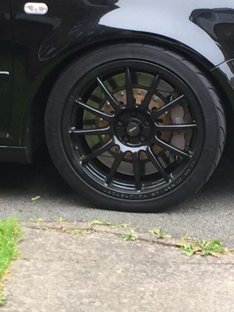

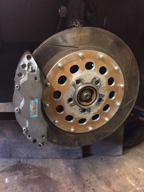

matty.vrt 120 Posted June 8, 2016 Author Report Share Posted June 8, 2016 Fitted these bad boys last night. They don't look like much but they are AP Racing CP5066 calipers with titanium pistons and 378mm x 32mm floating discs (not bells like most floating setups about). I have been speaking to the guys at AP and these are off a Audi Touring Car! The pads are nothing like I have ever seen before; They came with Ferodo DS3000 race pads which was a bonus. After fitting these I have founds they are really street-able, no squealing which was a concern I had as the car is currently my daily driver. Tight squeeze under my 18's I'm glad I picked Pro Race 1.2's for their clearance. The plan is to run them for now and make them look pretty later. I went on a quick test drive to check for noises etc.. and my initial thoughts are WOW!!!! WTF these things are awesome, I have had big brakes before but these are on another level. Even the way the car drives has improved, the steering feels better. One thing I forgot to do was weigh the old setup and compare against the new but it is safe to say these are significantly lighter. I have done a bit of research online and the standard 288mm setup should weigh around 18kg per side (please feel free to correct me if you have weighed the standard setup), The new setup from what I can make out on AP's website should be around 11kg so they are saving a massive 7kg of un-sprung weight per side. D11PS 1 Link to post Share on other sites
al_mooring 102 Posted June 16, 2016 Report Share Posted June 16, 2016 Those brakes are awesome! Fill the wheel out lovely too. matty.vrt 1 Link to post Share on other sites
VR6CABBS 1,311 Posted June 16, 2016 Report Share Posted June 16, 2016 Got a thing for big brakes at the minute and they look awesome mate. What you gonna do with the rears? Link to post Share on other sites
matty.vrt 120 Posted June 16, 2016 Author Report Share Posted June 16, 2016 9 minutes ago, VR6CABBS said: Got a thing for big brakes at the minute and they look awesome mate. What you gonna do with the rears? Not sure yet, either upgrade to 310mm discs with a caliper spacer or might go all out on a custom 330mm AP 4pot setup with brembo hand brake caliper to keep it MOT able. Link to post Share on other sites
VR6CABBS 1,311 Posted June 16, 2016 Report Share Posted June 16, 2016 Sounds like a plan. . What fluid have you used pal? Link to post Share on other sites
matty.vrt 120 Posted June 16, 2016 Author Report Share Posted June 16, 2016 (edited) Pagid RBF 3 hours ago, VR6CABBS said: Sounds like a plan. . What fluid have you used pal? Pagid RBF Edited June 16, 2016 by matty.vrt Link to post Share on other sites

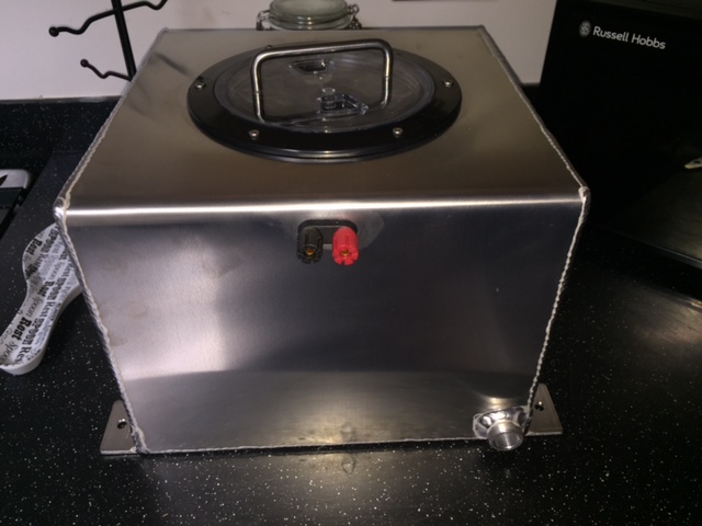

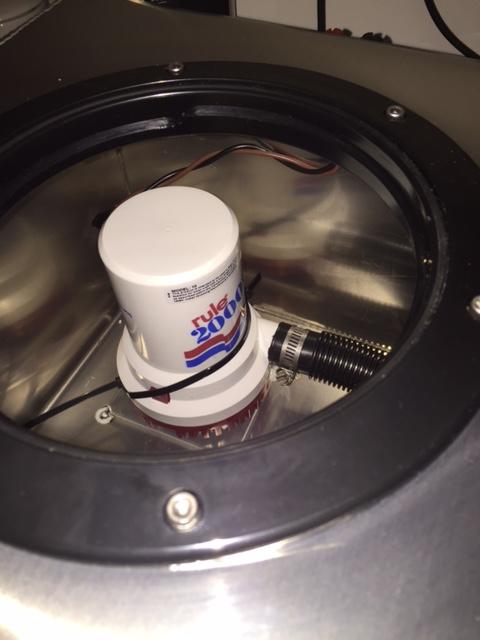

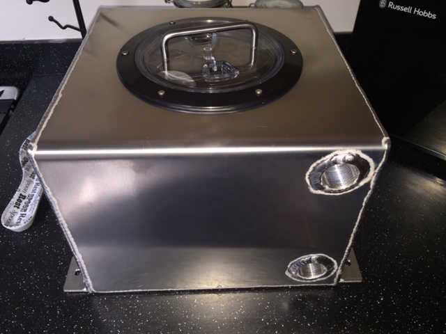

matty.vrt 120 Posted June 30, 2016 Author Report Share Posted June 30, 2016 So more shiny bits arrived today. Chisled Performance Ice/water tank for my chargecooler setup with internal 2000gph pump. Apparently its good for 2000 bhp so should work well for me. VR6Pete and Rolotuning 2 Link to post Share on other sites
