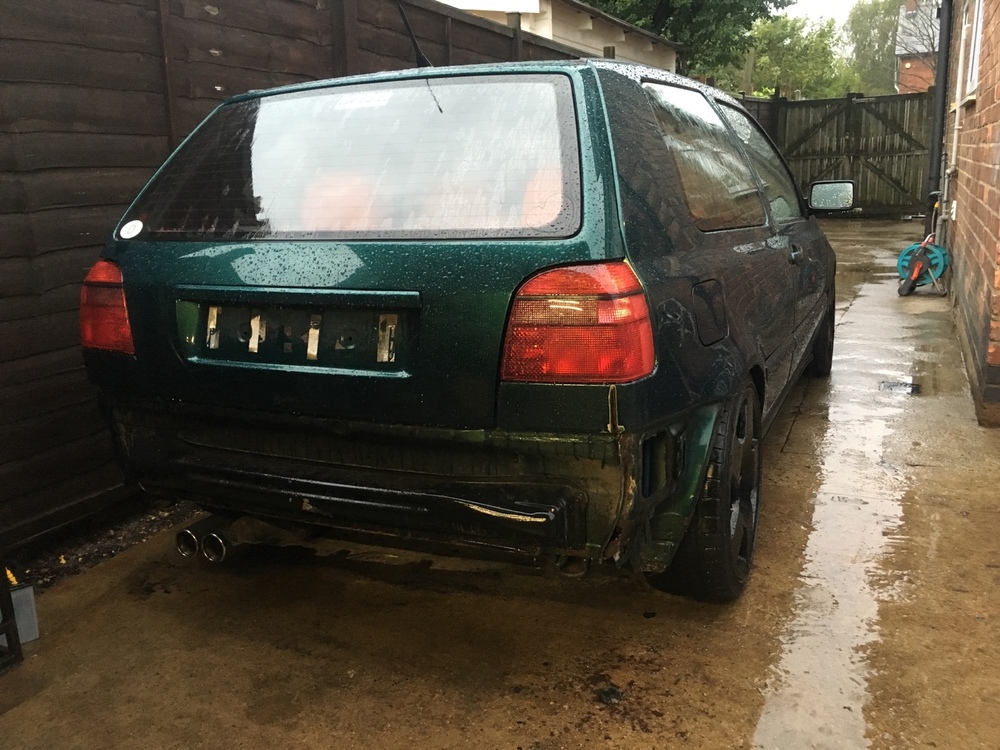

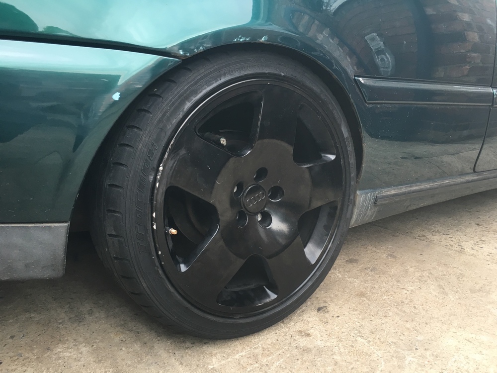

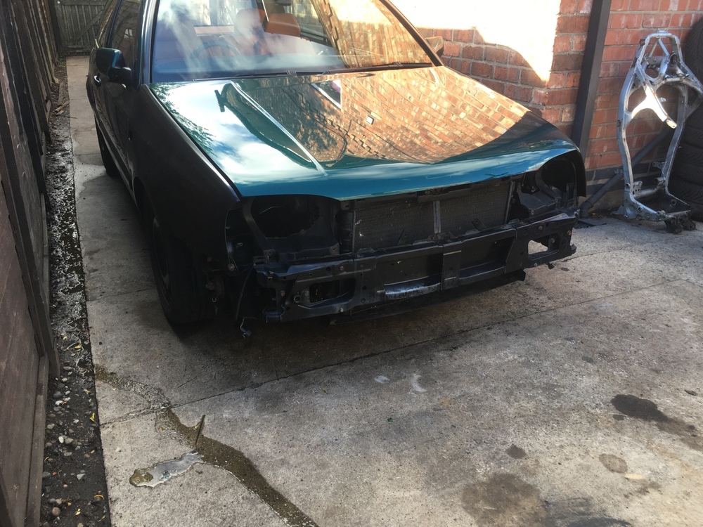

s3dxm 38 Posted August 27, 2016 Author Report Share Posted August 27, 2016 Got myself a cheap set of TT comp wheels that will do me over the winter months. In need of refurb, but all can be done at home, local garage will remove tyres and refit for a box of teabags lol.... Yet again, rain has stopped progress! Rear bumper removed, found a little more welding to tackle.....Next issue is the random cutting out when at idle, checked everything out and looking like a crank sensor issue.....So, do I go genuine or aftermarket?Trip to the breakers soon for more bits too.... Arch liners,Glovebox,Lock set, Never ending this game!!!! bennyk and VR6Pete 2 Link to post Share on other sites

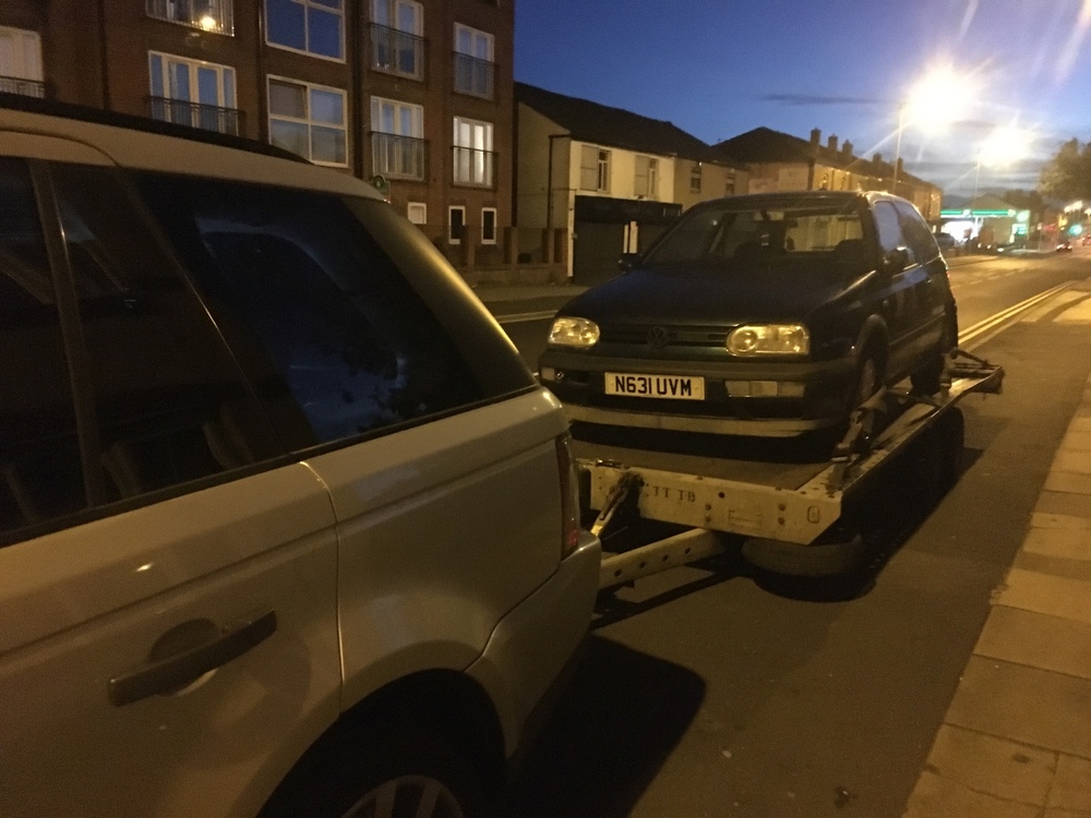

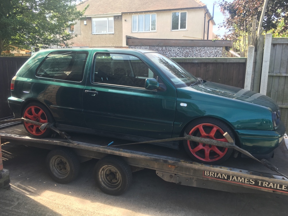

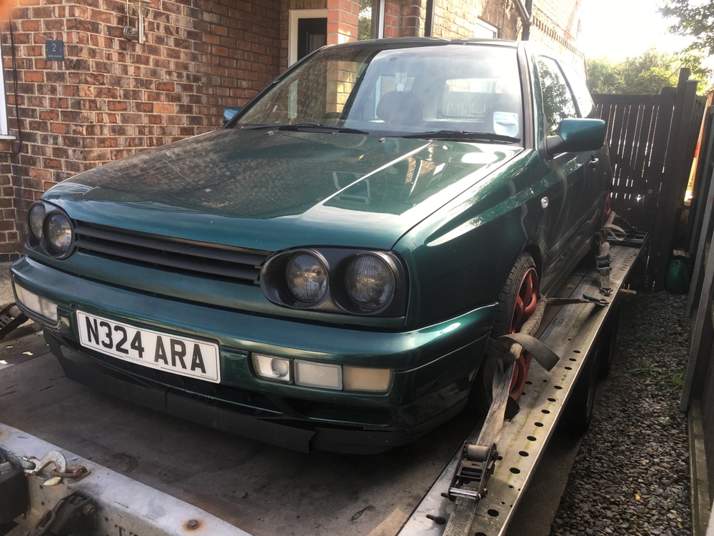

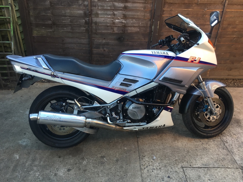

s3dxm 38 Posted September 12, 2016 Author Report Share Posted September 12, 2016 Slow progress on the VR for a few weeks.....Had a an old Yamaha FJ1200 bike to rebuild for the past 2 weeks.... That's all done now and tucked away....Bought a couple of dragon Green 8v GTI's yesterday.One purely for spares.... It's rotten underneath!It all adds up when looking for a lock set, arch liners, bits of trim and odds n soda here and there.... Got the car for £50 and has 4 good wheels/tyres!The other one I bought has some 16" TVR wheels on adaptors. Something a bit different..?Only failed the test in emissions - so that should be easy enough to sort....Also a pair of Morette twin headlights.Decent audio, and other bits n bobs to rob....Plan is to keep all the good bits for the VR, build another good 8v out of them 2...Then sell it on... All 3 out the way down the side of the house...Plenty to keep me busy..... And then finish the VR off ready for paint! Marneus and VR6Pete 2 Link to post Share on other sites
Marneus 78 Posted September 13, 2016 Report Share Posted September 13, 2016 I had my eye on the one with TVR wheels, lots of lovely Dragon Green bits to transfer over.... And the wheels should sell on for a bit of cash. Good work Link to post Share on other sites
c00k 435 Posted September 13, 2016 Report Share Posted September 13, 2016 (edited) Loads of mk3's, should be able to make a very nice VR6 out of all 3 Edited September 13, 2016 by c00k Link to post Share on other sites

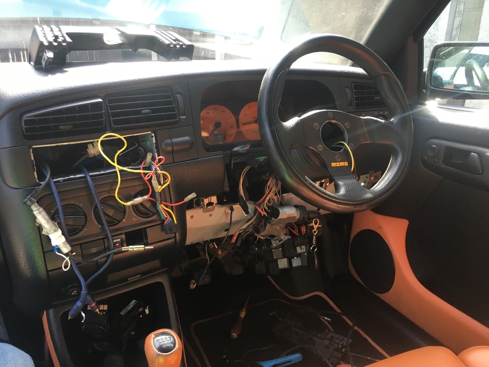

s3dxm 38 Posted September 14, 2016 Author Report Share Posted September 14, 2016 Ignition lock assembly was swapped over last night and that seems to have cured the issues there. Next step is to start stripping the crusty 8V and get it away to the scrap man - need the space really, and keep the missus happy! Most of the interior is all back together in the VR and looking better now. Still need to tackle the rear bit of welding and do the brakes. Fit new crank sensor, Wheels to refurb, list goes on...... Link to post Share on other sites

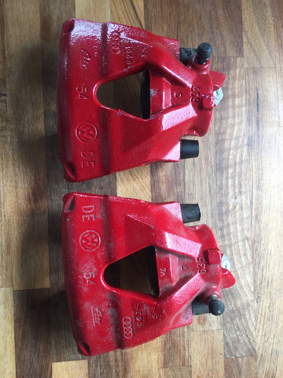

s3dxm 38 Posted September 16, 2016 Author Report Share Posted September 16, 2016 Free goodies arrived today.... Genuine new calipers, might give me a kick up the Arse to get these fitted, along with the new rear units, and the dices and pads.... Started robbing bits from the 2 donor cars so hopefully get some stuff shifted soon too! VR6Pete and Marneus 2 Link to post Share on other sites

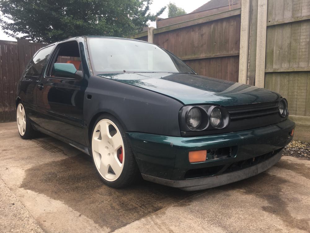

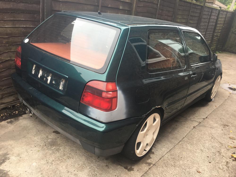

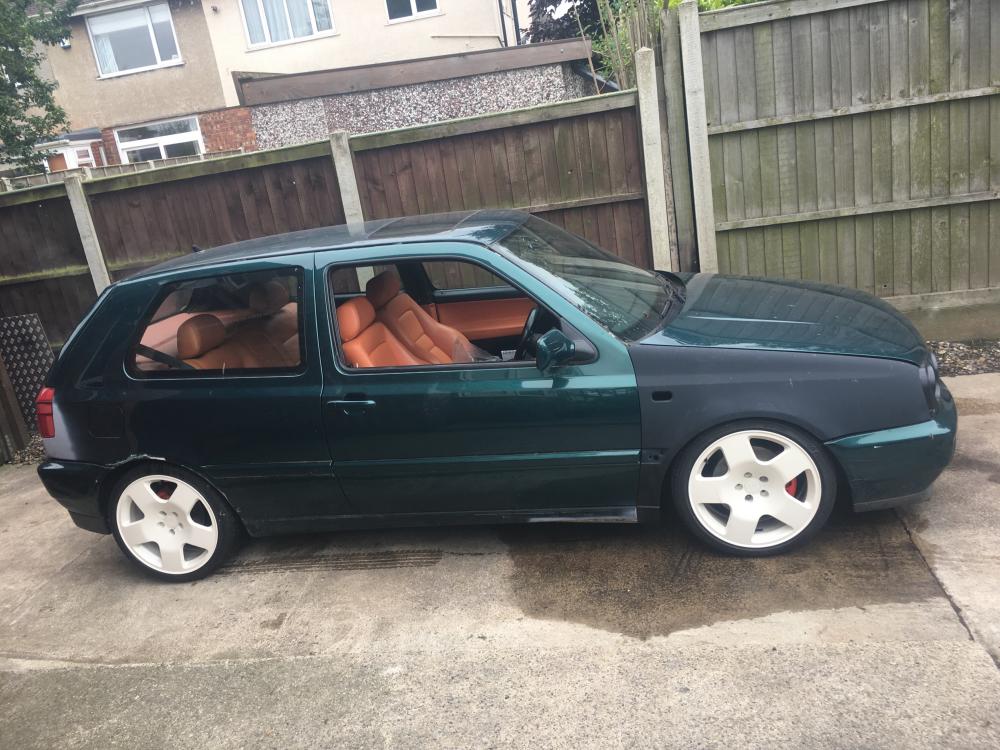

s3dxm 38 Posted June 29, 2017 Author Report Share Posted June 29, 2017 And so the work continues...... Been a while since I was here last....Far too much happening with family life and other stuff... Made an effort to get some more stuff done.... All welding done - stonechip and under seal next.All calipers painted and refitted. Wheels on to see what they look like.Brake pipes to sort next and bleed. Coilovers to fit.Sump to change.Then paint! Undecided if I should stick with Dragon Green or maybe go satin olive drab....? Anyway, this is how she looks today..... matt1986 1 Link to post Share on other sites
dale p 62 Posted August 10, 2017 Report Share Posted August 10, 2017 And so the work continues...... Been a while since I was here last....Far too much happening with family life and other stuff... Made an effort to get some more stuff done.... All welding done - stonechip and under seal next.All calipers painted and refitted. Wheels on to see what they look like.Brake pipes to sort next and bleed. Coilovers to fit.Sump to change.Then paint! Undecided if I should stick with Dragon Green or maybe go satin olive drab....? Anyway, this is how she looks today.....Keep her dragon green Link to post Share on other sites

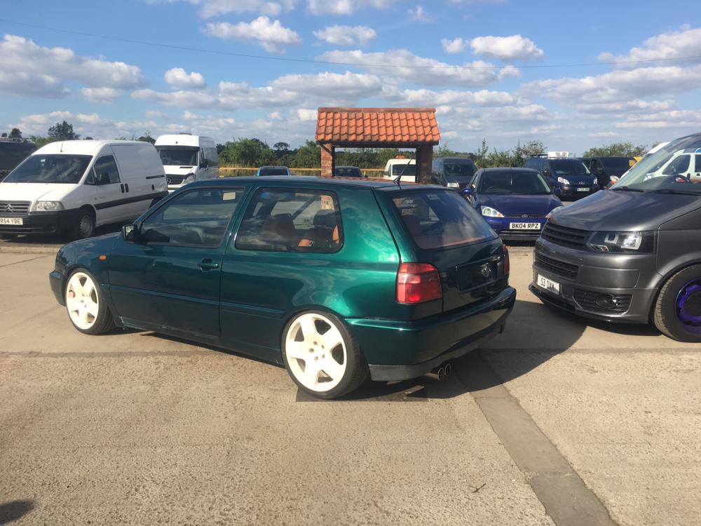

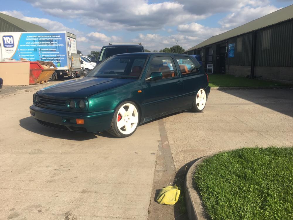

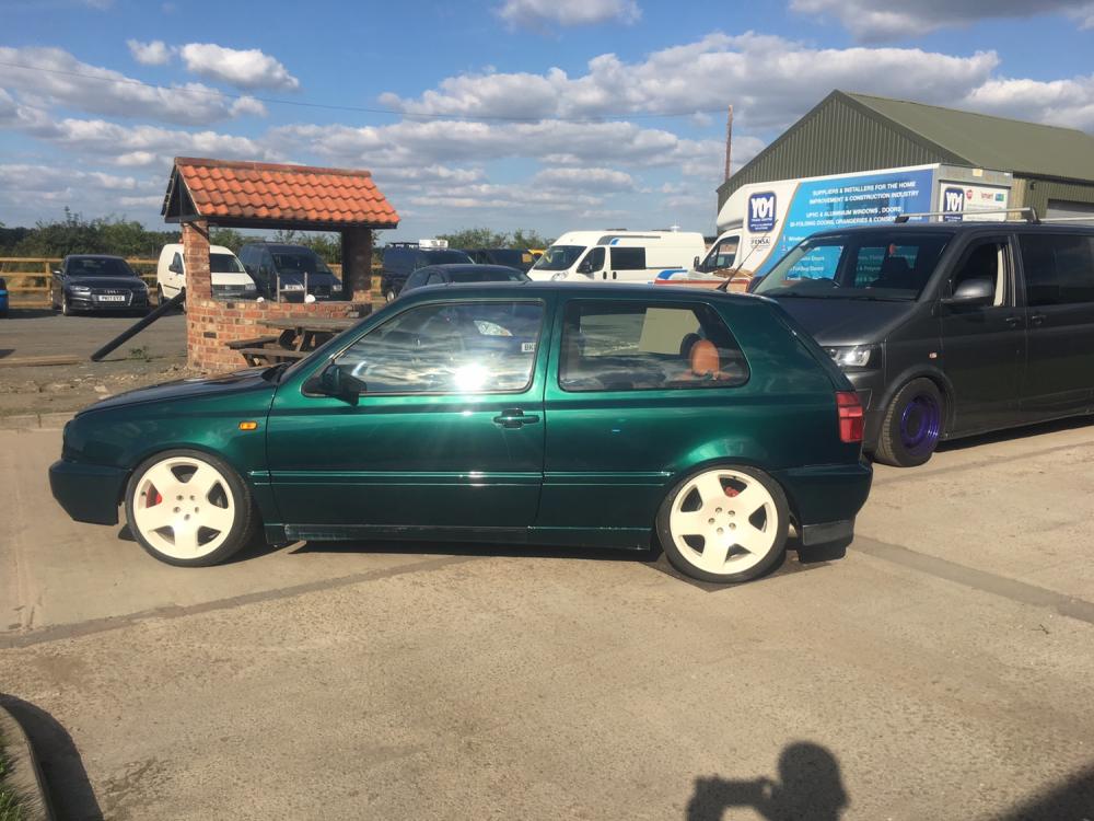

s3dxm 38 Posted August 10, 2017 Author Report Share Posted August 10, 2017 She has stayed dragon green! Just a few bits and pieces to fit to finish her off. Ready for the VW festival tomorrow! Gonna be a late night tonight me thinks! VR6CABBS 1 Link to post Share on other sites
dale p 62 Posted August 10, 2017 Report Share Posted August 10, 2017 She has stayed dragon green! Just a few bits and pieces to fit to finish her off. Ready for the VW festival tomorrow! Gonna be a late night tonight me thinks! You had her painted then Link to post Share on other sites
