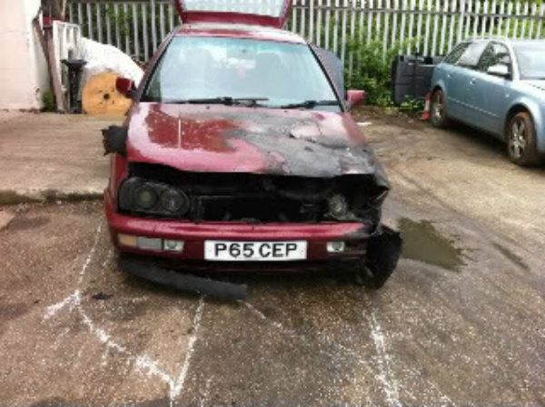

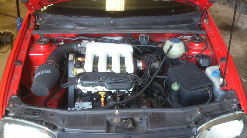

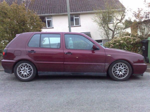

DanChave 98 Posted July 31, 2014 Report Share Posted July 31, 2014 Hi everyone! I had a Chilli Red VR6 OBD2 more door about 7-8 years ago, and I missed it from the day I sold it! I always knew I'd own a VR again, it was just a matter of when First a quick run down of some of the cars I have had in picture format! The VR I sold this to an ex and always planned on buying it back, sadly a spark in the battery ignited an engine bay fire which resulted in this Then I had a Klassic Red more door with a gutless 1.8 8v engine, but I did a lot to it and took it as far it could go while still being a daily, including Porsche Cups, Vento front, colour coded bumpers and trim, leather interior and subtle bodywork smoothing etc. From this To this Next step was a VR6 conversion, but then I found a mint example of a Flash Red three door GTI 16V, and this is where things start getting complicated lol The 16V Which I did quite a fair bit to, particularly the engine bay Anyways, the next update I'll get to the VR6 conversion, which is nearly complete bennyk and redvr6_girl 2 Link to post Share on other sites

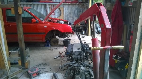

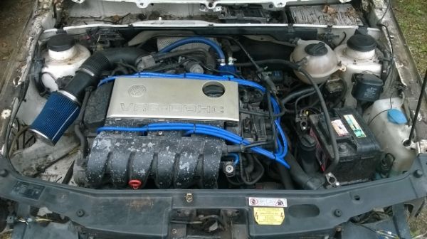

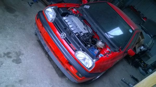

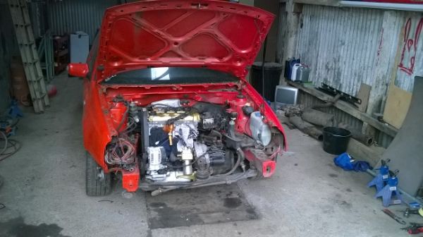

DanChave 98 Posted August 1, 2014 Author Report Share Posted August 1, 2014 And finally onto the VR conversion I bought a donor so I had everything, and cracked on with it as soon as I had the time and space at the workshop The engine bay started like this: Then this: Then this: Stripped the thing down and got the engine out! Looms out! Link to post Share on other sites

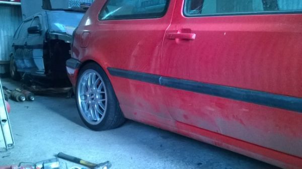

DanChave 98 Posted August 1, 2014 Author Report Share Posted August 1, 2014 Got the GTI in: Engine and loom out and completely stripped: Cleaned up! Started refitting everything Refurbed front subframe, wishbones and rear beam with polybushes, new bearings, track rod ends, bottom ball joints, ARB drop links, drilled and grooved discs and fast road pads and refurbed calipers with new flexi hoses, static copper brakelines and ABS deleted. I also fitted my FK coilovers Then I bought some new wheels, BBS RX228 with 205/40 P Zero's! Engine in. Manifold cleaned up and front end fitted Wheels fitted and back down on the ground: Fitted my Vento front end and lowered the front 20mm: And that's me up to date! I'm currently waiting on a set of Red 7mm HT leads, lead guides and coilpack cover, a black silicone hose kit with stainless clips and a 70 degree thermostat to turn up, and then I can get the thing running thesurgeon, Bealieboy, redvr6_girl and 1 other 4 Link to post Share on other sites

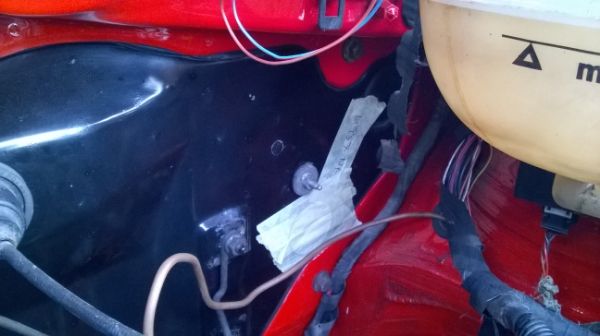

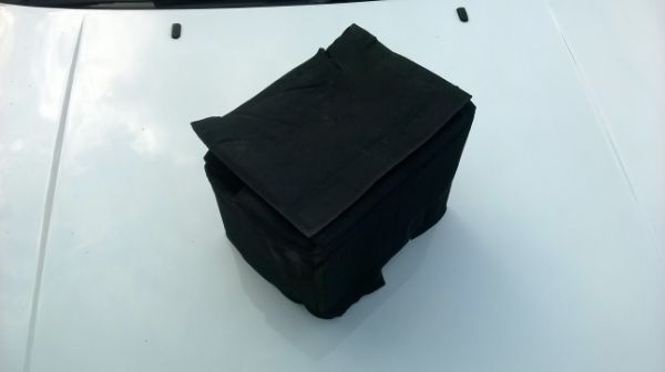

DanChave 98 Posted August 6, 2014 Author Report Share Posted August 6, 2014 More bits turned up today, so I got them fitted OEM battery cover Engine cover, lead guides and coilpack cover Fitted Bulkhead bungs OEM smoked repeaters to replace the aftermarket clears My wind deflectors turned up, but the guy I bough them off didn't realise he had bought MK5 ones by accident :/ so they are going back. Parts I'm still waiting for are:Aux BeltLonglife CoolantBrake Fluid7mm Red HT Leads70 Deg ThermostatSilicone Hose KitPowersteering FluidARB to wishbone bolts x2Ball joint Bolts x6Ball joint captive nuts x22.5 inch stainless steel exhaust clampsHT lead guides and coilpack coverOEM GTI side repeatersWind deflectorsOEM battery cover To Do list before MOT:Replace windscreenPaint roofFit coolant hoses and bleed systemfit interiorcomplete checks to make sure everything works Link to post Share on other sites

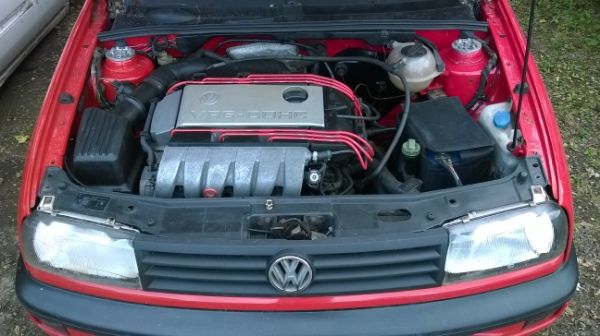

DanChave 98 Posted August 7, 2014 Author Report Share Posted August 7, 2014 Still waiting on the Silicone hoses, so just a quick before and after of the engine bay Before: After: VR6Pete, D11PS, bennyk and 1 other 4 Link to post Share on other sites
Therusterman 59 Posted August 7, 2014 Report Share Posted August 7, 2014 Looking very smart Dan, nice and o.e! Are they BBS RX's your running? Complement the lines of a mk3 very well. Link to post Share on other sites
