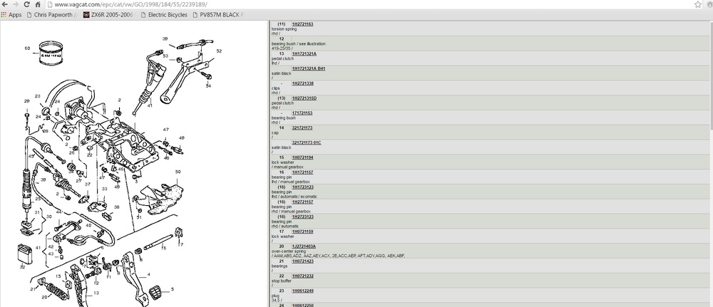

  4. Hi Rob,
    I bought off you before...I need the small white plastic mount that sits behind the over centre clutch spring in the pedal box. You have one? Part number 21 in the pic. Cheers. Chris
    1. pappers
      pappers
      Its ok man I bought one from dealer, £1.80. No sweat,
