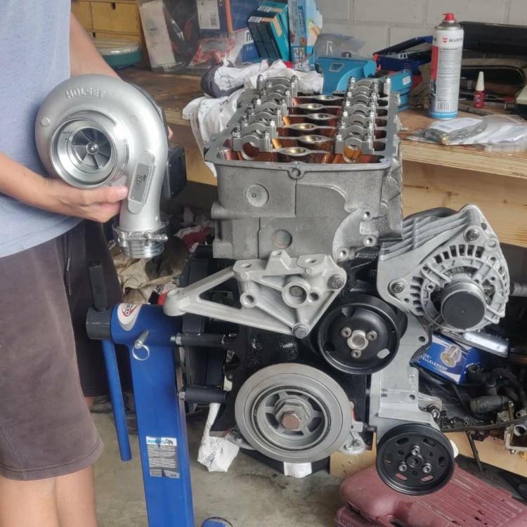

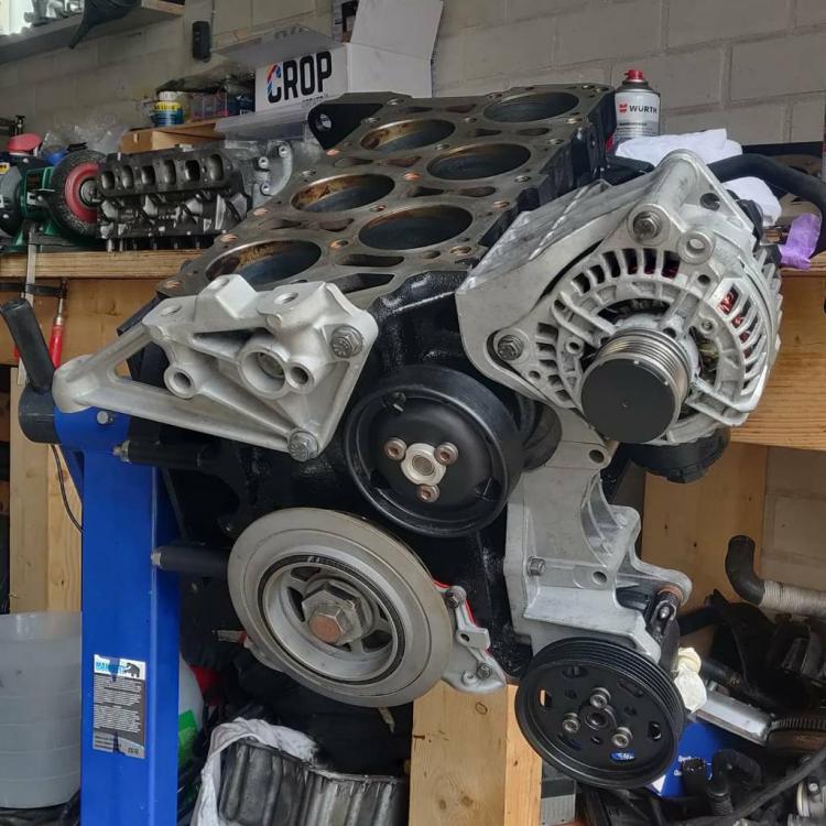

wessel429 4 Posted August 21, 2020 Author Report Share Posted August 21, 2020 Exhaust manifold fitted, entire head dissasembled flattened and valve seat ground in head reassembled Dogma 1 Quote Link to post Share on other sites

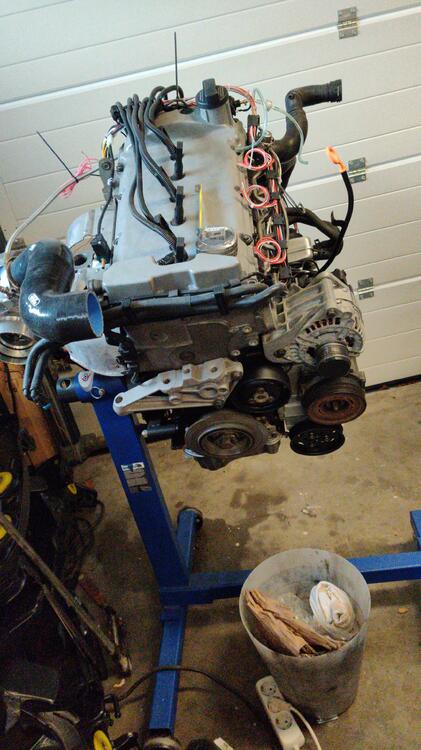

wessel429 4 Posted November 18, 2020 Author Report Share Posted November 18, 2020 (edited) Busy on the build, still waiting on more parts, but finished the ecu assembly and working on wiring now VID_20201107_165124.mp4 Edited November 18, 2020 by wessel429 Quote Link to post Share on other sites
