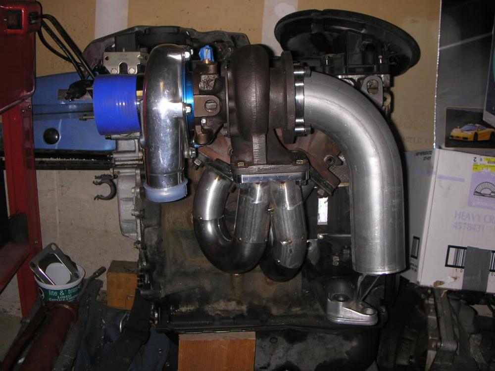

You'd be surprised what you can fit in an old Rocco bay;
