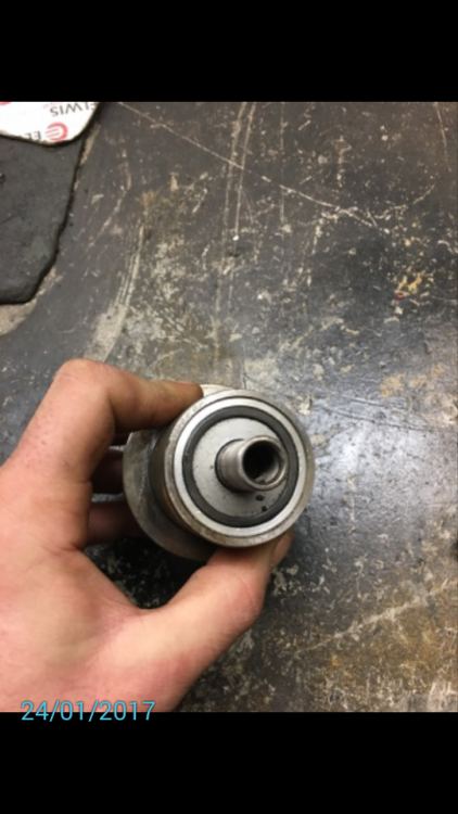

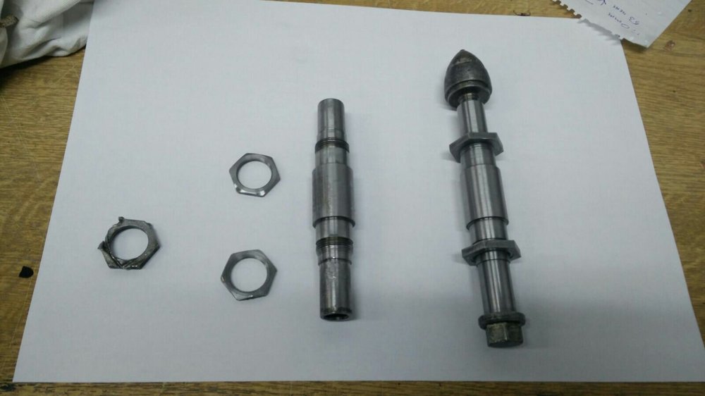

boab3 164 Posted March 2, 2017 Author Report Share Posted March 2, 2017 Well im in a situation now found where my oil leak was coming from.the main shaft bearings have a retaining nut either side one had slackened off causing the nut to tear the shaft seal.at least it's been found early with minimal damage as its only damaged a seal.now i have to find a seal thats going to withstand heat,speed and retain the oil in the charger but also clear the nut that rotates on the main shaft.im looking at viton seals there ideal for heat and rotating.time for some head scratching now.hopefully update this with a solution soon VR6Pete 1 Link to post Share on other sites
boab3 164 Posted March 6, 2017 Author Report Share Posted March 6, 2017 Well the nut has damaged the thread so ill get a new shaft machined up only couple of steps in shaft for bearings 2 for seals and last 2 for impeller and pulley threads for locking on bearings and threads either end for pulley and impeller bolts overall diameter of shafts only 20mm overall length 110mm.might even manage to customise the shaft to suit new seals.will update soon VR6Pete 1 Link to post Share on other sites
boab3 164 Posted March 8, 2017 Author Report Share Posted March 8, 2017 One old shaft and hey presto one new shaft on our way now VR6Pete 1 Link to post Share on other sites

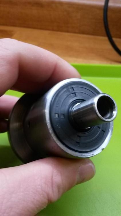

wisby 6 Posted March 8, 2017 Report Share Posted March 8, 2017 I'm making progress I have now got new seals different from the old ones but newer technology. Rob Link to post Share on other sites
boab3 164 Posted March 8, 2017 Author Report Share Posted March 8, 2017 They look a great fit.what are they? Link to post Share on other sites

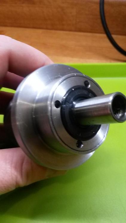

wisby 6 Posted March 8, 2017 Report Share Posted March 8, 2017 They are high speed high temp double lipped seals. I had them matched to the old ones. The end with the four holes had to be machined out very slightly and went slightly bigger than the original on the other end and done away with the collar that the old one sat and just pressed the seal in on its own. Link to post Share on other sites
boab3 164 Posted March 8, 2017 Author Report Share Posted March 8, 2017 Why do you have 4 holes in that end?that looks like the impeller end Link to post Share on other sites
wisby 6 Posted March 8, 2017 Report Share Posted March 8, 2017 They are high speed high temp double lipped seals. I had them matched to the old ones. The end with the four holes had to be machined out very slightly and went slightly bigger than the original on the other end and done away with the collar that the old one sat and just pressed the seal in on its own. boab3 1 Link to post Share on other sites
wisby 6 Posted March 8, 2017 Report Share Posted March 8, 2017 2 minutes ago, boab3 said: Why do you have 4 holes in that end?that looks like the impeller end There for the tool to unwind it. Like a pin spanner. Then just undo it as it's threaded and screws into the casing. If that makes sense. Link to post Share on other sites
boab3 164 Posted March 8, 2017 Author Report Share Posted March 8, 2017 Ahh and your sealed below that collar aswell? Link to post Share on other sites
wisby 6 Posted March 8, 2017 Report Share Posted March 8, 2017 boab3 1 Link to post Share on other sites
boab3 164 Posted March 8, 2017 Author Report Share Posted March 8, 2017 Ahh i thought they were holed fully through wisby 1 Link to post Share on other sites
