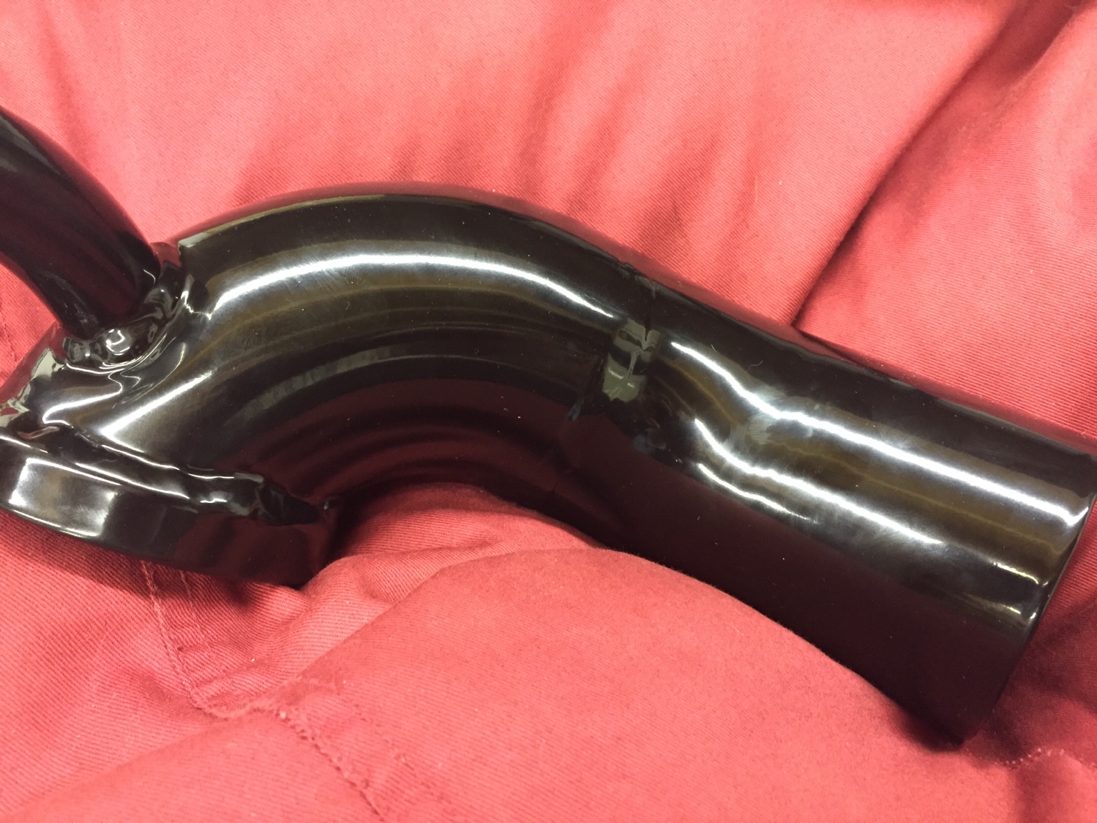

VR6Pete 1,455 Posted September 14, 2015 Author Report Share Posted September 14, 2015 So, got part of the intake backBefore (sorry crap photo):After:Looking swish!Also now I know how the belt should be installed for dual idler pulley:This is quite important as I still don't know what length belt I need D11PS and Dave_ciw 2 Link to post Share on other sites
