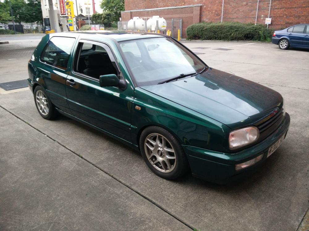

Hi all,
Just got my car back from body shop, put it through an mot yesterday and it failed on rear (both sides) brake pipes. Now, is there somewhere in leeds that can do full length of car (braided hoses) then build it up with ends and crimps or is there somewhere pre-made in leeds that sells them (if full length can be done?) Or shall i go to ebay n snap up some Goodridge uprated ones for the back end?
Need to be quick so i can get it in for re test ?
Thank you ?
