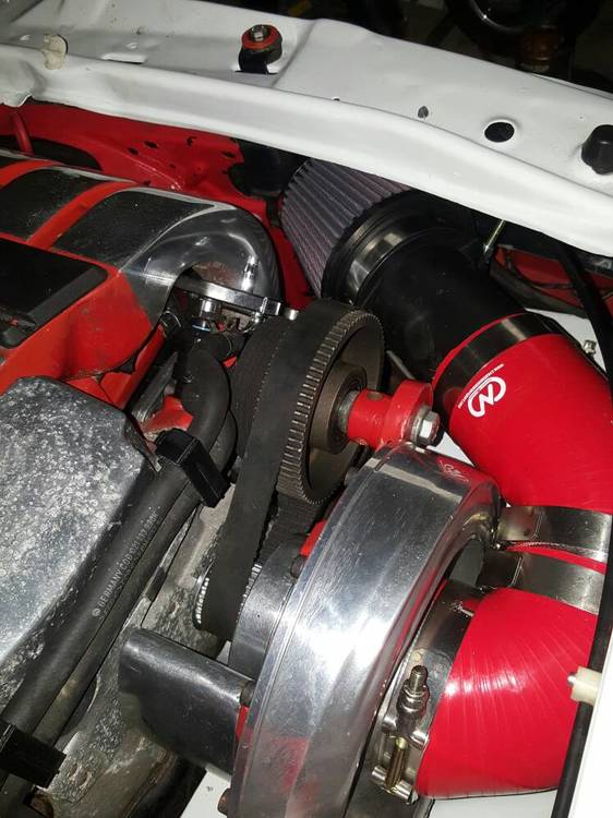

Not mine but exactly the same charger.
as my outlet of the snail housing is slightly off to where i would like it to be would anyone know if id have any problems moving snail housing round half a hole as in picture the housing has more holes than required so i want to rotate housing only to the next hole back.i can't see there being a problem but any advice appreciated

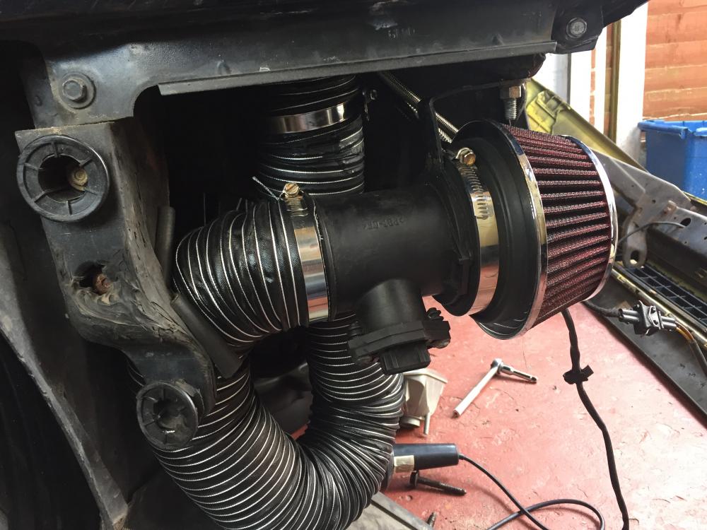

Oil catch can to source squeeze in maf and filter somewhere.had to take oil bath off had nipped o ring when fitted so new o rings all leak free now
Theres not much room anywhere with a charger on ? Good bye knuckles.
this is where I keep mine
Theres not much room anywhere with a charger on Good bye knuckles.
Thats a long inlet pipe before charger.is there a set distance the maf should be away from the turbulence from the impeller
Minimum 18" on vortech. May not be as bad on the z engineering mine. The key was to get an "s" shape could have got smaller length in but certainly doesn't hurt..: unless you drive through flood water ? Then it sucks like a dyson V6 haha so think ahead with position.

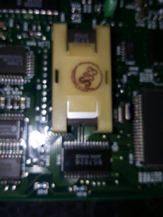

Im wondering if lambda would affect the idling as i did have a few niggles previously and my april mot last year just made it on its emissions the co was at maximum limit so i think its maybe now with bigger injectors new chip and a faulty lambda its chucking a lot of fuel in there.
