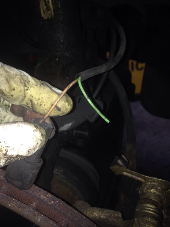

Well here is my black VR mk3 that i bought the other day..  was advertised for a grand n i spoke to the ladselling it n he told meit needed a little "TLC" .. after 10 years of spinning spanners i still dont learn n thought id have a look ..  agreed a price n fetched it .. on the way backi soon realised the temp guage didnt rise above 70 ...  plus a blow out on one ofhis "sick new tyres" was fun in the dark with the missus aswell...  then came the siezed caliper ..  the coolant leak ...  n on n on n on ...  so i thought f*ckit i havent the time to fix it as i gave my unit up n didnt think it needed that much.. but my mate said i can stick it in his unit n save her SO ...Oh n the gearbox that just wanted a top up of oil " that crunches into 2nd " lol ..  so the old girl wants a box aswell...  as i havent got the time to stripit down n replace the warn syncro .. but ive started today n found so many more  bodges ..  brakes ..  n general sh*t mechanics....  makeyou ask yourself why people dont just do a job once n do it properly..  but hey ho least shell be a good un for a bit ...  its took a bit of a bad one on the sill where some1 jacked it up poorly but that gonna go on the list...  if she stays long enough i might take it with me when i move house n stick it in the garage n strap a blower to it ...  ( maybe)
Here is todays odds n sods ..  ill take some more tomorrow

as you can see an interesting day...  after  i discoverd that cv's bootswere split n clips broke n ball joints were siezed n all sorts i thought id jsut bite the bullet so ive ordered about 200 quids worth of bits including a second hand box that has aaperntlydone "88k" ..  more like 188k but ill change the oil n hope for the best ..  sometimes i wish i wasnt a mechanic n i jsut stuck my car in a garage n dealt with the bills ...  but i guess no point in having a skill so to speak n not using it ...

still not back on its wheels but not that far away now.. hopefully tomorrow she'll be back on its wheels..  problem is now ..  its had a whack in the floor n got a few rottern patches in the sills BUT the mot was only done on the 11th of december ..  so gonna be calling the garage tomorrow...
