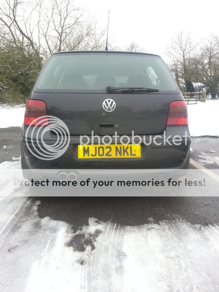

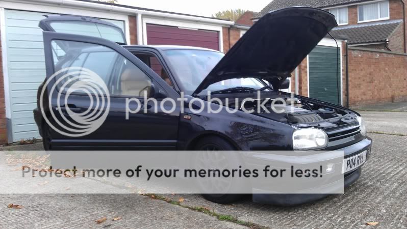

After much thought the vr is no more. After getting it resprayed last year I came to the decision that doing 12thousand miles a year in a 15 year old car was far from practical. I was so paranoid about rust I was jet washing it 2/3 times a week during the last snowy period. Here's a pic anyway

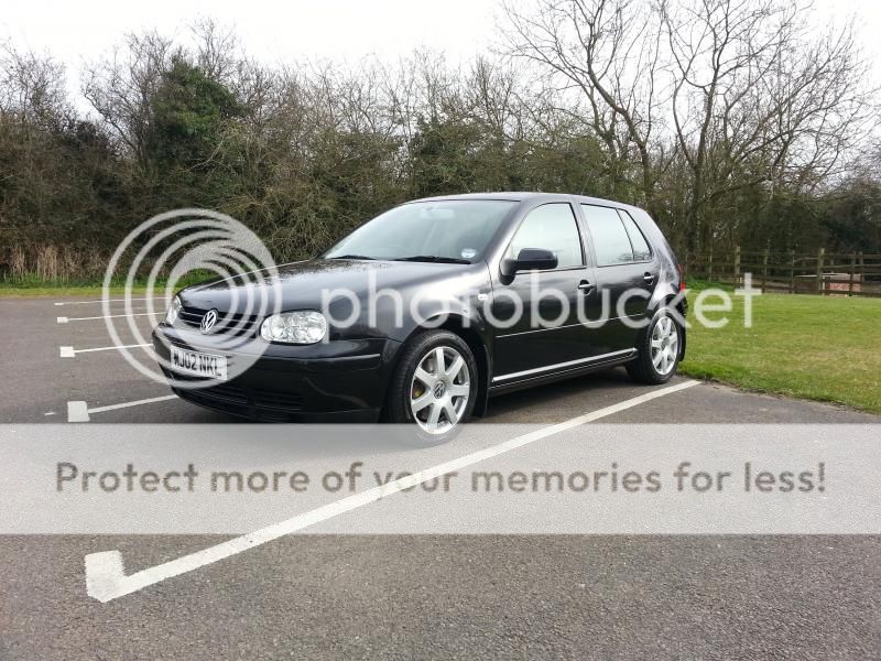

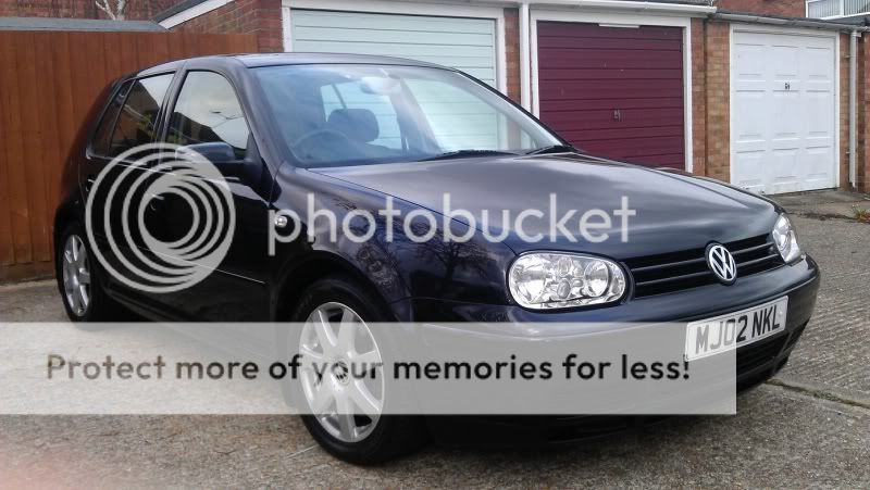

So I recently came to the decision I needed something newer and it was between a 02/03 plate wrx or a 4mo. The scooby's were nice but didn't see them as much of a challenge and too shouty to look at so I went and picked this up today with 60k on the clock :-d
Heard this mod adds atleast 10hp
Took the 4mo and v6 badges off as I like the idea of it looking like a sensible 5 door mk4. Have to admit it doesn't sound as raw as the mk3 but can't wait to start unlocking the bags of potential this car has. Got a good idea of what direction I want to take this car in. If i can stop it from looking like a lot of modified mk4's I see kicking around my way (you know the ones) I know im on the right track.

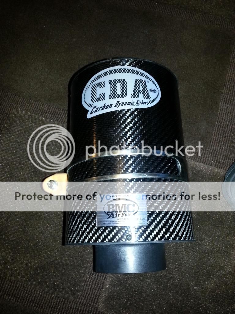

Just finished my apprenticeship now and have more money now, so I'm starting to buy things. Picked up a bmc this week to kick things off!

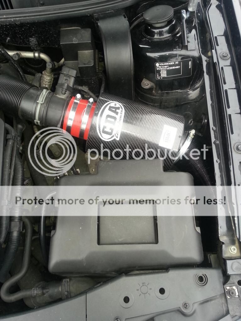

Got this fitted now but still need to figure out what to do with the cold air feed as it doesn't quite fit with the bmc in place.

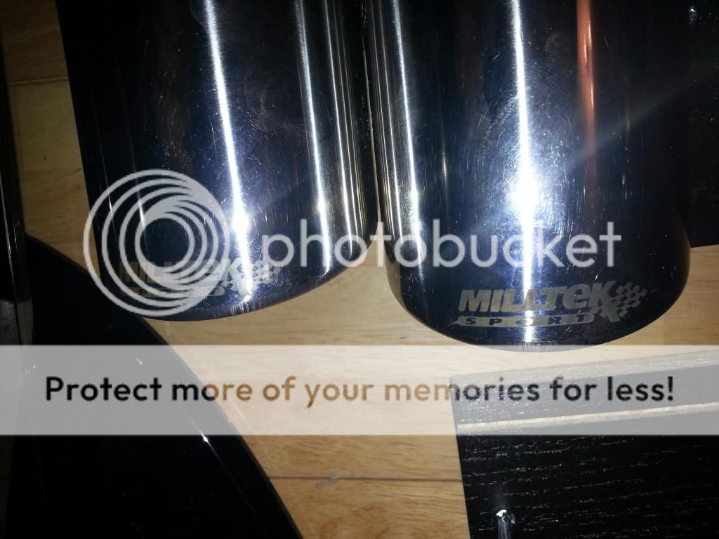

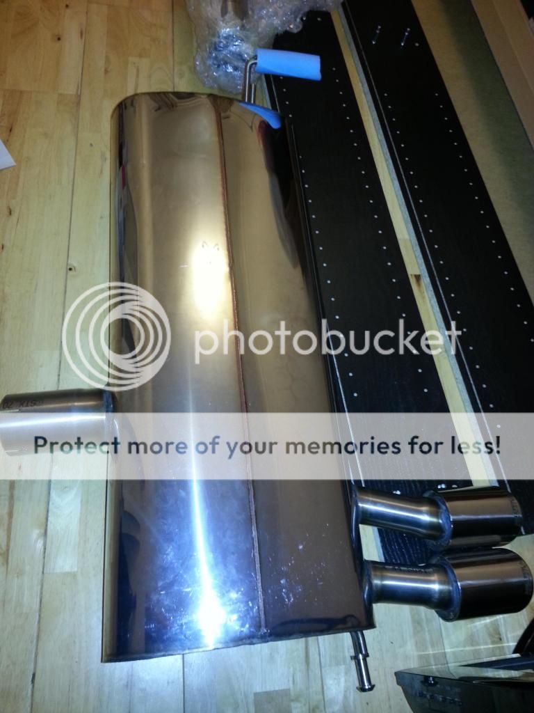

Picked up a milltek non res cat back today. Wasn't keen on the custom exhaust I had made so decided to go with the milltek option.

Couple pictures of the bmc and milltek in place. Managed to squeeze the cold air feed in to where the old snorkel was fitted by the headlight.
Decat was fabricated and fitted on Wednesday so its now a full stainless system from the exhaust manifold onwards.

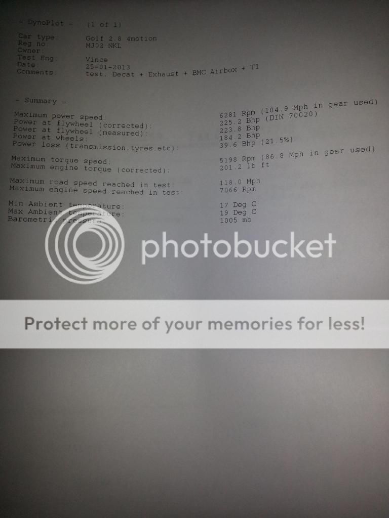

Just got back from stealth today after getting a remap. Vince cleared the fault for the decat and also raised the limiter to 7100rpm.
After a handful of runs and some tweaking, the car saw 225bhp at the flywheel. Vince also ironed out a flat spot that came in at the top end.

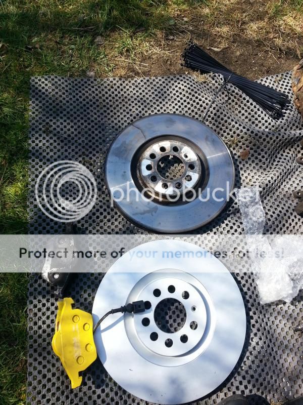

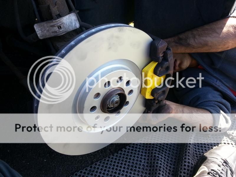

Seeing as all my discs and pads were shot...I took advantage of the nice weather today and went ahead and fitted new discs and pads all round. I went for pagid discs with "yellowstuff" pads. I was looking at big brake kit options but would rather spend the money on other bits for the time being as I don't intend on tracking the car or anything. Doing a brake fluid change tomorrow and fitting o.e.m spark plugs I bought a few weeks back.
Still waiting on the call for when my new wheels are ready so I can crack on with fitting them and finally put the weitec's on.
Done a brake fluid change today and put new spark plugs in as the last set had done 38k according to the service book. Given it a clean and polish as well. Not a bad weekend's work.

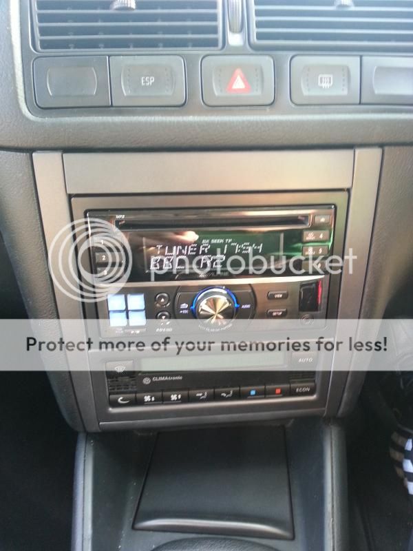

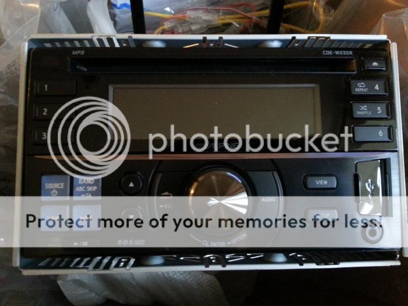

Payday treat! Been wanting a double din stereo for a while so picked up this Alpine today. Square buttons...very nineties interior :-d .
Anyone got any tips to remove the c.d changer in the mk4's? Haven't had a good look yet.

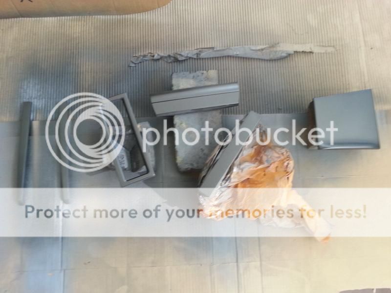

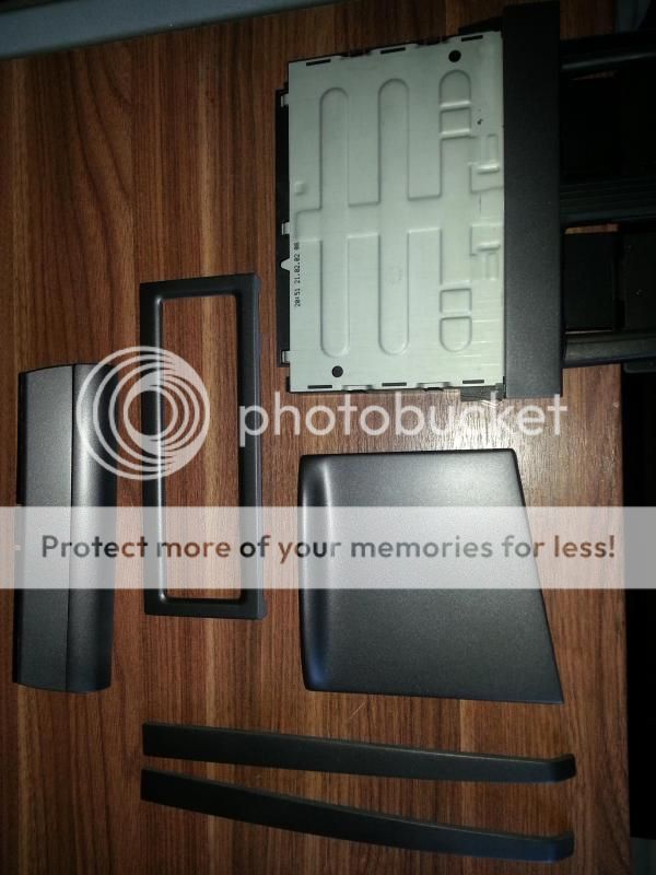

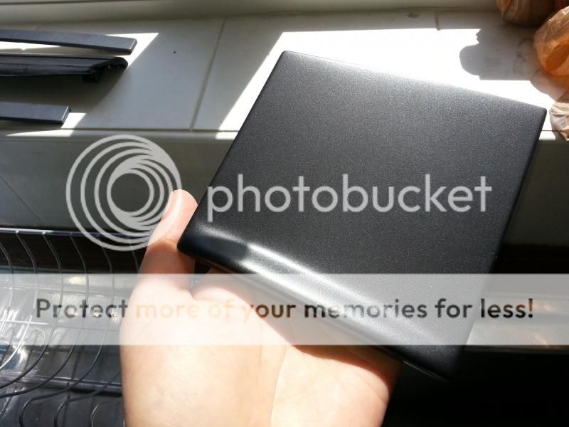

Double din fitted, and spent the past week painting the wooden centre trim in BMW graphite grey with a satin lacquer.
Still need to do the handles and will give the gearknob a try but will probably get an R-Line gearknob if it doesn't work.

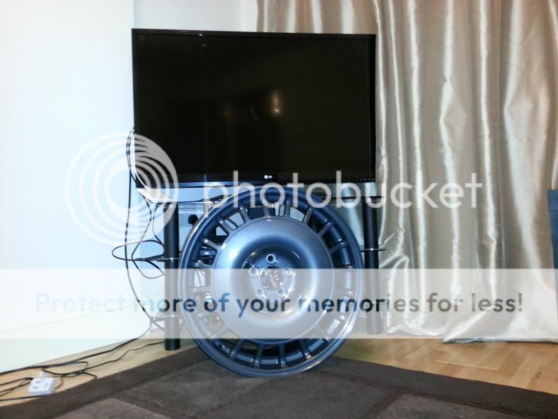

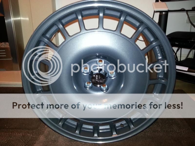

Compomotive thv2 18x8. Purchased from reyland motorsport who I believe are currently the only supplier in the u.k to offer them in 18's. Thanks to reyland for supplying these beauties.
Will be sorting the rubber later next week.
