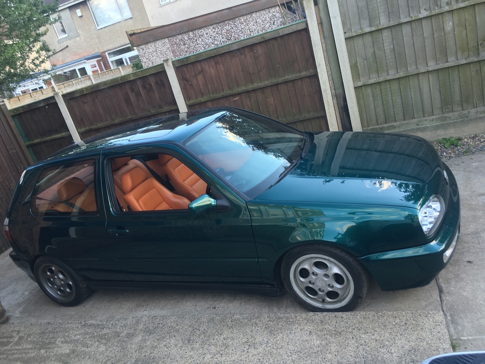

s3dxm 38 Posted August 16, 2016 Author Report Share Posted August 16, 2016 Photos taken the weekend after VW festival.This is how the car looks now.Parts on order:Set of plug leads.Set of plugsProper VR6 splitterBeen to the scrap yard yesterday and picked up a new bonnet catch and cable an nearly new battery for £30New window regulator for drivers door.Got all that fitted last night and removed all the crap from inside and hoovered it out.More pics and progress to follow.... Link to post Share on other sites

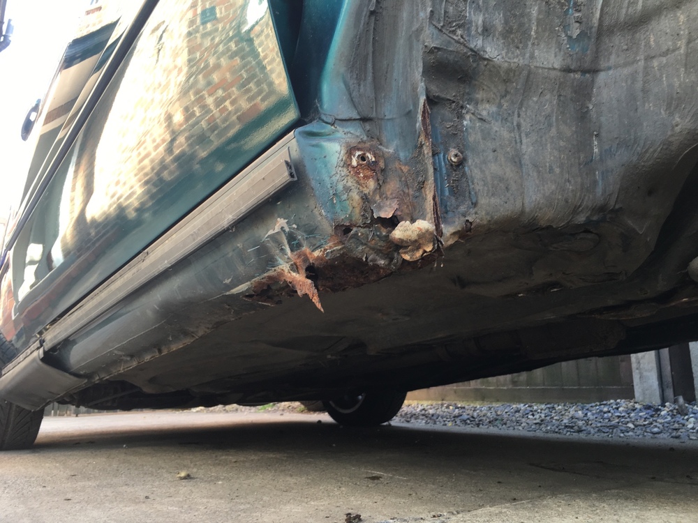

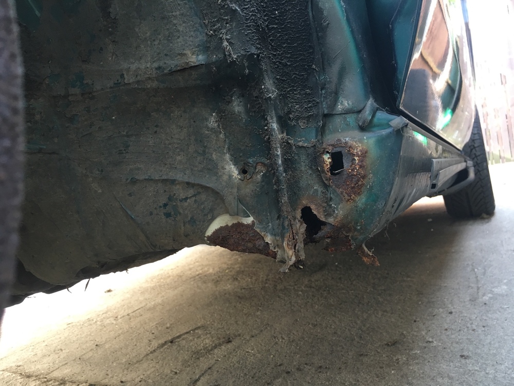

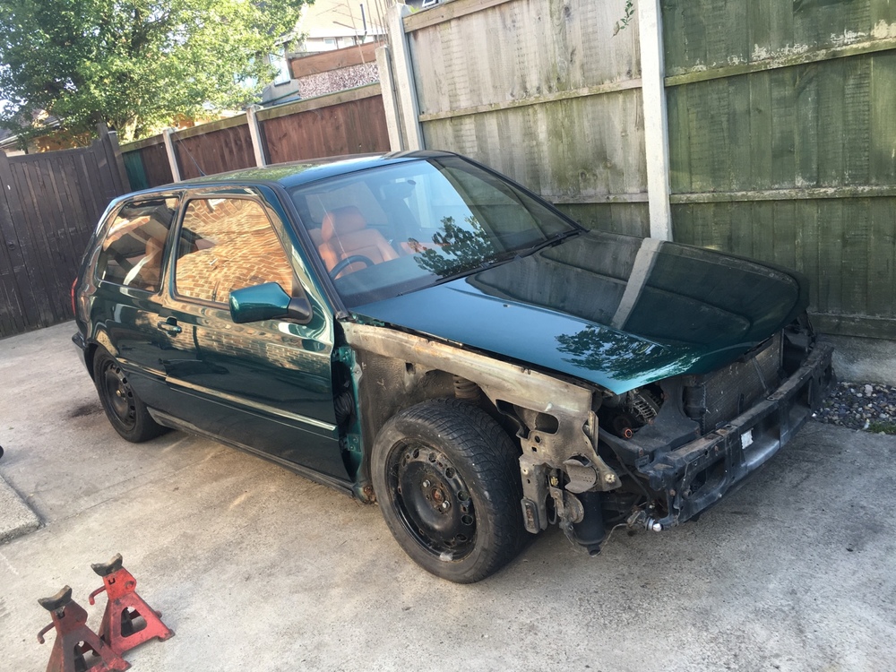

s3dxm 38 Posted August 16, 2016 Author Report Share Posted August 16, 2016 Done a little more today.Seems I've a little more work ahead than anticipated....Needs both sills patching.Needs a pair of wings.Rear arches need work.Rear wings under light clusters need work.All brake pipes are about shot.Car is somewhat rusty underneath.Needs a clutch.Need some wheels.Gonna need a full paint job....Meh...... At least the interior looks good lol.... bennyk 1 Link to post Share on other sites
bennyk 1,238 Posted August 16, 2016 Report Share Posted August 16, 2016 The rusty sills look similar to mine when I started poking, you can get pattern sills for next to nothing though, shame as it looked quite clean in the photos! So are you going to restore it to its former glory, as in the mag feature or change it about a bit? Good to see it being saved and not broken by the way! Link to post Share on other sites

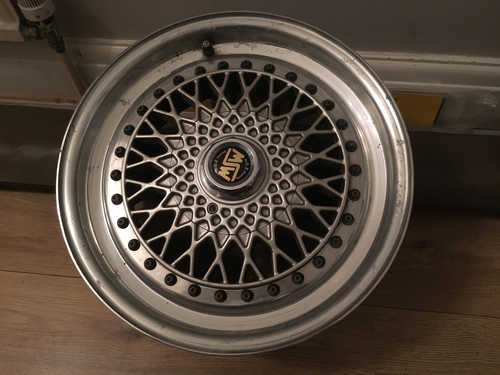

s3dxm 38 Posted August 17, 2016 Author Report Share Posted August 17, 2016 Was a bit of a downer at the time.... Initially thought about looking for another car and swap all the good bits over.... Then gave my head a shake. Two Golf's on the drive is too much, it's full enough at the moment. Plus I'm likely to find something in a similar condition unless I'm spending some decent money.Had a look on Euro car parts....£250 for clutch, all brakes, pair of wings and oil filter. I can paint the wings myself before fitting to save a bit of faf and hopefully money when it comes to painting - at least they will be green and fully fitted before painted again with the rest of the car.I can fabricate a patch/repair section for the sills as its only about 6" at the front that is crusty.Copper brake pipes are no drama, might as well just do the lot while it's all apart. Just a bit more work than first anticipated.I'm thinking I'll keep the similar lines to as it was in the mag feature.Just need to sort a set of wheels. Or a set of 5x100 - 5x120 adaptors for these that I've got.7x16 OZ MSW split rims....At least I can do all the polishing myself, and just get the tears powder coated.Possibly a set of wider dishes for the rear too....All food for thought.... bennyk 1 Link to post Share on other sites

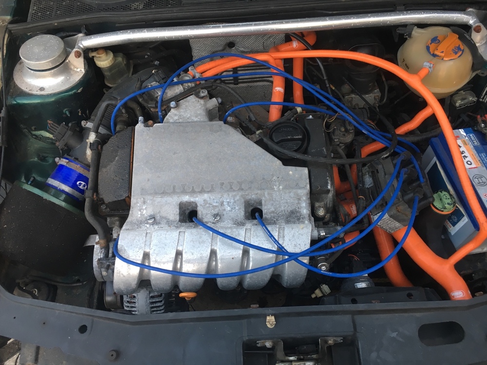

s3dxm 38 Posted August 17, 2016 Author Report Share Posted August 17, 2016 New plug leads fitted, New plugs fitted,New coilpack on order! Slow day today for progress.... Ordered the following bits though....Valeo clutch kit.Discs and pads frontDiscs and pads rearOil and filterPair of wings.Gonna make a start and do the clutch first. At least then I can manage to move the car around easily.Rear bumper will be coming off and more prodding around to inspect for rust.Underseal is waiting after the welding is done, if I'm investing in this one, I want to make it last!!Anti roll bars to be removed and painted orange.Have a pair of new rear calipers ready to fit.Along with a mile of copper pipe to redo all the brake pipes.Sure I've still got some goodridge hoses somewhere in the garage too.I guess at this stage it's all or nothing? So I'm going in balls deep lol! Figure I might as well sort all the rust on the body and prep for top coat myself to save some ££££.More progress to follow! Bealieboy and bennyk 2 Link to post Share on other sites

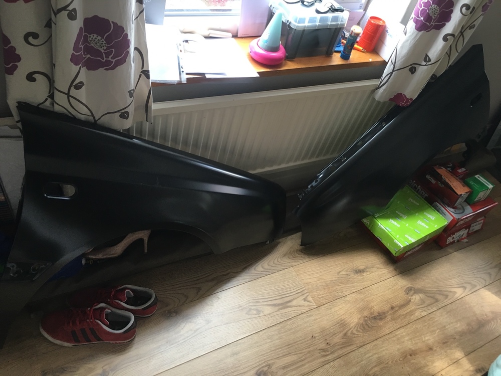

bennyk 1,238 Posted August 18, 2016 Report Share Posted August 18, 2016 The Euro's wings I've fitted to mk3's in the past have been pretty good and I've just got a wing for one of mine, I'll get it fitted in the next day or two and let you know how it goes Link to post Share on other sites
s3dxm 38 Posted August 19, 2016 Author Report Share Posted August 19, 2016 The Euro's wings I've fitted to mk3's in the past have been pretty good and I've just got a wing for one of mine, I'll get it fitted in the next day or two and let you know how it goes That's what I've got for mine, quick mock up in place and they look quite reasonable.Will have plenty paint and underseal on them prior to fitting and hopefully make them last! bennyk 1 Link to post Share on other sites

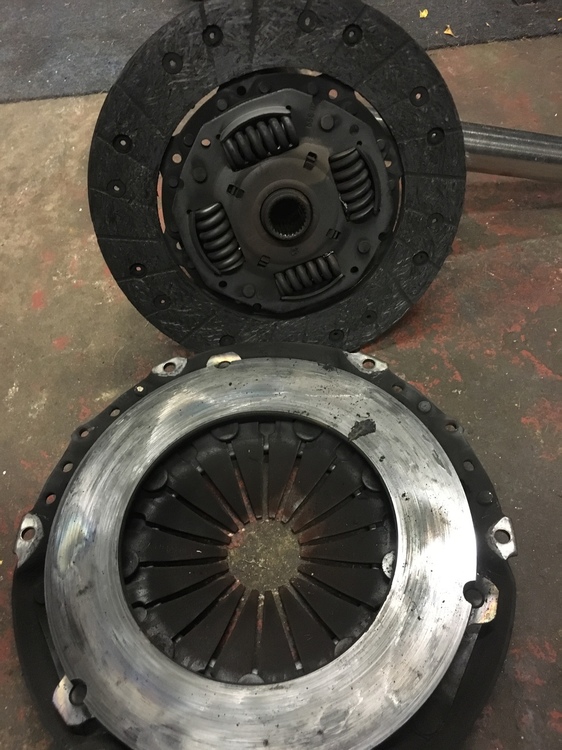

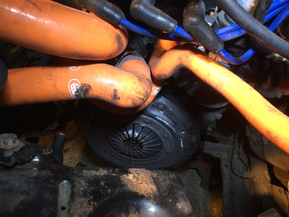

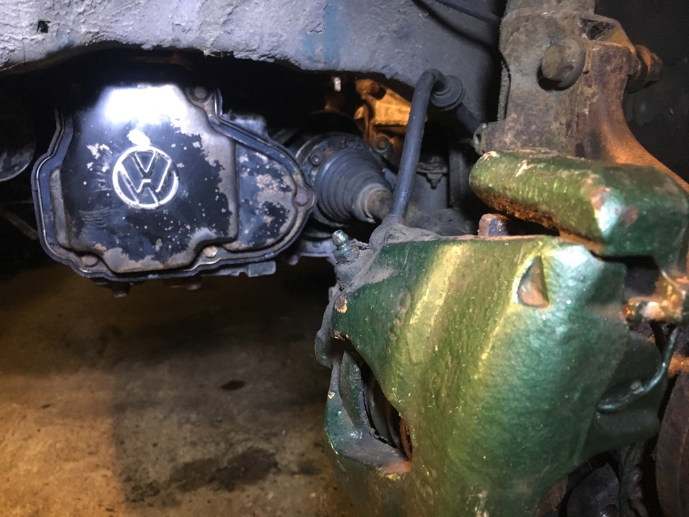

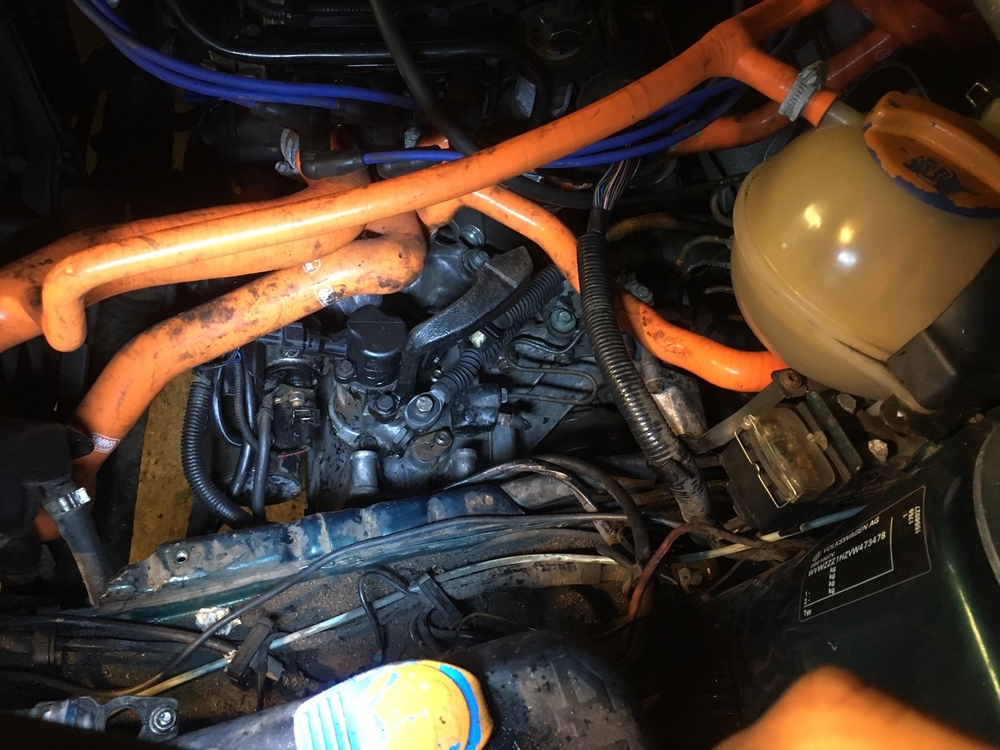

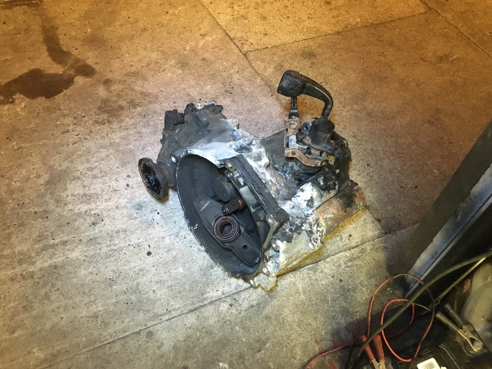

s3dxm 38 Posted August 19, 2016 Author Report Share Posted August 19, 2016 Made a bit more progress last night...Not a bad job, have new Valeo clutch ready to put in tonight all being well. Box needs a good clean, along with the rest of the engine bay whilst it's all in bits. The old clutch is well fooked. The smell of the burning plate was not pleasant lol. Hope to get the underside cleaned up and get the sills plated, painted and undersealed this weekend too. See how the weather holds up.... Link to post Share on other sites

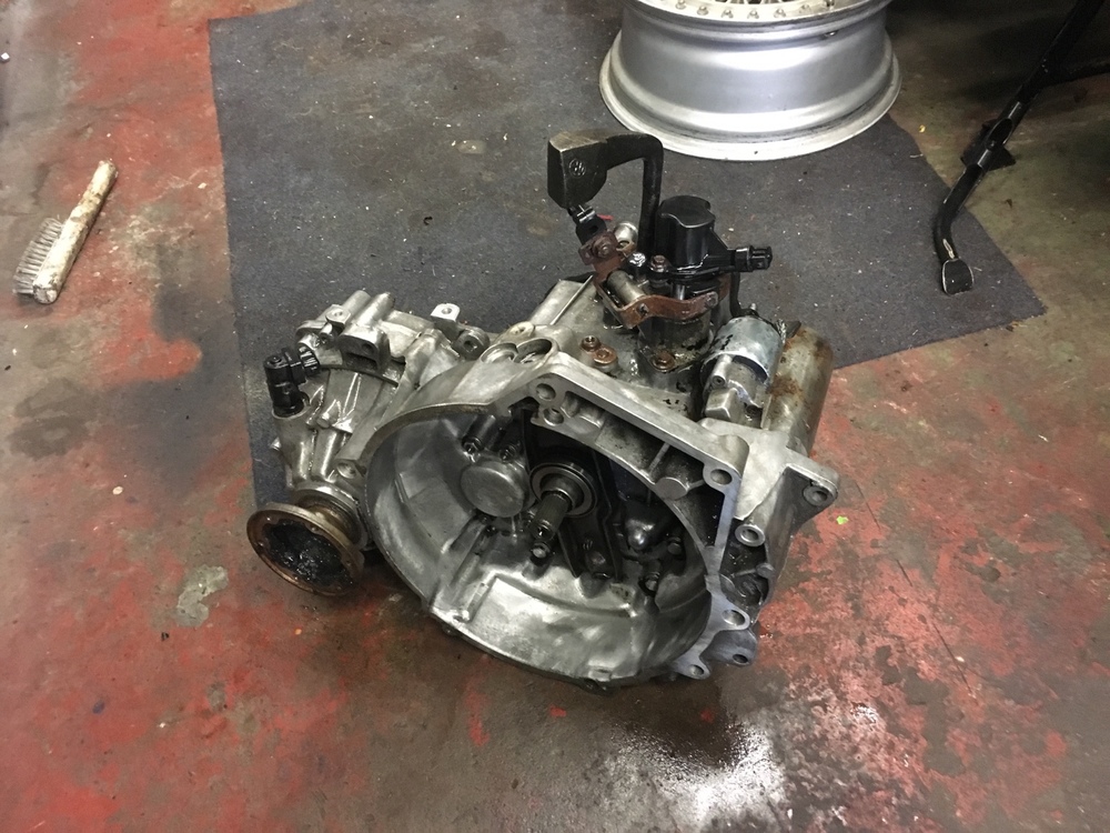

s3dxm 38 Posted August 19, 2016 Author Report Share Posted August 19, 2016 Gearbox washed off and cleaned up.Not going too mad. I intend to use this car....! Rain has stopped play today...Few beers and some online shopping tonight for debadged grille and more inspirational ideas lol.....Hopefully it will stay dry tomorrow! Dave_ciw 1 Link to post Share on other sites

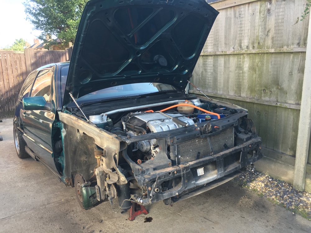

s3dxm 38 Posted August 19, 2016 Author Report Share Posted August 19, 2016 Well, the rain had stopped. It was still a mild evening. Things started to dry out.....Best crack on with the clutch and gearbox refit then!All went well, no dramas.Found it easier to remove the shifting tower to get it back together...All bolted back up. More or less complete and ready for a clean under the bonnet and to attack the brakes tomorrow now.Found my goodridge hoses in the garage. Fronts are the correct ones, need to check the rears.Calipers will get a coat of paint too. Enough waffling for now, my back is sore and a need a beer lol.....Hope for a dry day tomorrow and get cracked on!! Rustybear, Dave_ciw, bennyk and 1 other 4 Link to post Share on other sites

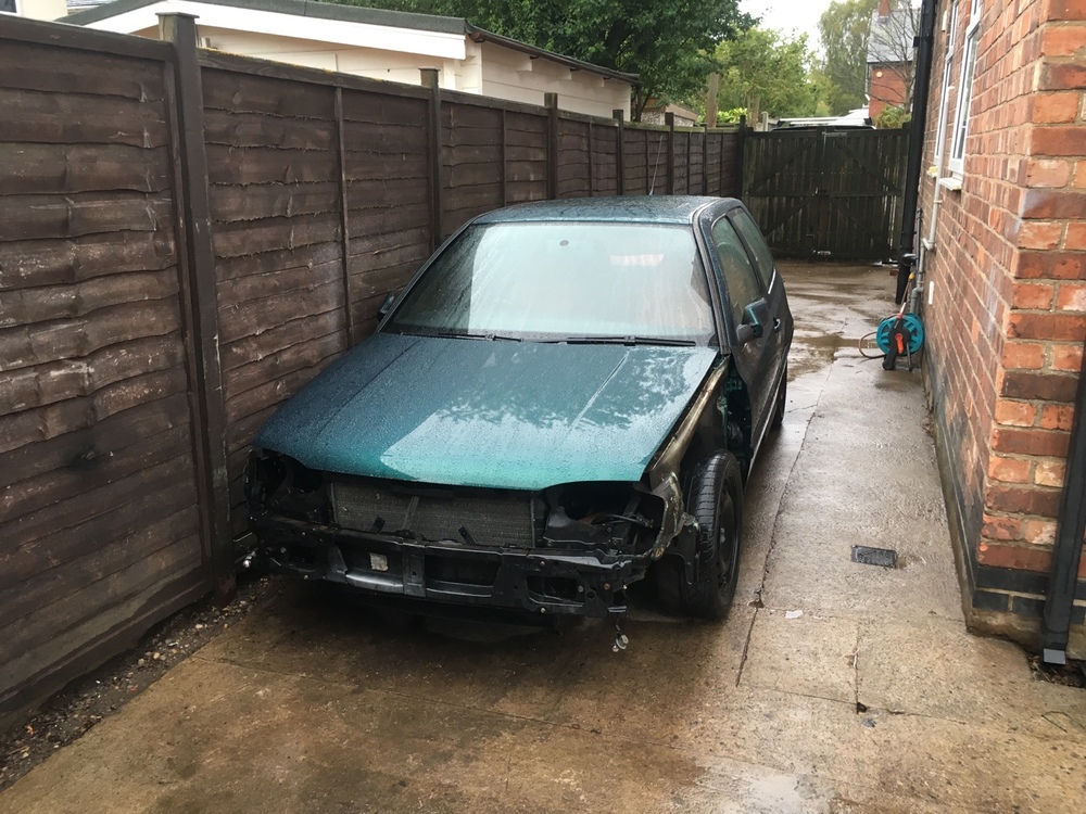

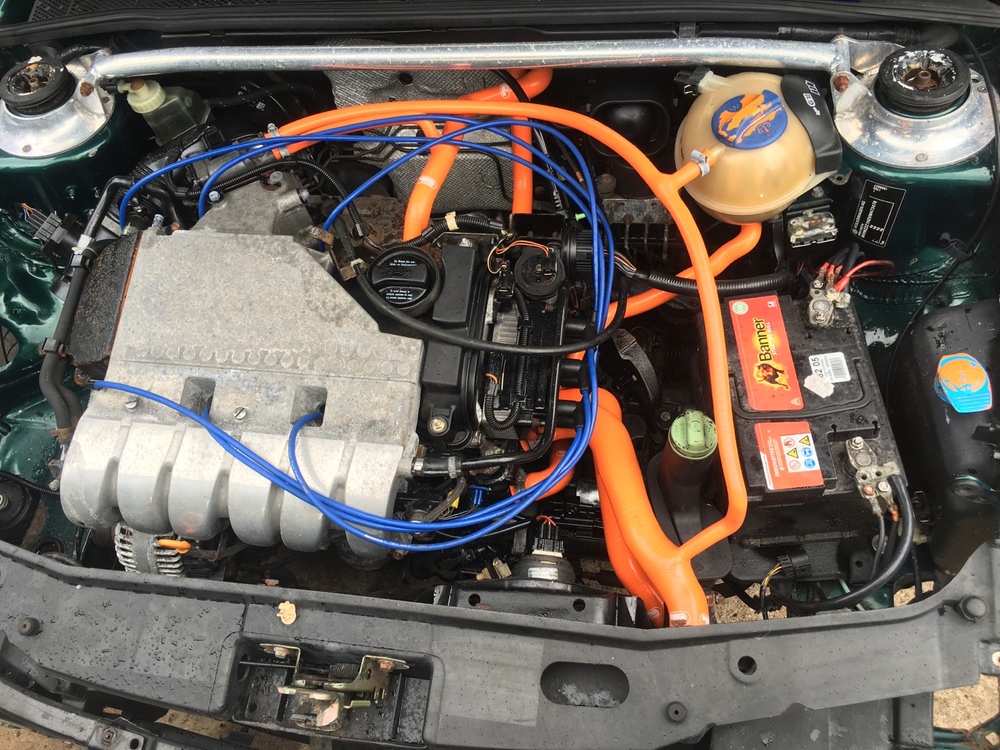

s3dxm 38 Posted August 20, 2016 Author Report Share Posted August 20, 2016 One sill all patched.Back on its wheels, moves under its own steam now - so that's a bonus!Engine bay cleaned up, battery tray painted.Prep to do other sill tomorrow all being well.And more shopping lists to make! Link to post Share on other sites
