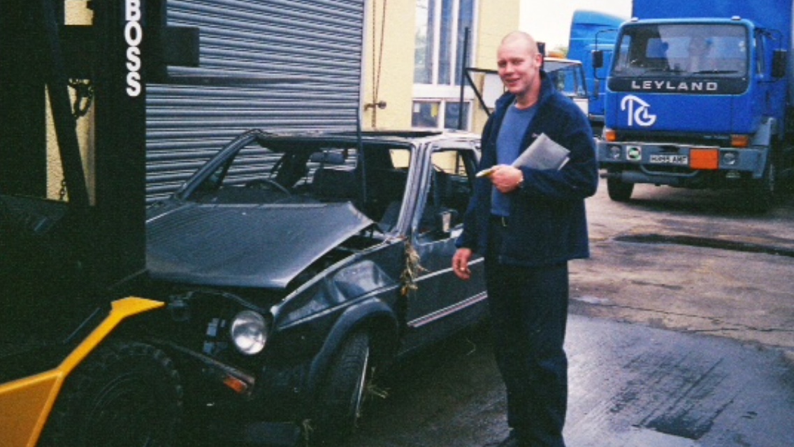

Bealieboy 1,625 Posted January 25, 2015 Report Share Posted January 25, 2015 Be bloody careful of them mate, this is a pic of my car after fitting the suspension but before adjusting the apportion valveAnd yes, it bloody hurt! VR6CABBS, Cooz93 and bennyk 3 Link to post Share on other sites
Cooz93 66 Posted January 25, 2015 Author Report Share Posted January 25, 2015 Be bloody careful of them mate, this is a pic of my car after fitting the suspension but before adjusting the apportion valve ImageUploadedByTapatalk1422218262.858794.jpgAnd yes, it bloody hurt!ouch!! That looks a bad one. Car won't be going anything for a long time so will take extra care when setting it up. Is there a trick to it? Bealieboy 1 Link to post Share on other sites
Bealieboy 1,625 Posted January 25, 2015 Report Share Posted January 25, 2015 ouch!! That looks a bad one. Car won't be going anything for a long time so will take extra care when setting it up. Is there a trick to it?Im unsure how to set the valve mate, all I know is they can kill or seriously maim if you don't know what you're up to with them! I should think they're easy enough to set up though. Link to post Share on other sites
Cooz93 66 Posted January 25, 2015 Author Report Share Posted January 25, 2015 Thanks for the heads up mate, will do my research before setting it up Bealieboy 1 Link to post Share on other sites
