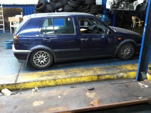

Reaperx 181 Posted December 18, 2013 Report Share Posted December 18, 2013 (edited) Thought I would stick up a progress thread for my mystic blue 5 door. Having searched for a while for a project car I decided on a vr6. No luck finding one anywhere then one popped up on gum tree for 450 as needing work for mot. After making a quick call turns out I knew the seller and got it for 300. This is how it stood. Edited December 18, 2013 by Reaperx VR6Pete 1 Link to post Share on other sites

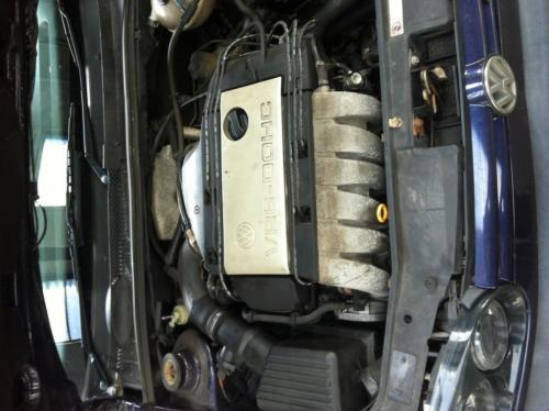

Reaperx 181 Posted December 30, 2013 Author Report Share Posted December 30, 2013 Not too much to update but exhaust was blowing have sorted that with a sleeve off eBay. Think the coilovers need winding up as I caught the sump pulling onto a 4 post lift. Heater matrix has arrived so will get that fitted at weekend hopefully along with a new sump. Then I can start the wheels and bodywork Link to post Share on other sites

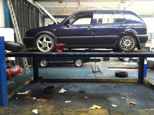

Reaperx 181 Posted January 20, 2014 Author Report Share Posted January 20, 2014 (edited) Not much to update been busy fixing other people's cars, but had to raise the suspension so I could fit the car onto the lift at work. How it sits at the moment hopefully get a bit f spare time this weekend to fit decat pipe and sort the heater matrix out. Then it's off to a mates body shop whilst its in there I'm going to refurb my Porsche rep alloys in anthracite. Then see what finances I have and what to do next as not too sure. Edited January 20, 2014 by Reaperx Link to post Share on other sites

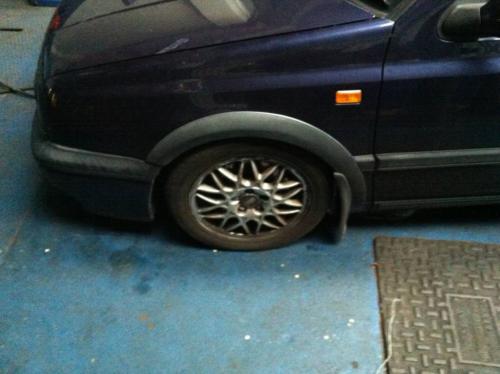

Reaperx 181 Posted March 11, 2014 Author Report Share Posted March 11, 2014 Bit of an update heater matrix has been replaced. Exhaust blow has been fixed. Off to the bodyshop at the weekend to make a start on it. Thought I would test fit my other wheels to see if I liked them and they fit ok before I get them returbed. Link to post Share on other sites
mattvr6 133 Posted March 11, 2014 Report Share Posted March 11, 2014 I like them wheels just wish they were 16s looks like a bad dent on the arch aswell mate Sent from my iPhone using Tapatalk Link to post Share on other sites
Reaperx 181 Posted March 11, 2014 Author Report Share Posted March 11, 2014 The arch has had a bad knock at some point and the rust is starting to kick in that's why I want it in the bodyshop ASAP. Just need to source a trim piece for it looks like il have to go to main stealers for one. Can't decide if I want the wheels anthracite or vw gloss black pearl. Link to post Share on other sites
