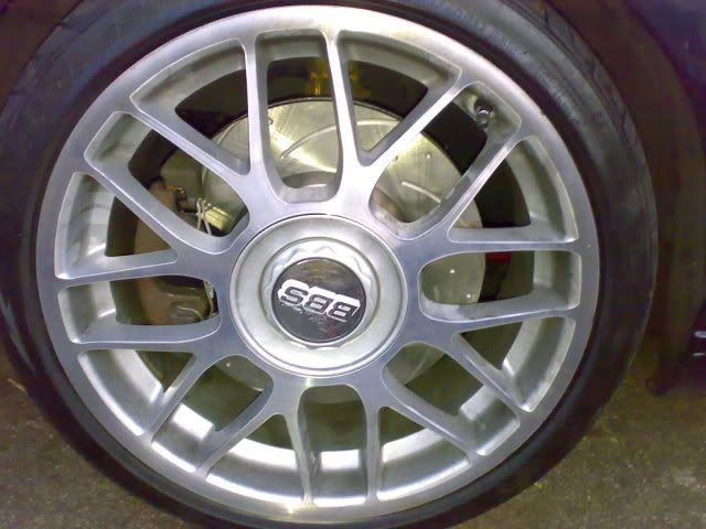

Gazbarber1982 3 Posted June 12, 2011 Report Share Posted June 12, 2011 What years your vr? The later ones don't have the bias if they have abs apparently. I've got s3 312mm brakes up front with ebc ultramax discs and red stuff ceramic pads. On the back I've got standard size ebc ultramax discs and red stuff ceramics again. I'm running 275bhp and have plenty of confidence with my brakes, even out braking mk5 r32's from speed. I looked into the Porsche calipers upfront but they won't fit under 16" BBS. I had to grind the top of the s3 calipers to make them fit my wheels. I needed the calipers, carriers, pads, discs and I made a spacer out of 6mm ally plate. Also needed slightly longer high tensile bolts to hold the calipers in place. Link to post Share on other sites

Gazbarber1982 3 Posted June 12, 2011 Report Share Posted June 12, 2011 here's what my brakes look like on mine... Link to post Share on other sites

Gazbarber1982 3 Posted June 12, 2011 Report Share Posted June 12, 2011 heres the pic Link to post Share on other sites
Gazbarber1982 3 Posted June 12, 2011 Report Share Posted June 12, 2011 get the part number. from memory the part number ends in 425 and 426 Link to post Share on other sites
Gazbarber1982 3 Posted June 12, 2011 Report Share Posted June 12, 2011 Originally I was gonna go with yellow stuff pads as you can probably tell by the calipers but they didnt do them for the rears! Link to post Share on other sites
