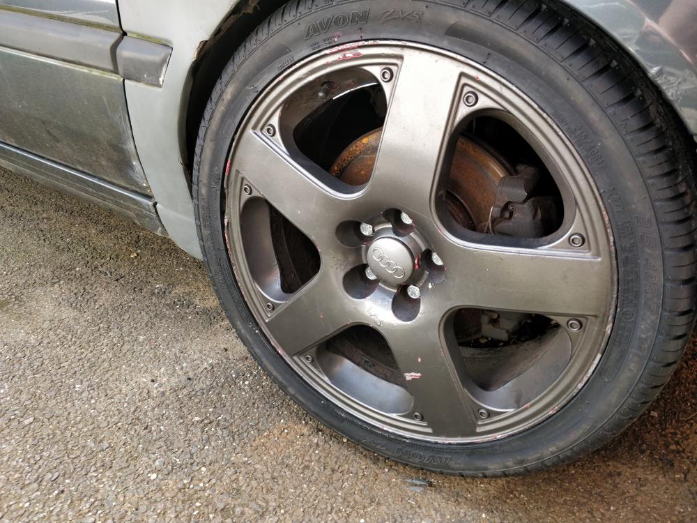

p0u1 14 Posted April 14, 2018 Author Report Share Posted April 14, 2018 Got new rubber that fits under the arches. Nothing special as its a set to tune on (and I'm not really bothered at this point) VR6 Supercharged 1 Link to post Share on other sites
