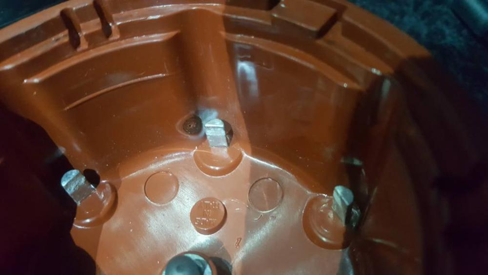

boab3 164 Posted June 23, 2017 Author Report Share Posted June 23, 2017 Well i went back to basics plugs out gaps good dizzy cap off and seems to have blown a hole on one cylinder glad ive got spares.this could equate to the slight rough running at idle so change this out tonight.checked for voltage at maf all good just to rebuild up again and ill pull maf plug off just to i double check the maf is working. Gazbvr6 1 Link to post Share on other sites

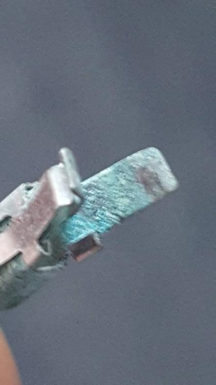

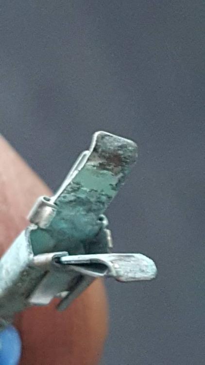

boab3 164 Posted June 24, 2017 Author Report Share Posted June 24, 2017 Ok new cap fitted 310cc injectors and chip back in running much better this .code o2 sensor limit surpassed i had forgot i had this fault before fitting charger i presumed i cured it by buying a new bosch lamda.obviously hadnt and this is why im running rich even more so with bigger injectors etc.lambda plug on car loom has 4 wires the yellow that connects to pin 42 in ecu i think is the ground for sensor has corrosion on terminal.im thinking as the lambda detects a lean mixture the voltage would be low and if rich it would be high.as ive got a corroded terminal id have no voltage to sensor so in theory itd be thinking its weak and firing more fuel in. Job for 2moro replace corroded terminal and try it out.its running fine just now but still coming up with lambda control limit surpassed VR6Pete and Gazbvr6 2 Link to post Share on other sites
boab3 164 Posted June 25, 2017 Author Report Share Posted June 25, 2017 Well wont be getting continuity through that terminal its the earth for sensor side not for heater side.hopefully found the problem Gazbvr6 and VR6Pete 1 1 Link to post Share on other sites
Gazbvr6 16 Posted June 25, 2017 Report Share Posted June 25, 2017 Wow! Lol Link to post Share on other sites
boab3 164 Posted June 25, 2017 Author Report Share Posted June 25, 2017 My theory is no contact no voltage.no voltage makes ecu think its running weak or sensor fail if it does fail or think its weak it automatically puts an extra 25% fuel in as a fail safe Gazbvr6 1 Link to post Share on other sites
