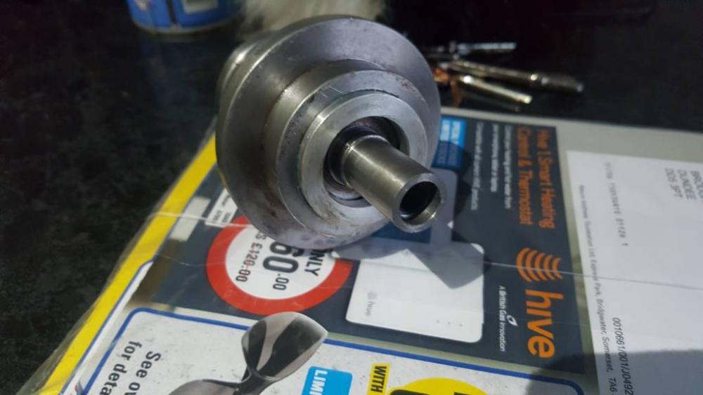

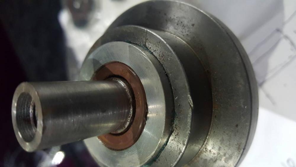

As far as I know there the original ones the inner diameter is the same. It's just the od are different where they sit in the collars on the housing. I used the 3  bearings that were in the rebuild on hear .
Mines both sides of housing the same diameter for seals.ive no locking ring like that.weird why they made so many different.all i have is 2 bearings one spring loaded coupler and 2 locknuts on the main shaft for retaining the bearings
I have two ZR1 chargers that I'm looking to rebuild. In the U.S. the cogged pulleys on the ZR2 were apparently pretty rare due to a ProCharger patent. Does your machine shop friend have any interest in making more shafts to sell? Did he also make the small cogged pulley or is RUF selling those now?
These pulleys are on ebay for £10 they do need machined out to fit on the supercharger shaft.as for the shaft it was a one off but i can measure up the shaft dimensions and post it up for you
Well charger housing with my machinist mate need to lift seal to get seal onto sealing area of shaft hopefully machining up a top hat collar to lift the viton seal im fitting to seal on shaft.in the meantime ebay goodies again

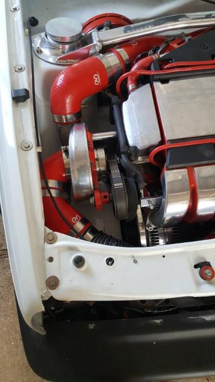

Hey pete where did you get this hose from? Any problem with it collapsing under suction? Ive got it all up and running all seems good maybe a bit rich and lumpy on idle but i think its down to the maf being too close to charger causing turbulence from the impeller

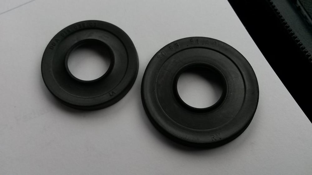

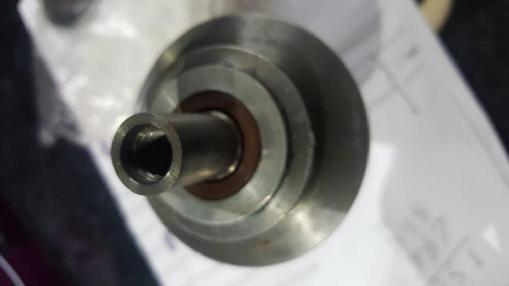

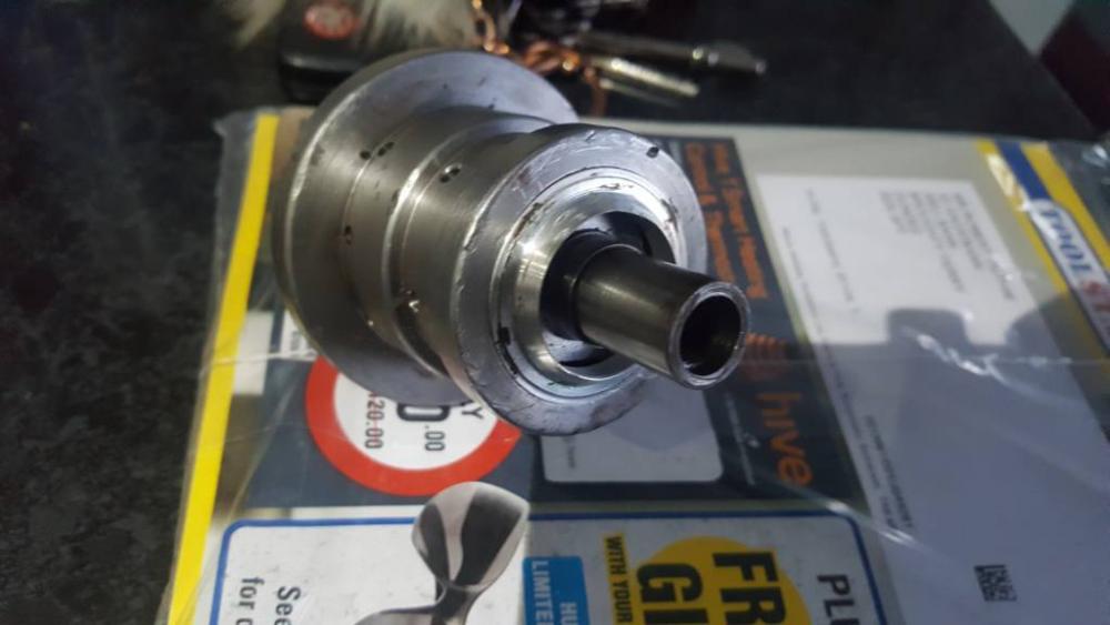

Couple of new bits machined up to take the viton seals i bought all fitted and oil leak free been running fine just to move maf further away from charger should solve the idle and running rich issues20170530_221014.jpg20170530_221009.jpg20170530_215419.jpg20170530_215406.jpg
I got them from ASH performance mate, they are intended as intake hose and are re-enforced and so not collapse.
Cheers pete one ordered hopefully here monday didn't help i forgotten to tighten spark plugs up now there tight its much better idle is good starts 1st turn of the key but im going to move maf slightly more away from charger see how it alters anything.so no oil leaks as yet crankcase breather done just fuel pump to swap over and a blast up the road.i have found a 16v fuel pump assembly from an early mk2 in my man cave plan is to remove accumulator fit a barbed connection onto pump and straight swap over with pumps.4 bar regulator allready fitted so fuelling should be sorted.once this rains out the way its time for a road test

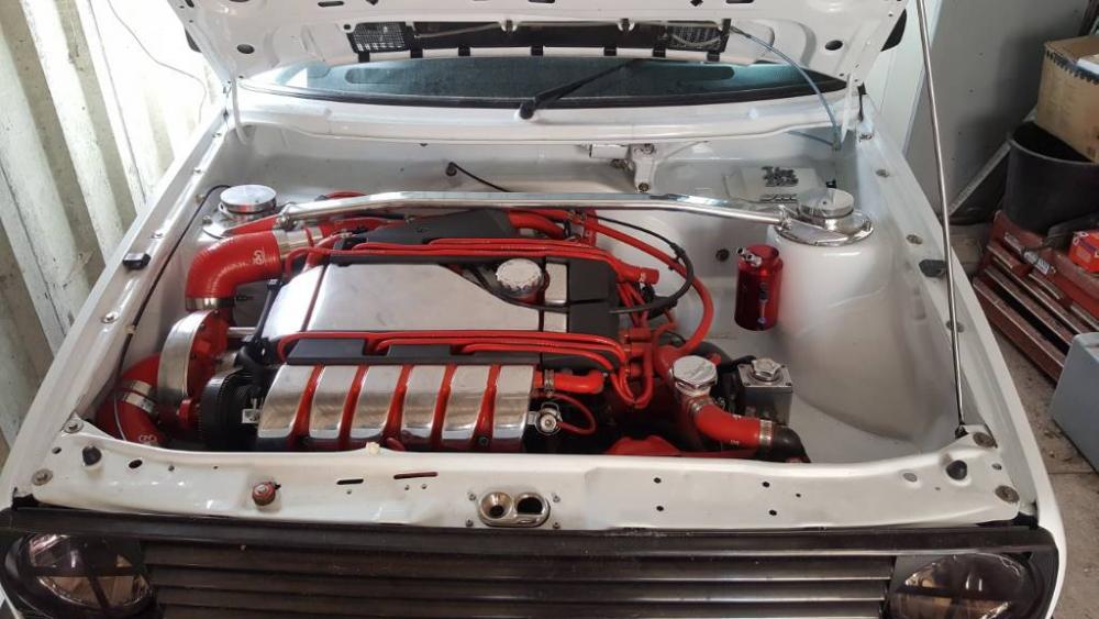

Running sweet now bit tight moving maf which is down at bottom of bumper oil catch can mounted just pipe to connect up.Cars turned around now in garage to swap over fuel pump thats 2moro's job.Might change out blue temp sensor still a slight richness when hot if i disconnect sensor it runs spot on so maybe cold start just reading too cold keeping it rich not good with big injectors so ill swap that out.never had a blue temp sensor play up when hot only cold starting 20170618_155200.jpg20170618_162713.jpg
