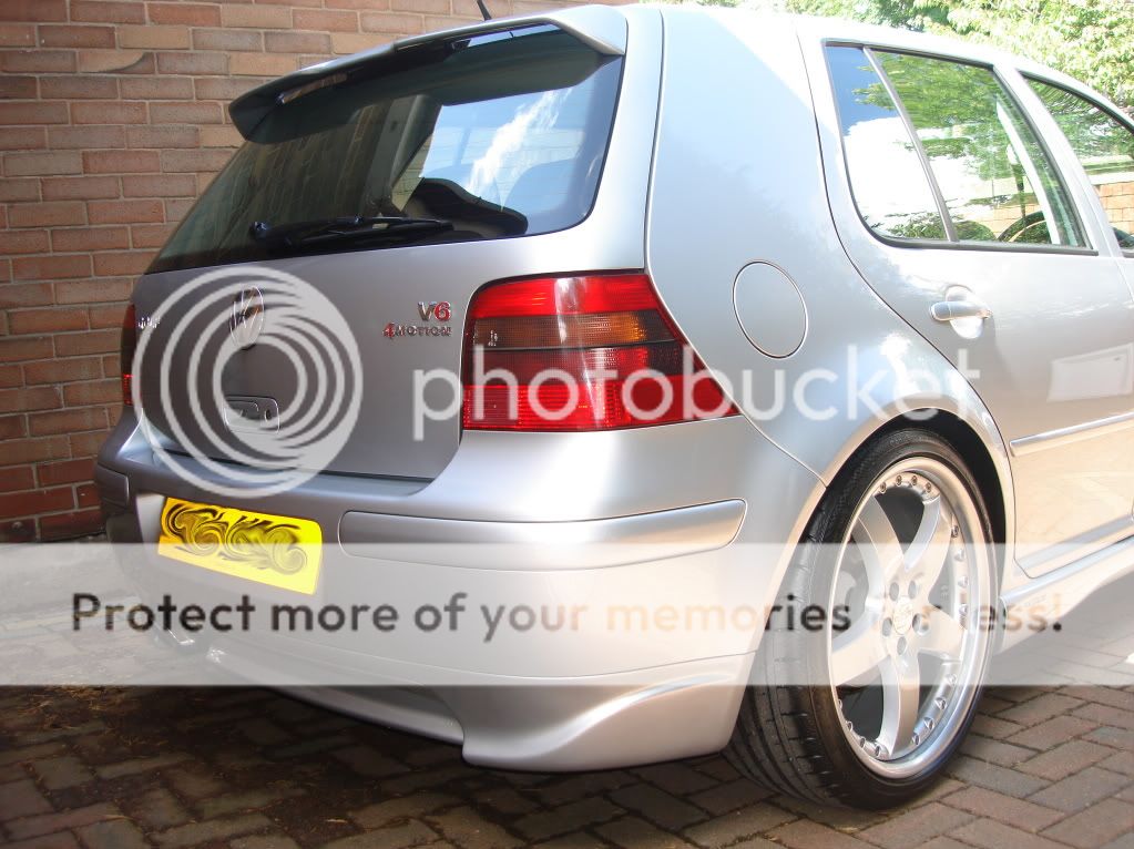

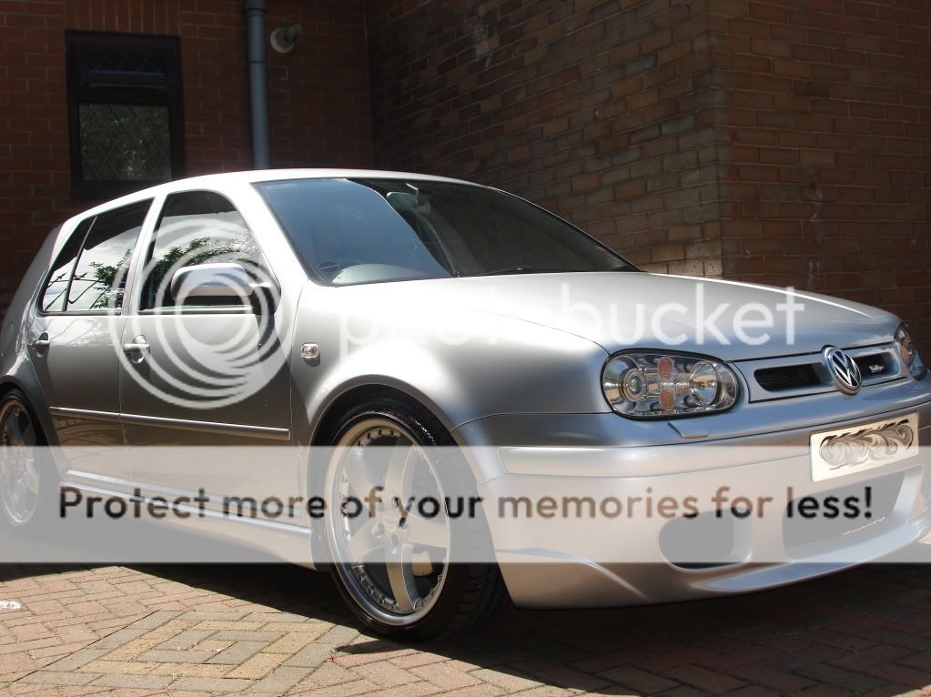

amar7274 0 Posted August 30, 2010 Report Share Posted August 30, 2010 I'm new to this site so be gentle, I currently drive a MK4 Golf V6 4Motion.I would like to increase the car's power by adding a turbo or possibly supercharging it. Can the peeps on here point me in the right direction please.Here are a few pictures of my car: Link to post Share on other sites
vr6stormt 0 Posted August 30, 2010 Report Share Posted August 30, 2010 nice looking car there mate i know bungy (on here) is in the process of charging his might be worth sending him a pm.... Link to post Share on other sites
mike 6 Posted August 30, 2010 Report Share Posted August 30, 2010 very nice mate, s/c would be awsome craggsy is selling a rotrex one which are the dogs...i got a mk4 gt tdi at the mo lol Link to post Share on other sites

bungy 2 Posted August 30, 2010 Report Share Posted August 30, 2010 Oh, hello and . Nice looking 4mo you have there. Link to post Share on other sites
