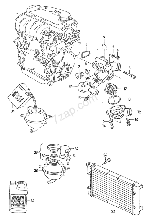

chalkyh 10 Posted December 21, 2020 Report Share Posted December 21, 2020 After having my grey VR apart to do the crack pipe after changing the oil cooler that was putting oil into the coolant, I ended up changing all the housings onto the head because I was just chasing new leaks - in the end the thermostat elbow, sensor housing and crack pipe elbow and all o-ring seals - there were fine little cracks that were allowing coolant to get past the head o-ring 2 - and also the new crack pipe top o-ring into 19 had a little cut in it when donkey here assembled it all up. Those plastics warp and are generally not so good if original. The head o-ring 2 in the pic will run down to the knock sensor boss, certainly mine did. There's a few sellers of the full set on ebay . . . coldguinnessman 1 Quote Link to post Share on other sites
