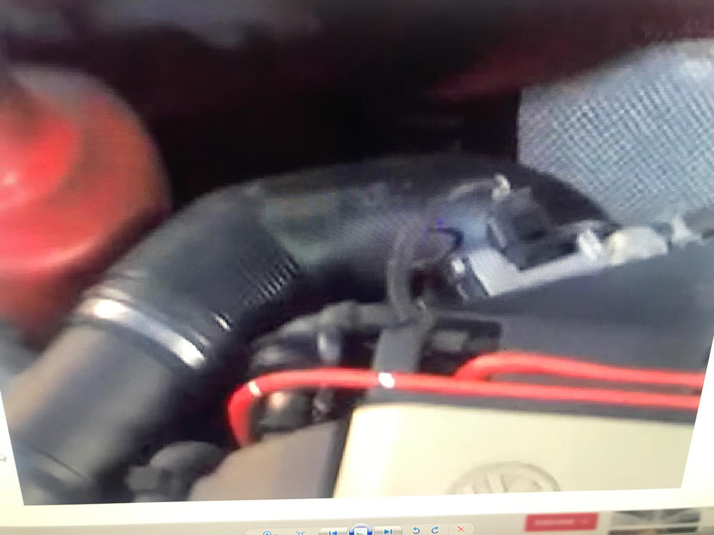

I would start by checking your vacuum pipes as quite often if there is even a small leak this will cause idling issues and stalling. Also check your main air intake pipe after the air box and check there are no splits in it. Sometimes the split can be small so if in doubt remove the pipe and water test it. See picIMG_0016.jpg
