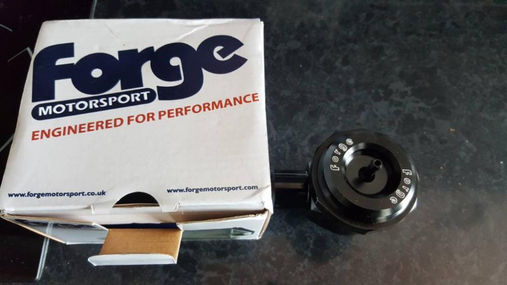

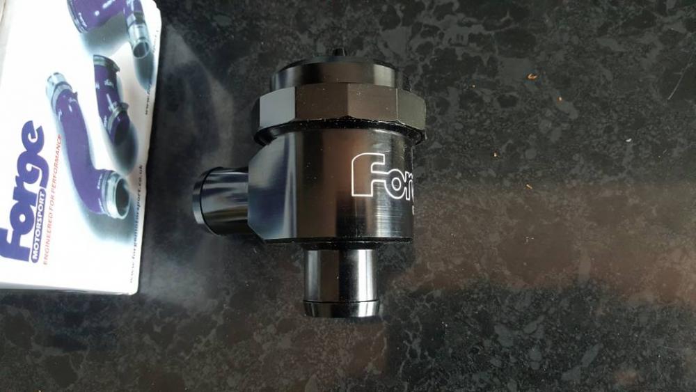

boab3 164 Posted June 28, 2017 Author Report Share Posted June 28, 2017 Got a forge 007p diverter valve hopefully do the trick Gazbvr6 1 Link to post Share on other sites
boab3 164 Posted July 8, 2017 Author Report Share Posted July 8, 2017 Postman was decent this morning eventually received my valve. Gazbvr6, VR6Pete and mk2vrsix 3 Link to post Share on other sites
boab3 164 Posted July 8, 2017 Author Report Share Posted July 8, 2017 Just need 2 T pieces one to T in before charger one to T in between outlet and throttle body one vacum hose to blend in with colour scheme and 2 hoses from valve outlets to T pieces in red aswell. mk2vrsix 1 Link to post Share on other sites

boab3 164 Posted April 14, 2018 Author Report Share Posted April 14, 2018 (edited) Well plumbed in and running its a bit better but still a bit rich.decided to have a look at valve aghhhh its been uprated to yellow spring thats 15-23psi no way will it open under vacuum with that hefty spring and very little pressure so new green spring on its way from forge thats 5-15psi so hopefully vacuum will open it easily at idle now.it is much better just now but i'll change to a lighter spring and update ASAP Edited April 14, 2018 by boab3 Link to post Share on other sites
boab3 164 Posted April 18, 2018 Author Report Share Posted April 18, 2018 New green spring fitted running much better.now need to relearn ecu since its been powered down so long.good excuse to blip the right foot Link to post Share on other sites
