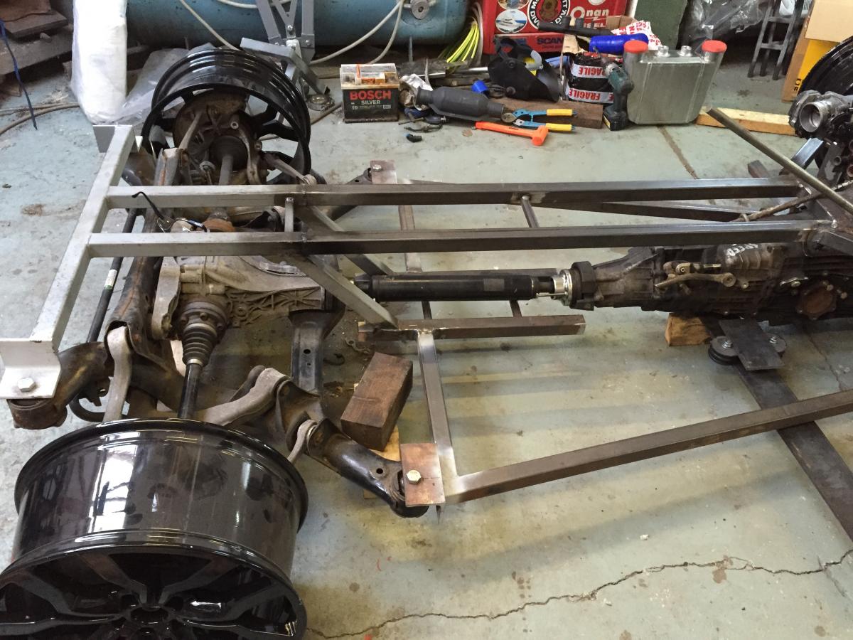

Sam00Cleveland 12 Posted February 3, 2015 Author Report Share Posted February 3, 2015 Hello again all !Sorry for the delay in replying...., been very busy with work, chassis building, writing off my nice shiny 2010 3.0T A6..., buying an even nicer shiny 2010 S6..., sorting out a few issues with that, house buying etc etc !!However !, the chassis is coming together very well..., the front and rear sub assemblies from a 2008 S5 are attached, I had the propshaft in the lathe the other day and that is mocked up, the boost pipwwork parts and exhaust are all on the way to completion.The inlet and exhaust manifolds, turbo, gearbox adapter plate from a Passat 2.3V5 (same bell housing pattern as the VR6), Passat 2.3V5 Flywheel and clutch are all mounted and in place for mocking up purposes !And today was a momentus occasion !, the first engine mount was created !, there are 4 x M10 bolt holes on the right side (rear right in normal golf installation) of the engine which I picked up on, bought the metalwork around above the main pulley where it sits on top of a rather large rubber mount to a cross member between the suspension legs.Torsional rigidity of the engine to the chassis will be obtained by using 2 more rubber mounts either side of the gearbox and possibly another mount on either the right side of the engine, extended out as far as possible or up above the current mount to another crossmember in the chassis....Here are a few vague pics ! - chassis has changed very slightly since these pictures, will update with new pictures tomorrow once I have had a bit of a tidy up.... Or not !All the best, Sam daveyboy 1 Link to post Share on other sites

Sam00Cleveland 12 Posted May 8, 2016 Author Report Share Posted May 8, 2016 Hiya Fuzzwaldo Awesome - always like to hear of a vr6 heading into another vehicle ! Mine was originally destined for a speedboat ! As for the gearbox !, I haven't fully removed the front drive from the gearbox as yet - however, it is very easy to do. For now I have removed the rear section of the gearbox (the rearmost ring of bolts around the casing), this's allows you to slide back the rear section of the box, inside you will see the Center Torsen type diff, like I say this is only temporary but I have welded the front/rear pinion gears together so all of the drive at the moment is still transferred through the worm type pinion gear teeth to the output shaft gears. When the car is all built up and it's time to strip down for painting and final build up etc I plan to remove the torsen, take it to a local engineering company who will machine a blank unit for me and broach the input shaft splines and the rear output shaft splines into the blank - should have an engineered drawing of the part too so I shall circulate that once available - eeeek !! This will then allow me to remove the front diff and the driveshaft to it (if the front prop shaft doesn't support the intermediate shaft inside the gearbox) ! I can then machine some plugs for the front output shaft seal holes with a thread in for a hose fitting to allow me to circulate and cool the gearbox oil. The chassis has come a long long way since the photos, I cut a lot of it away and re-designed a large portion, I haven't had a chance to get much done or take any progress photos for a while as I have been doing lots of work to our house..... And building a garage so I can move all of the various projects from my parents place Also did an engine rebuild on a cheap Bora I bought on eBay recently - of course, that has a VR in it too Will get some cobra related pics up as soon as I can ! Link to post Share on other sites
