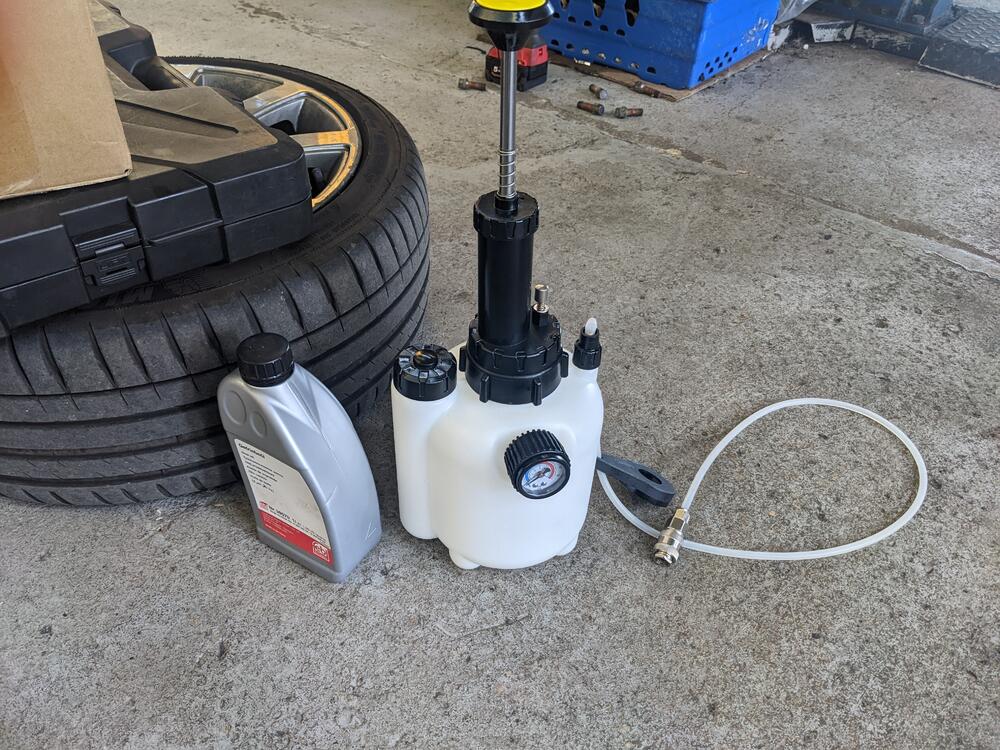

I managed to grab a ramp at Bill's to do this so I also topped up the DSG box fluid... took another ltr which I expected tbh... and my modded brake bleeder tool did the job perfectly..

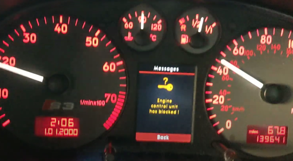

I still have this random error pop up...

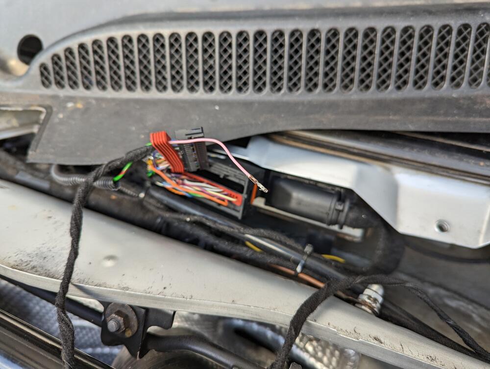

Not really sure what is generating this... its not the IMMO (the pick up ring on the ignition barrel) as pretty sure that would flash the cluster light... I have a feeling its something to do with the key lock that I don't have fitted (controlled using a wire from the selector to the wheel module and then to solenoid that's fitted to the ignition barrel on 8P and up auto's)... so I might reinstate that wire or perhaps try and recode the wheel module... not sure if I set the gearbox back to manual if it will be happy to still provide an output for the paddles... have to see...

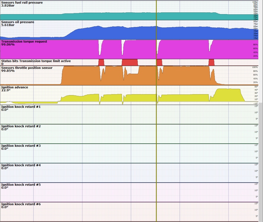

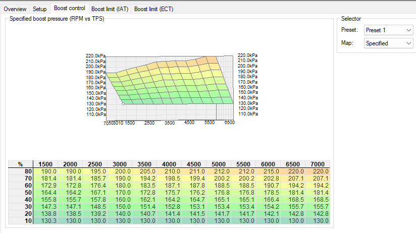

Thought I would at least try a bit of boost and see where the limits were... the box wasn't at all happy :) .... so dropped back down to gate pressure (0.5bar/7psi) and will run like that until the box is mapped...
Thats not to say that there is not anything to do in IECU as its a bit of a two way street... not only does the box need mapping but the ECU needs a bit of tweaking to be able to work with the TCU in "harmony"...

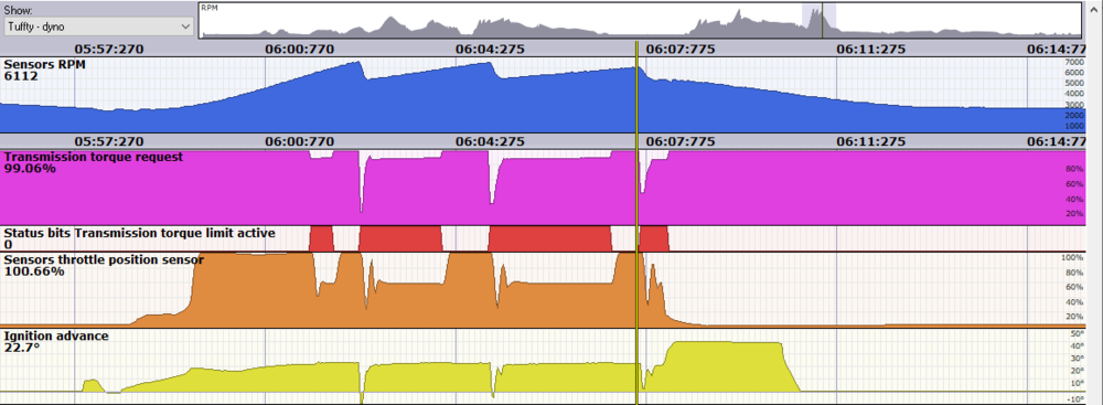

The clutches are not slipping (or at least not that I have noticed) but torque limits are being hit all the same...
This will limit the throttle plate to control 'load' and obviously means you are not getting full power potential... I have had a tweak about in the IECU map and improved the situation enough for now....
This will do until the box is sorted then I can fine tune things as needed...

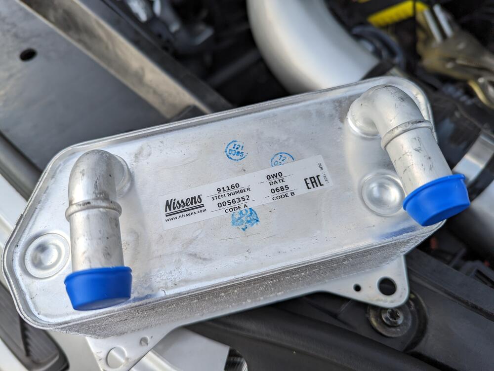

Popped out to the car to fit it and noticed the top of the box was wet... turned out to be gearbox oil... this could only have leaked from two places.. the oil filter housing or the oil cooler... the filter housing had a new o-ring and didn't look wet directly where it screwed in mount so my money was on the cooler and the generic o-rings I used...
Decided to replace everything (as you do) so ordered genuine o-rings and a replacement cooler...
This one is the larger version fitted to the early Mk1 TT DSG box....
More rows, more cooling maybe... who knows but a friend of mine fitted one to his track car so who knows :)
Was a little awkward to wiggle in but its all in and I just need to do the wiring to the ECU to be able to log the DSG oil temp...

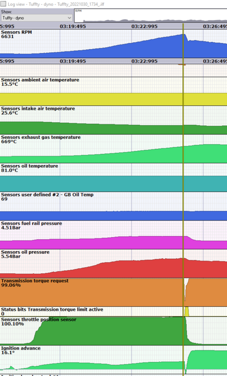

As the weather was decent this afternoon I popped out to wire up the DSG oil temp sensor
Used pin 26 on the ECU as this is spare for the input and earthed it to the distro panel I fitted previously for all the extra relays I had fitted
Double checked the VCDS label file for the definition of the temperatures in group 019 so I could see what temp I need to compare the reading from the sensor vs what the TCU is reading...

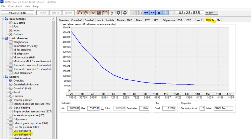

G93 trans fluid temp seems to be the sensible one to compare too to checked that on the colorMFA... was miles out!!... checked the measured resistance on the sensor input and at 20deg on G93 it was showing something like 48k ohms!... thats quite a bit different to 2031 ohms as suggested by the 'calibration' chart :(
So I guess I will have to sit about from a cold start taking measurements at 10deg intervals measured from group 019 on the colorMFA and read out the resistance values the input on pin 26 is seeing... joy :)
Joys of a cheap sensor....

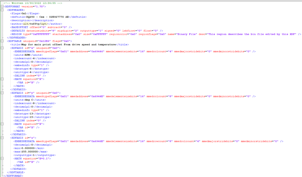

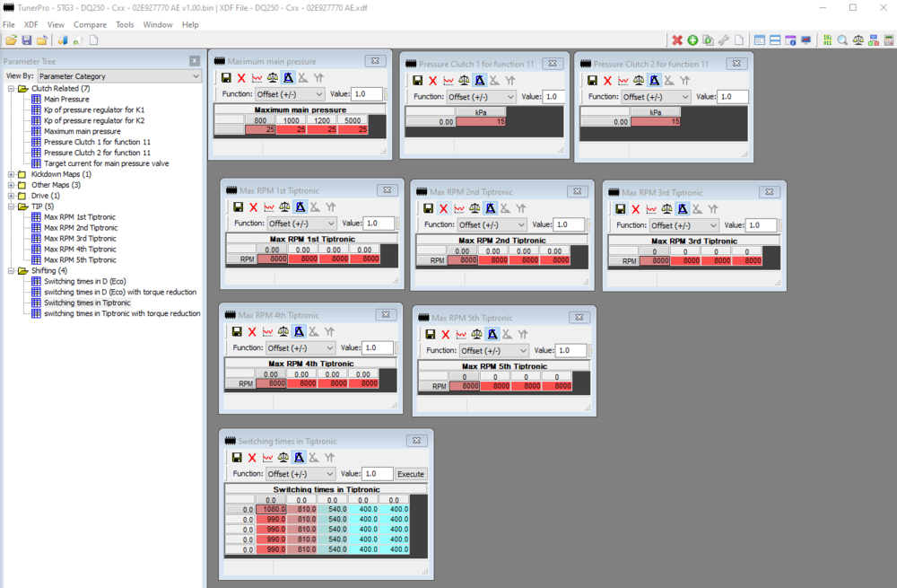

The gearbox is now mapped... I am also in the process of building up an XDF purely for shizzles and giggles so I can see if I can understand what the box is doing etc...
The XDF format is what Tuner Pro uses... this is fine and so far its going well... have added a few maps and everything tallies with OLS so far...
Whether or not I will do much more with it beyond keying in all the maps I don't know... having the map pack is one thing but I still need software to read/write and also checksum the files... will see what I can dig up as it would be nice to have the same level of control over my box map that I have over the engine map...
That said it is a pretty dumb version of the DSG TCU being the Cxx group TCU which is a blessing and a curse potentially... but its working fine so far and doing what I want it to... drives nicely poodling about in Drive and accelerating using TIP is epically addictive...

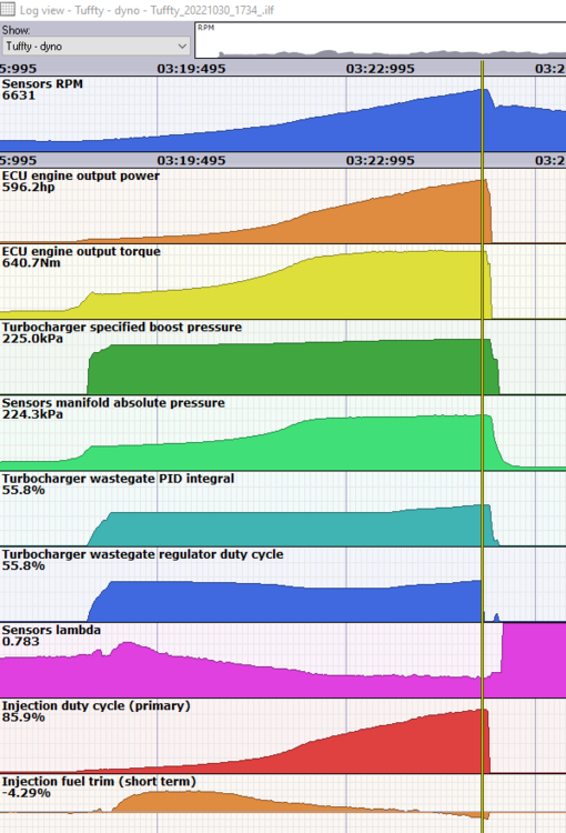

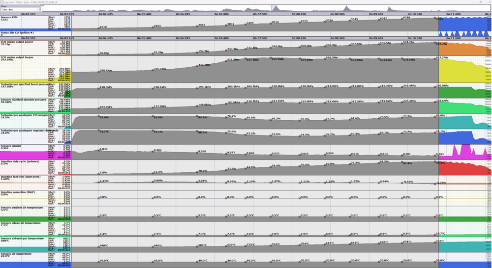

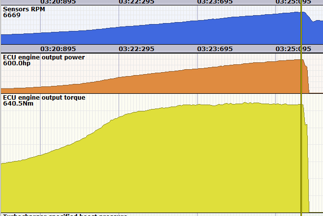

With the stronger gate spring I can lift the top end boost as I wanted to... this will potentially give me the headroom to keep the torque going a bit longer...

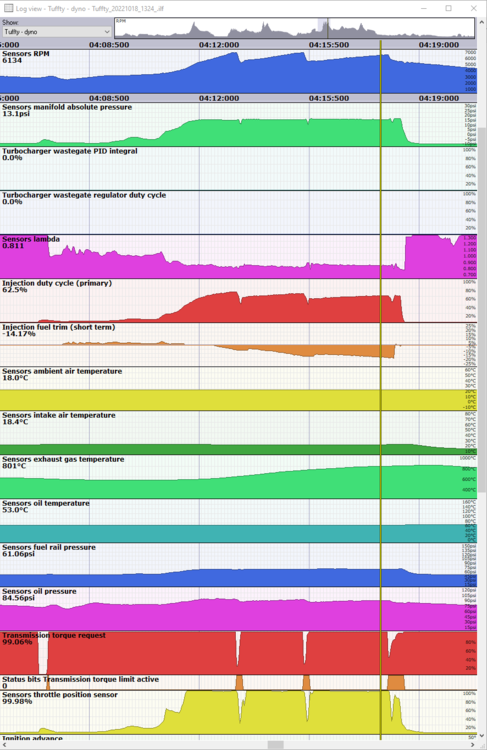

My last dyno plot on the 7psi spring running 17psi top end... I was pretty much out of duty at that point...  (85/90%)... peak torque is at 5k and drops off after... the gear changes off redline drop rpm to just over 5k so where the torque is dropping off... so I plan to address that...
Now I have hit 18psi at 55% duty so loads more headroom and have tweaked the mapping to try and lift the torque after 5k...
This of course is a rough estimation by the ECU so figures can be taken with a pinch of salt but generally speaking the shapes of the power/torque curves do follow the dyno plots... and this is looking quite flat now so hopefully it will work out like this on the dyno...
In other news... I have been (painfully) recalibrating the gearbox oil temp sensor...
Done a cold start and warmed the engine from idle logging and tweaking the map as the temp rises... its not perfect yet and hit a wall at around 60 deg as really the car needs to be driven to get more heat in... I may have to try and finish it off on the dyno or just give in and buy a more expensive and well documented sensor instead... (but where is the fun in that!! :) )
