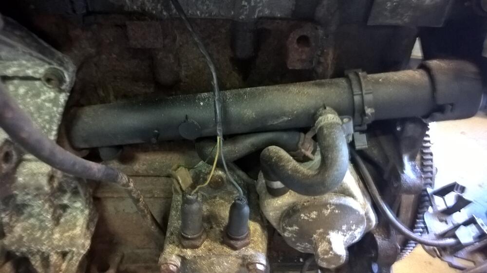

Just removed the oil cooler and noticed that the hoses were fitted the opposite to what is shown on VW parts catalogue and possibly the Bentley manual (not clear).
Can anyone confirm the correct orientation or whether it matters? The hose to the crackpipe was fitted on the left (from front) whereas on the parts diagram it was on the right

Thank you. Useful info. Just done the head gasket and got everything back together. Engine ran ok for around 10 mins and then developed a coolant leak in the oil cooler area (leaking faster when engine running). Have removed oil cooler and crackpipe but can't see anything obvious. Have got new crackpipe, hoses & cooler to fit and just hoping that will sort problem.
