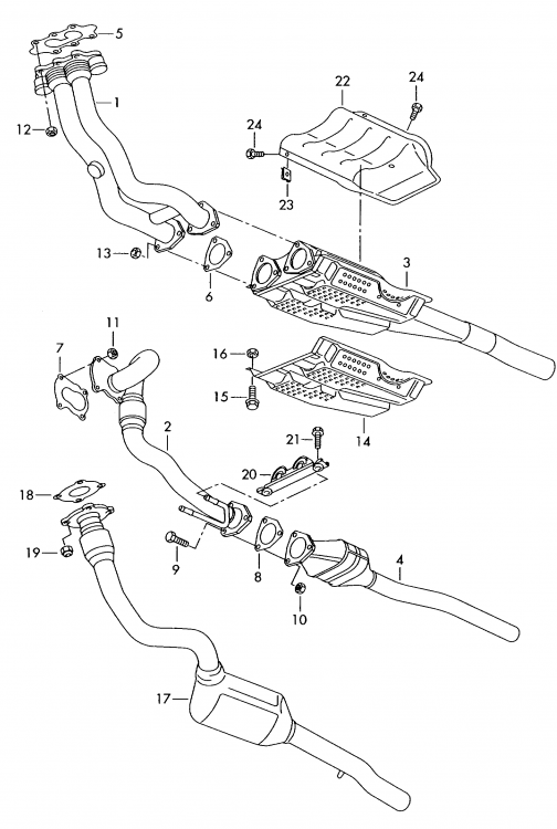

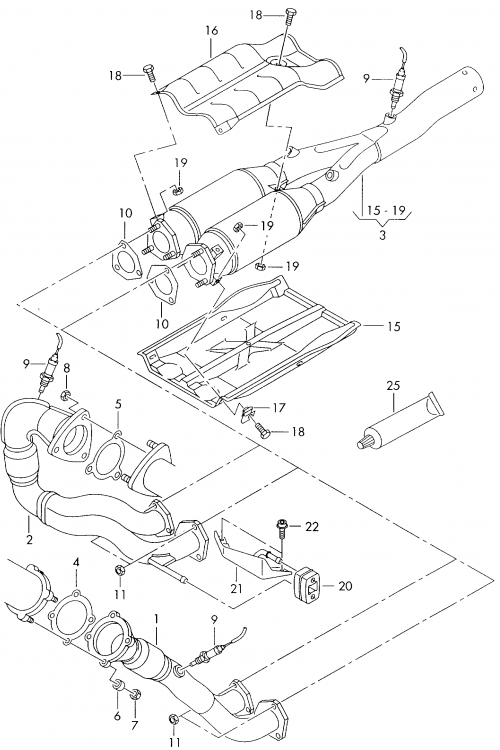

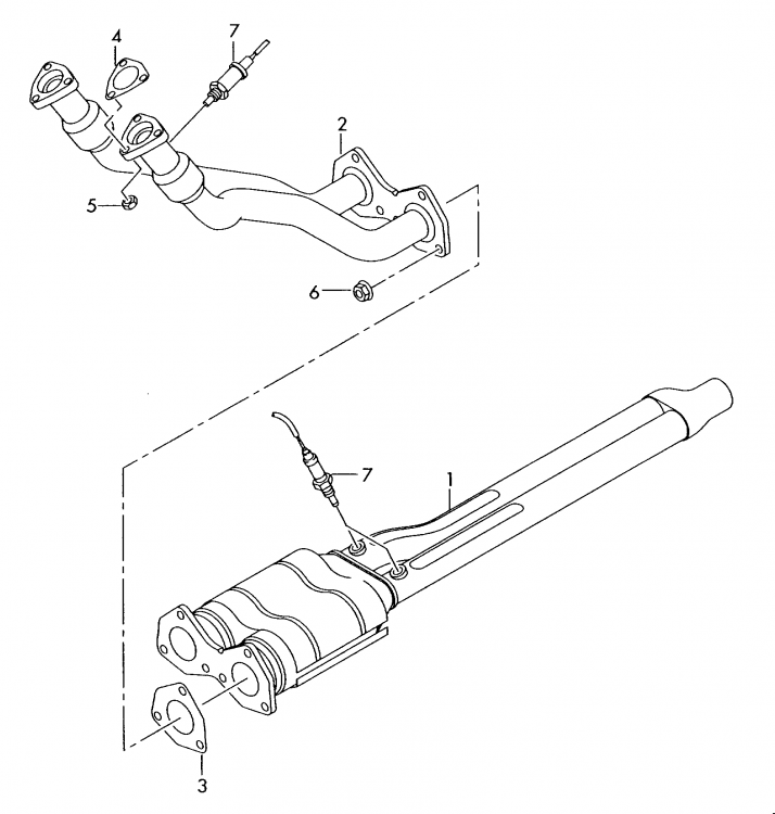

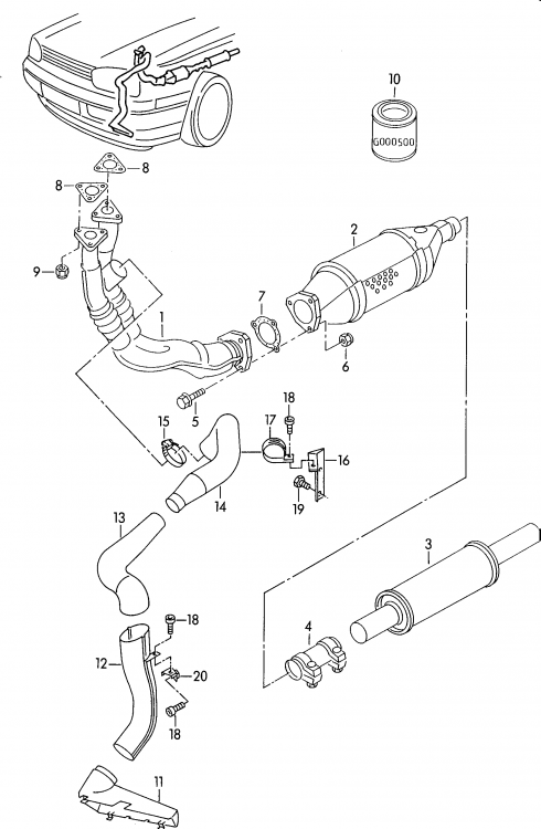

chalkyh 10 Posted May 12, 2020 Report Share Posted May 12, 2020 Hi, I've copied the parts listing images for you, VR6 twin downpipe, TT early single downpipe to twin cats, so it's a sort of opposite to what you need, so can't fit, and bolts up to a turbo. The 3.2 TT does have a twin downpipe to twin cats and centre pipe, so might fit? They must be similar to V6 4mo Golf IV although I don't think the pic shows the downpipe properly. There must be bits around from breaker V6TT to try . . . . Quote Link to post Share on other sites
