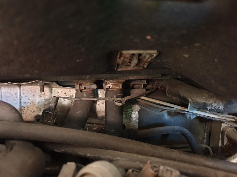

maghouse 0 Posted April 27, 2020 Report Share Posted April 27, 2020 Morning all, My trusty Sharan has sprung a leak after 23 years Water is pouring into the footwell & steamy windows etc - classic signs. Need to bypass the matrix for a while. Question I have is where are the inlet pipes in the bulkhead Are these 2 pipes the pipes to use ? Any other help would be much appreciated. Link to post Share on other sites
Dogma 41 Posted April 29, 2020 Report Share Posted April 29, 2020 The pipes you are looking for come out of the bulkhead right next to each other. Cant see very well but I think you have them in the second picture. maghouse 1 Link to post Share on other sites
maghouse 0 Posted April 29, 2020 Author Report Share Posted April 29, 2020 1 hour ago, Dogma said: The pipes you are looking for come out of the bulkhead right next to each other. Cant see very well but I think you have them in the second picture. Yep - right next to each other ! Thanks Link to post Share on other sites
