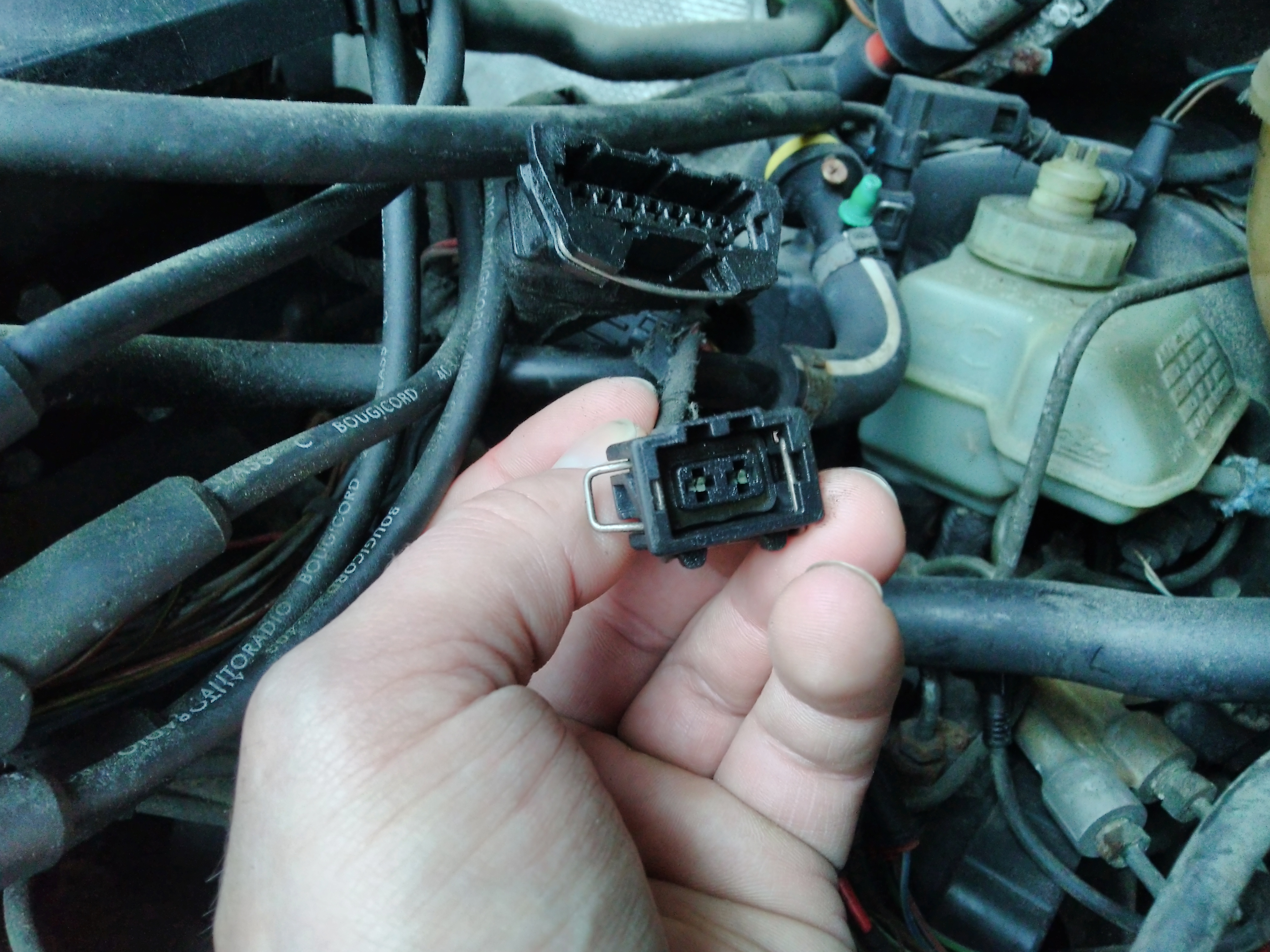

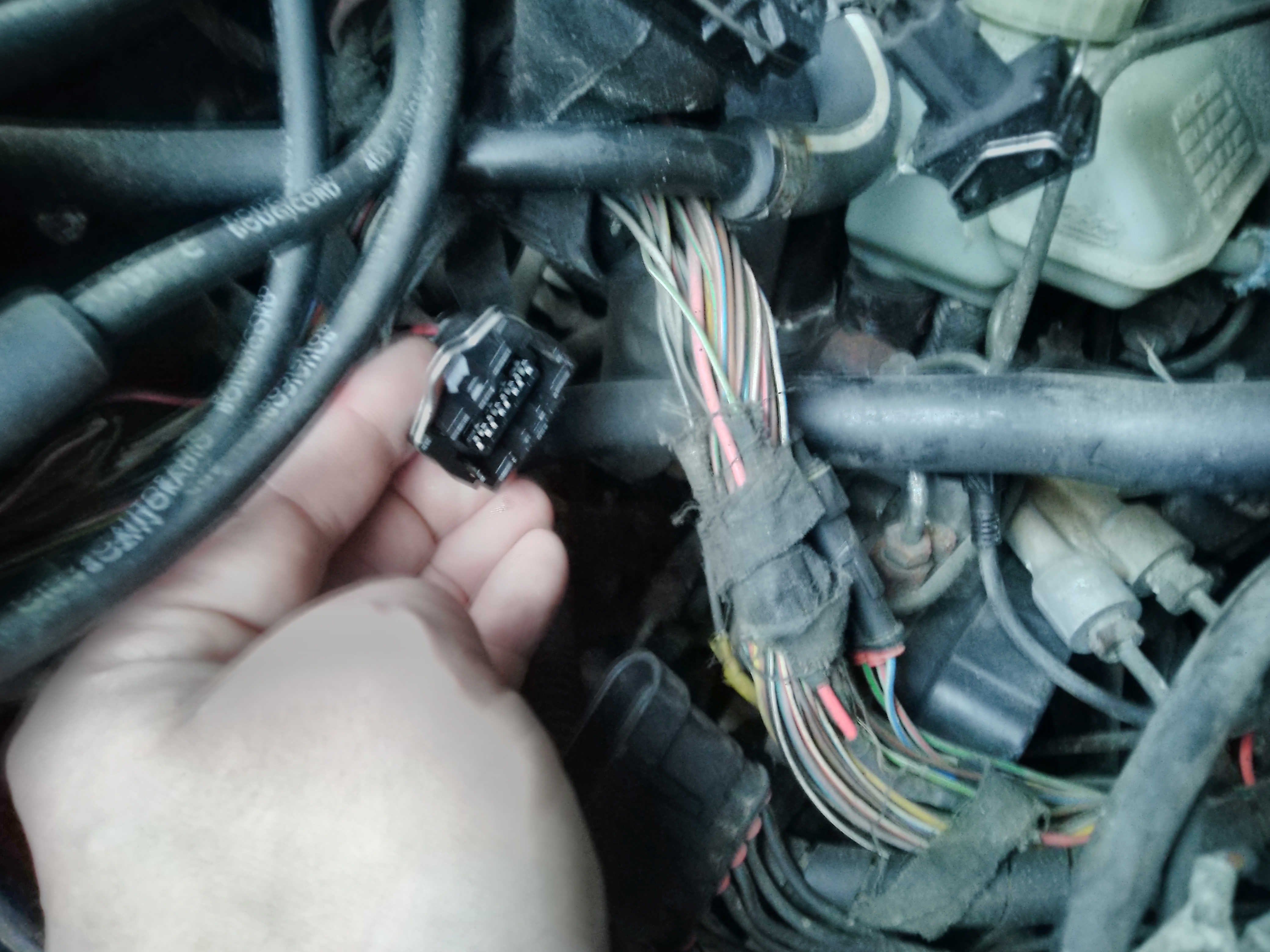

The small round connect (last photo) and purple centred plug  (second photo) look like they could be from an after-market alarm or something - it doesn't look factory VW.

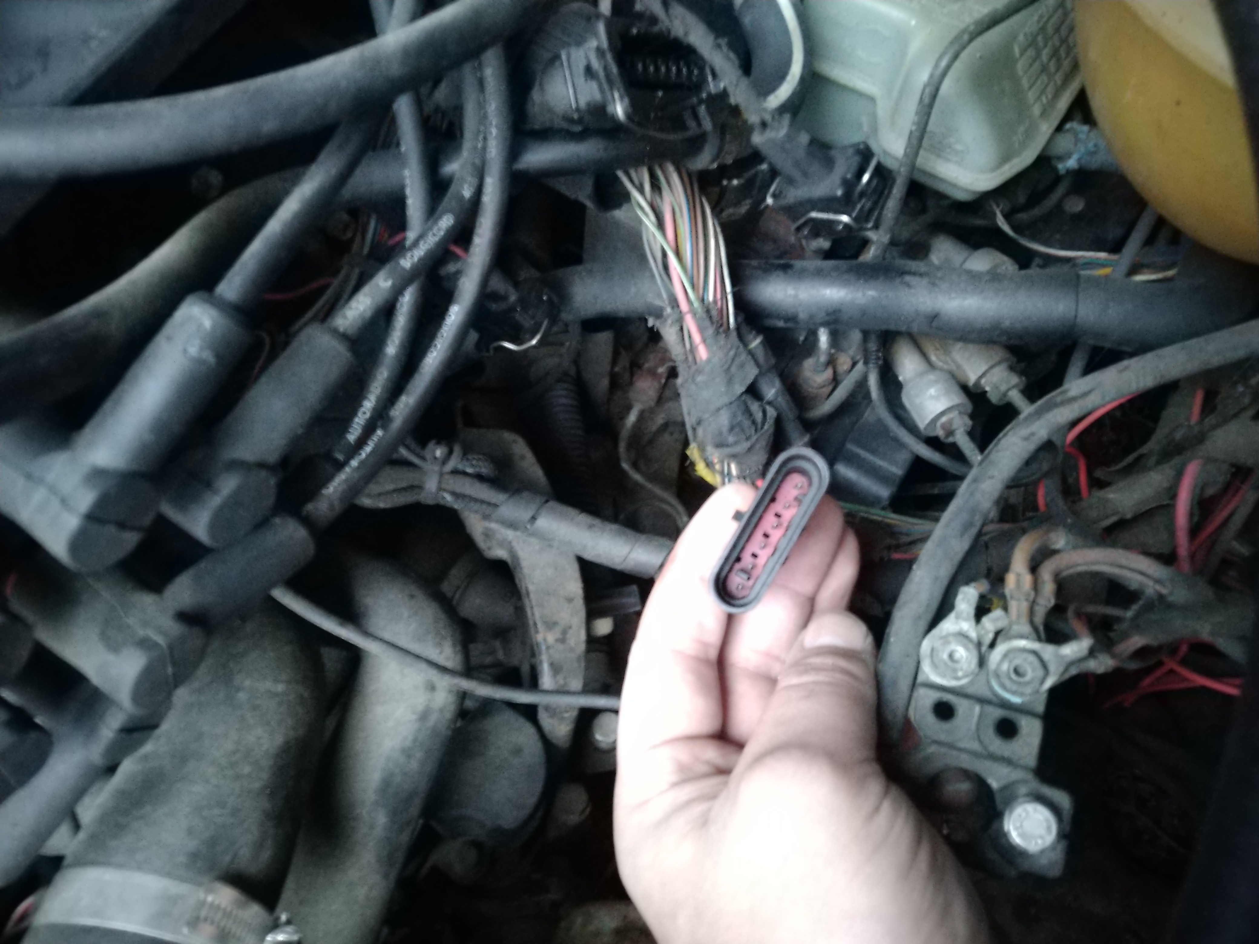

From memory - the only things around that area on the engine are:
  • Cam sender (three pin) next to rear cam wheel
  • Auxiliary water pump (on back or engine - under the large engine wiring connector)
  • Distributor/coilpack (coil pack uses a five pin connector, I've never seen the distributor version)

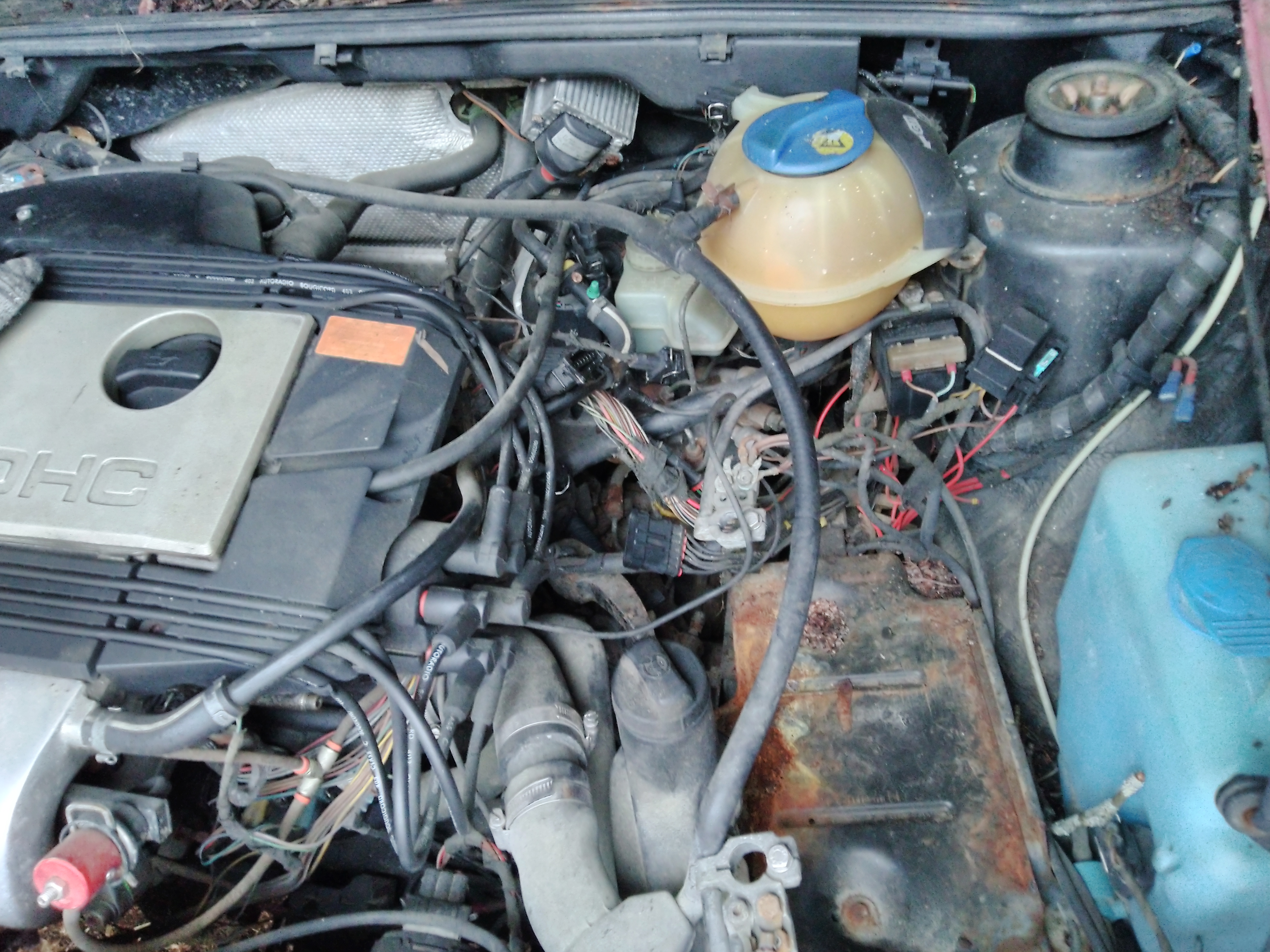

Remove the engine plastics and you will see a bit more...
