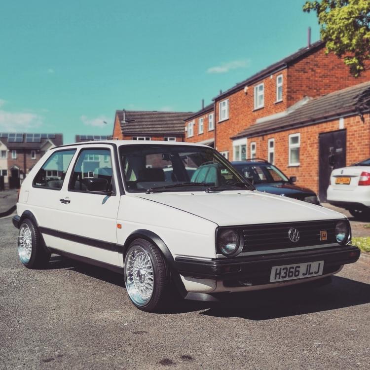

P. S here's a photo of my car we're talking about.
