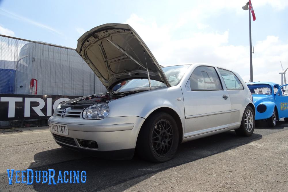

Quick update, had the car running with a 2.9 12v VR on a OBD2 ECU and took it racing at bugjam a couple of weeks ago. it was a stock engine with nitrous (80 shot) with a straight 2.25" exhaust out of the bumper and it went a best of 13.0 @100mph (with luke Stevenson driving....13.4 was my best) unfortunately just after a burnout it dropped onto 5 cylinders, i think i have burnt an exhaust valve as it is chuffing in the exhaust.  it was a rush to get it done but i managed it with a little help, i noticed that the subframe bushes need replacing as do the engine mounts, i will have a play this winter and see how it goes.
Dave the plan is for a drag car that i can use on track days if i want but will see how winter goes.

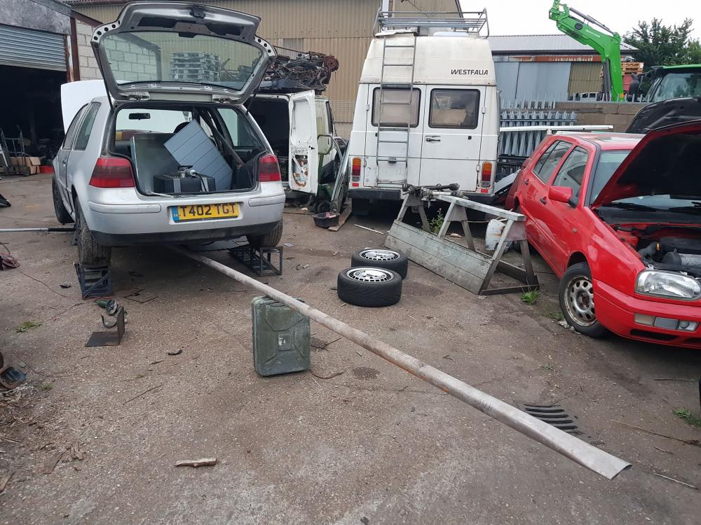

here are a couple of pics
