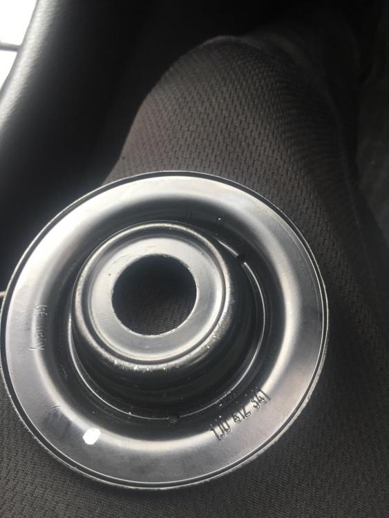

Looking for some help ... I'm changing over from coilovers to the H&R cup kit shocks and springs and the standard top plate slips through the springs.... has anyone come across a similar problem.??

Yes - its a little known fact that the top hats come in two different sizes, 90mm and 110mm.
From my experience, Eibach and later OEM springs require the 90mm one, whilst H&R need the 110mm one.

Thanks for the reply... got some help needed the plates from the older model vr6 managed to get some from OEM AND MORE.
