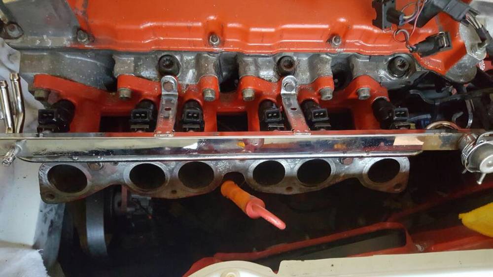

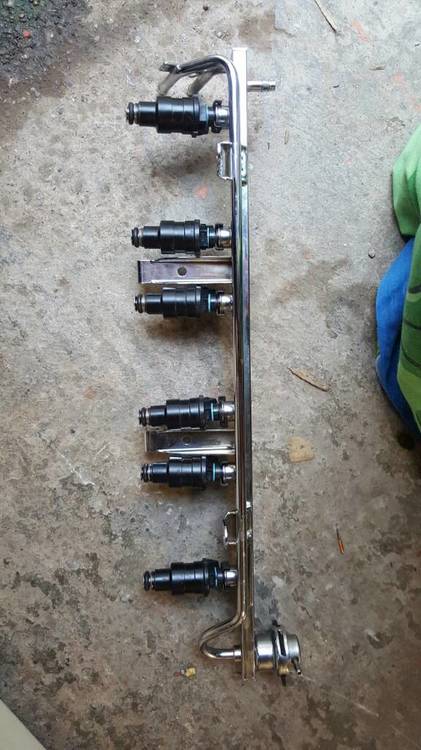

Fab up pipework replace my injectors.waiting on bearings for the drive pulley .i was going to be changing my fuel tank to a mk3 tank but im looking at replacing the fuel pump in accumulator box with a walbro or bosch if i can find out which one would fit the mk2 accumulator box

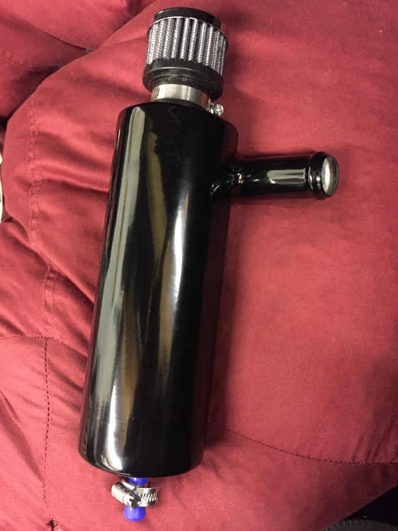

Crankcase breather im not keen on putting it before the charger (obviously it has to go there) im not wanting any spatters of oil going through the charger plus makes my pipework easier so any recommendations what to do with it?filter or catch tank? Cheers

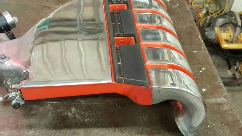

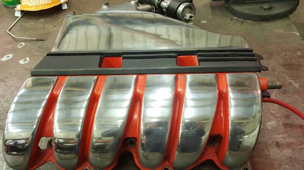

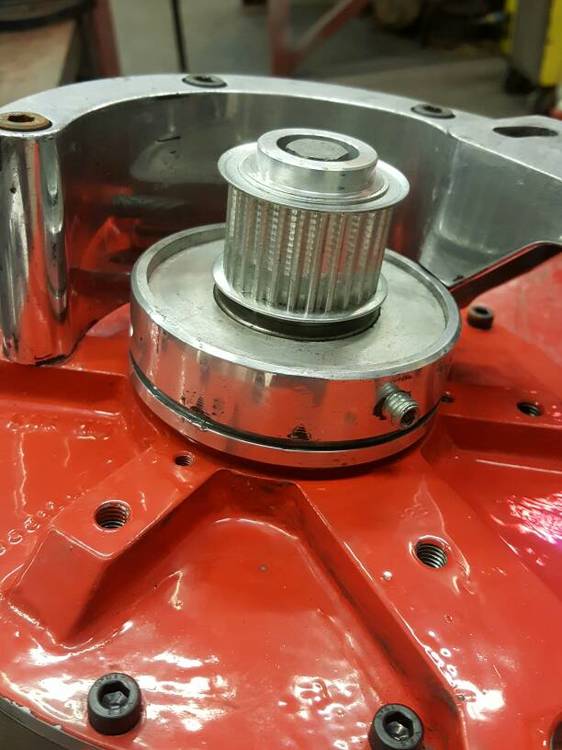

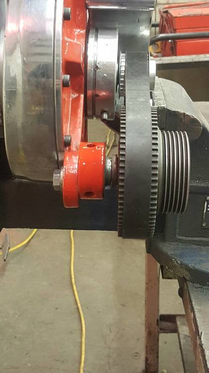

Bit of grafting came up not bad.hopefully have the bits bolted on this weekjust fabricating a pulley in place of aircon pump to save having a big bulky pump only to be used as an idler

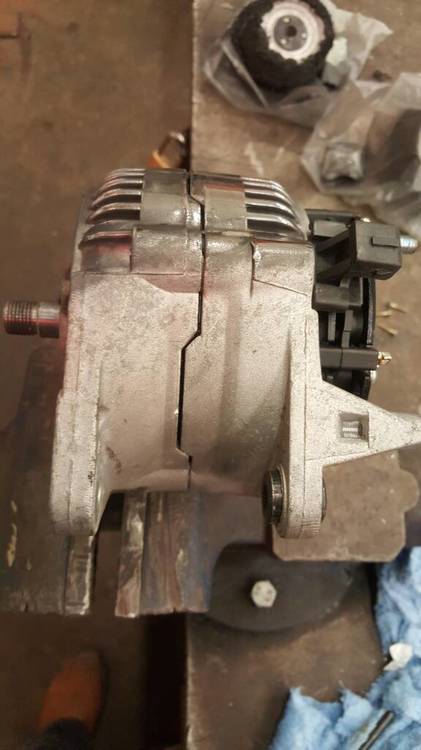

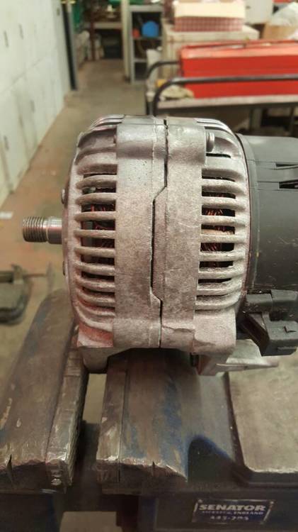

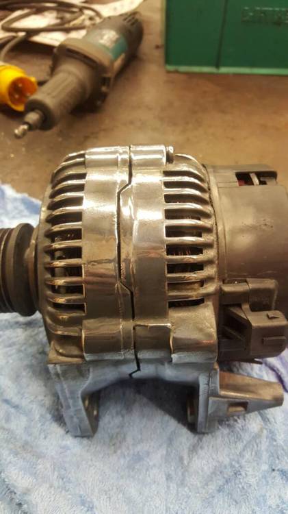

Nice mate. Hope it's new. Within a month or having my charger bolted up the bearing failed in my alternator due to tension, would have to see your hard work going to waste.
I went down the catch can route that vented to air, I retained PCV also. if you look at my build thread, you should see it there
Any recommendations for a catch can?too much out there to choose from
