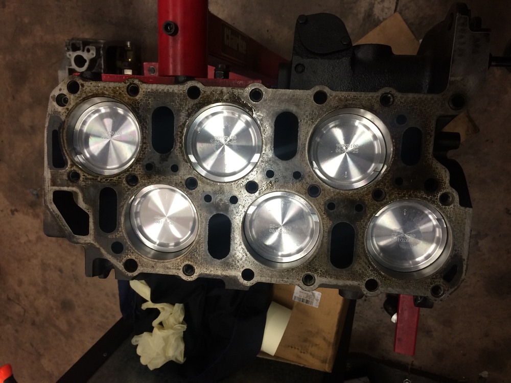

fla 0 Posted August 27, 2016 Report Share Posted August 27, 2016 Forged pistons - very nice Link to post Share on other sites
J4Y VR 36 Posted August 27, 2016 Author Report Share Posted August 27, 2016 Forged pistons - very nice There's more pictures on my Instagram account.J4ymiah Link to post Share on other sites
