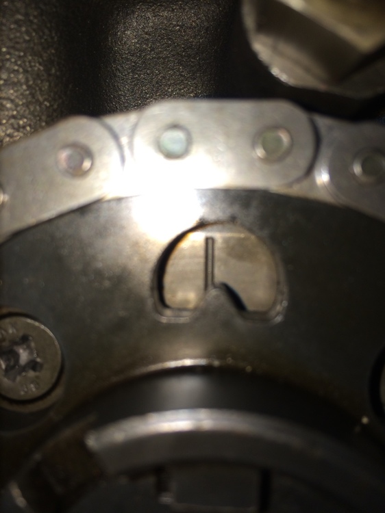

JakeP 53 Posted August 18, 2016 Author Report Share Posted August 18, 2016 Right I need a bit of advice , I've timed the bottom half of the engine as the head is not ready , piston 1 is at tdc and the ground tooth opposite the main cap split , but I couldn't seem to get the intermediate shady sprocket bang on , it's about 1mm right of the guide mark behind the sprocket is that anything to worry about or do I have to re do it ? Link to post Share on other sites
JakeP 53 Posted August 19, 2016 Author Report Share Posted August 19, 2016 I've been trying for ages re adjusting it , I've turned over the engine a few times and put it back to tdc yet still can only get it like this Link to post Share on other sites
JakeP 53 Posted August 23, 2016 Author Report Share Posted August 23, 2016 Any help guys ? Link to post Share on other sites
JakeP 53 Posted August 30, 2016 Author Report Share Posted August 30, 2016 anyone :(? Link to post Share on other sites

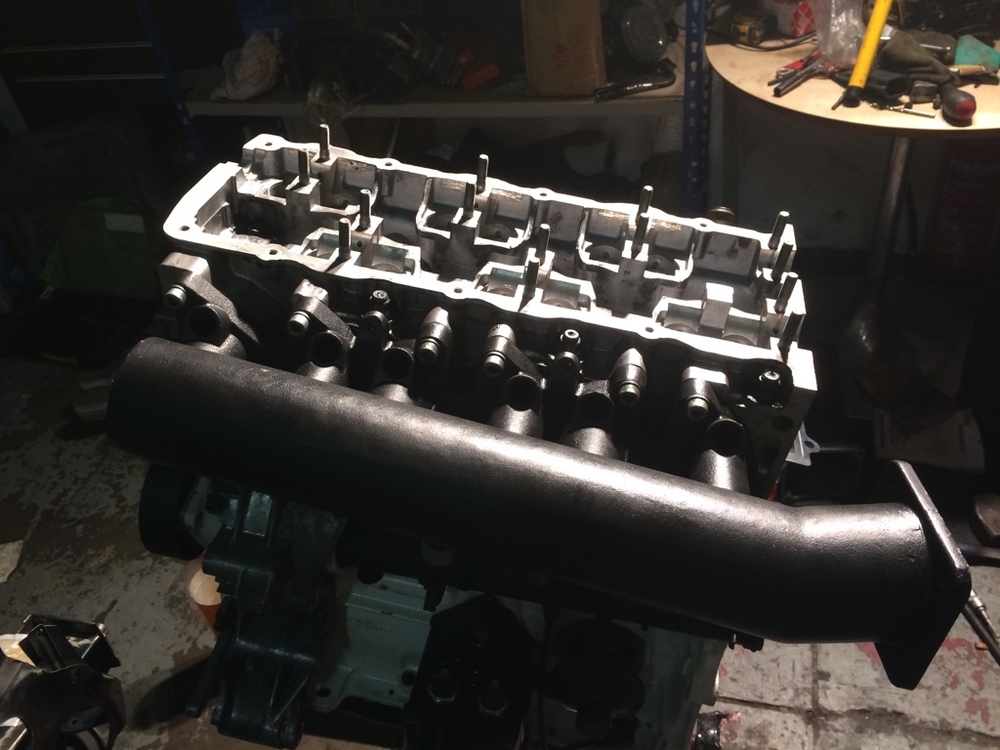

JakeP 53 Posted September 2, 2016 Author Report Share Posted September 2, 2016 Getting a little bit further with the build , got my head back from the machine shop with 1.8mm bigger inconel exhaust valves and supertech intake valves with new guides , stem seals , HD Valve springs and titanium retainers, also got the head skimmed , hot tanked and pressure tested. Put the mk4 MLS headgasket with the ARP head studs on and the SRI on brans 1 Link to post Share on other sites

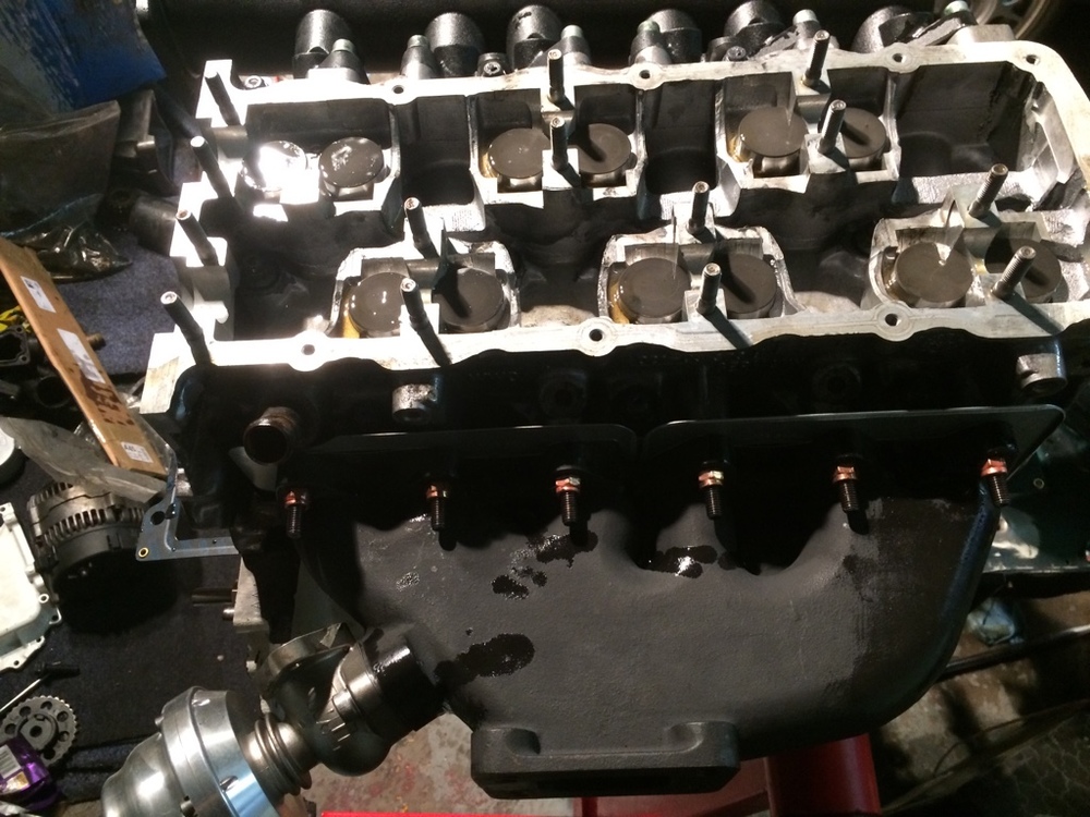

JakeP 53 Posted September 4, 2016 Author Report Share Posted September 4, 2016 Got the exhaust manifold on and lifters in Now for the Schimmel 263 cams Link to post Share on other sites

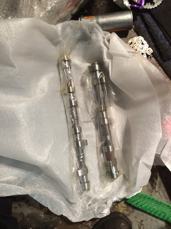

JakeP 53 Posted September 5, 2016 Author Report Share Posted September 5, 2016 Schimmel cams in , just waiting for my cam lock tool and my cam bolts to arrive and I can time it all up Link to post Share on other sites
