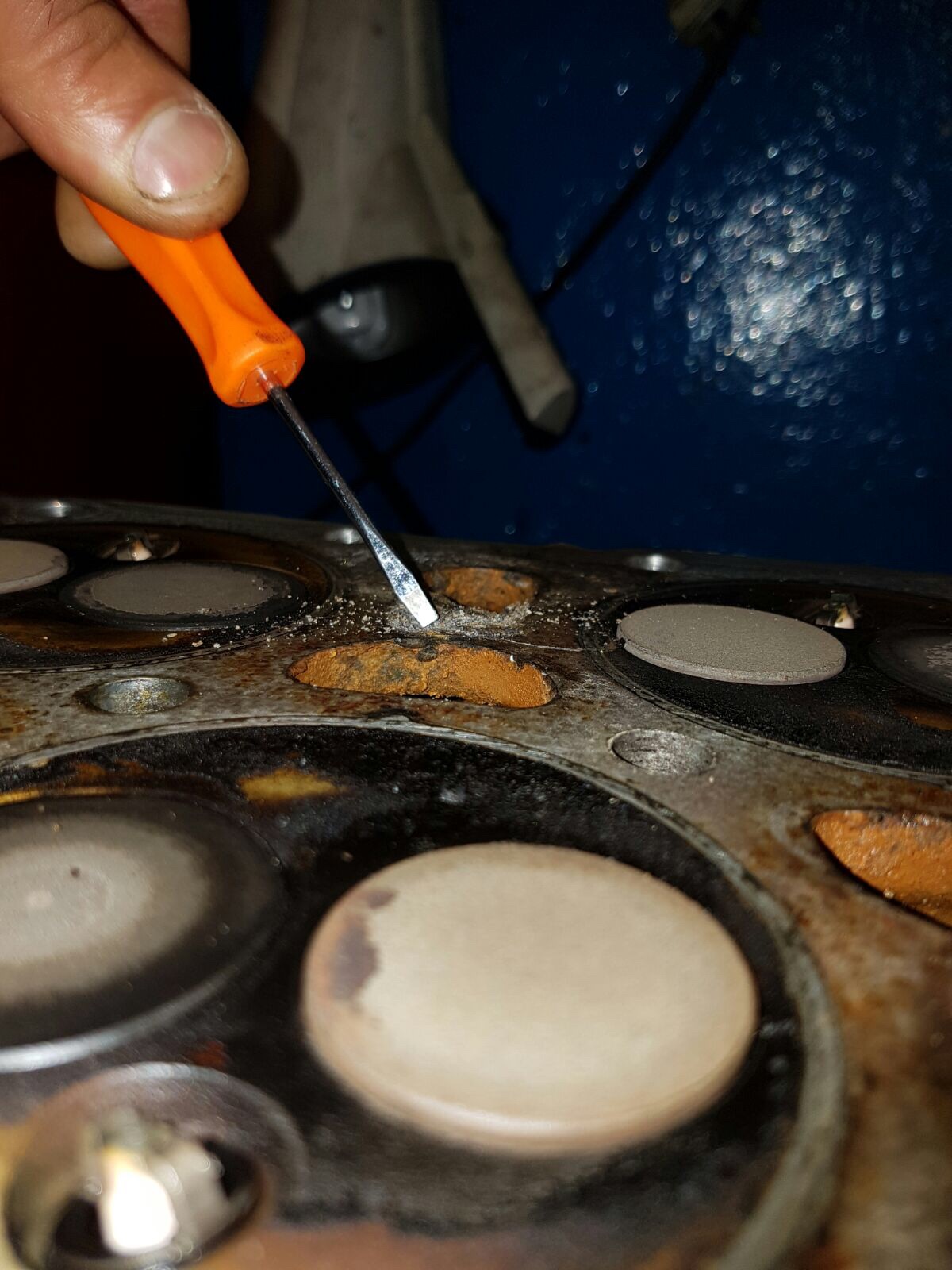

So I haven't posted on here in a while , she's been great untill recently when found out She had a head gasket prob , then it's just been one thing after another :(
Decided to go the whole hog and do timing chain , head gasket , stem seals , new clutch and replace all bottom end seals while I was at it , bills come in quite high and turns out I need a new head too due to negligence of previous owner , so she currently looks like this

Have you pressure tested the head? To see if it can be saved? Only asking as I do this for a living and I'm in process of buying a vr6 engine to rebuild for my project cabby. If the head is good you might be able to clean the valves and seats relap them and vacuum them see if you get a good reading
Garage did a series of tests and measurements on it and it's previously been skimmed and built up / what not and apparently it can't be done again as there's not enough on there to work with ?

Yeah has to just swallow it and pay for a new one as they said old one was already skimmed and they refused to work on it again so didn't really have a choice , though apparently it now runs a higher compression ? And it's drinking fuel like a ...mf :/ even more than it did before it went in , but yeah she's sorted with the new head ,new timing chain kit , all new gaskets , bolts , uprated plugs , service, new thermostat and housing , clutch and ht leads and running a beaut :) and very thirsty beaut but still a beaut lol :) so much smoother now :)
